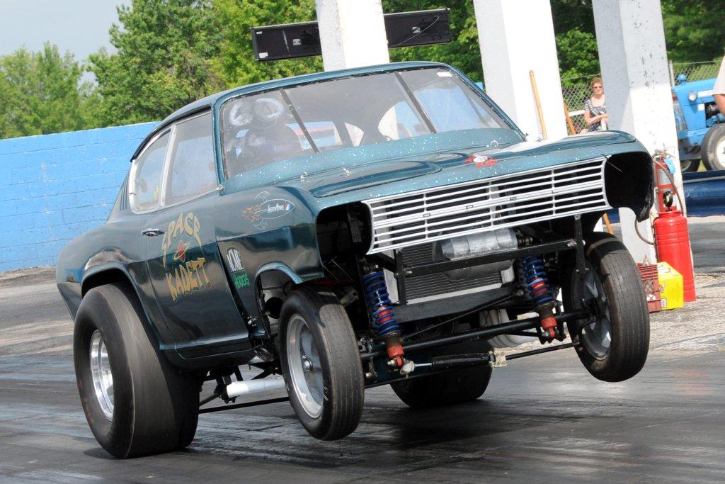

  1. here's a couple of my cars. the 72 has leaf springs and 60's 1.34. the 92 is a 4 link car and 60's 1.20. PM me for some suggestions that I've tried

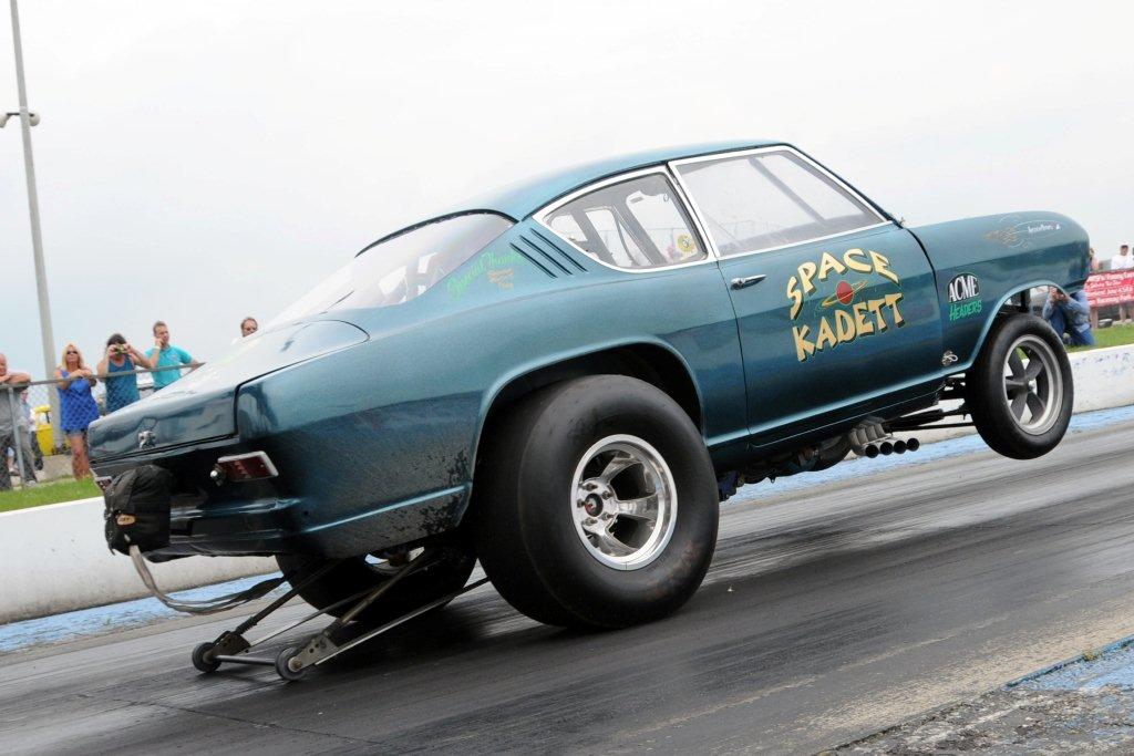

    ok i got a question for the guys that run wheelie bars.when i look at some video of my car leaveing the line,the wheelie bars would touch before the front tires would come off the ground.now that i have made it i true ladderbar set up and put the anti-roll bar in it.how high should i set the w.bars off the ground?i had them at fist height when i first built the car and now they are at 5.5''p*** side and 5''driverside.

    all i can say is the anti-roll bar worked!!!the guys at thompson did a great job prepping the track and the opel left straight as an arrow.i did raise the wheelie bars up as high as they would go{on the last adjustment}when i go to norwalk im going to move it up one hole and raise it up just alittle more.with everything working so good i dont think im going to put the floaters on it next year though.

    What is your reasoning for raising the wheelie bars ? If you're not being slammed back down when the bars contact the track and your movement is forward, I'd think you're good at the height they are now.
  29. american opel
    Joined: Dec 14, 2006
    Posts: 1,222
    american opel
    from ohio
    because its a blast!!!!i cant describe how cool the feeling is when all you see is the sky.i dont want to go too high for fear of braking something when it comes down but as of now it sets down soft.i dont plan on cranking them up too high but acouple of more inches couldnt hurt!

    just a couple of pics. from norwalk g***er reunion.man was that track sticky.F/G winner.other pic. is dons car going on one wheel.i guess im not going to change the rear to floaters!!!!
