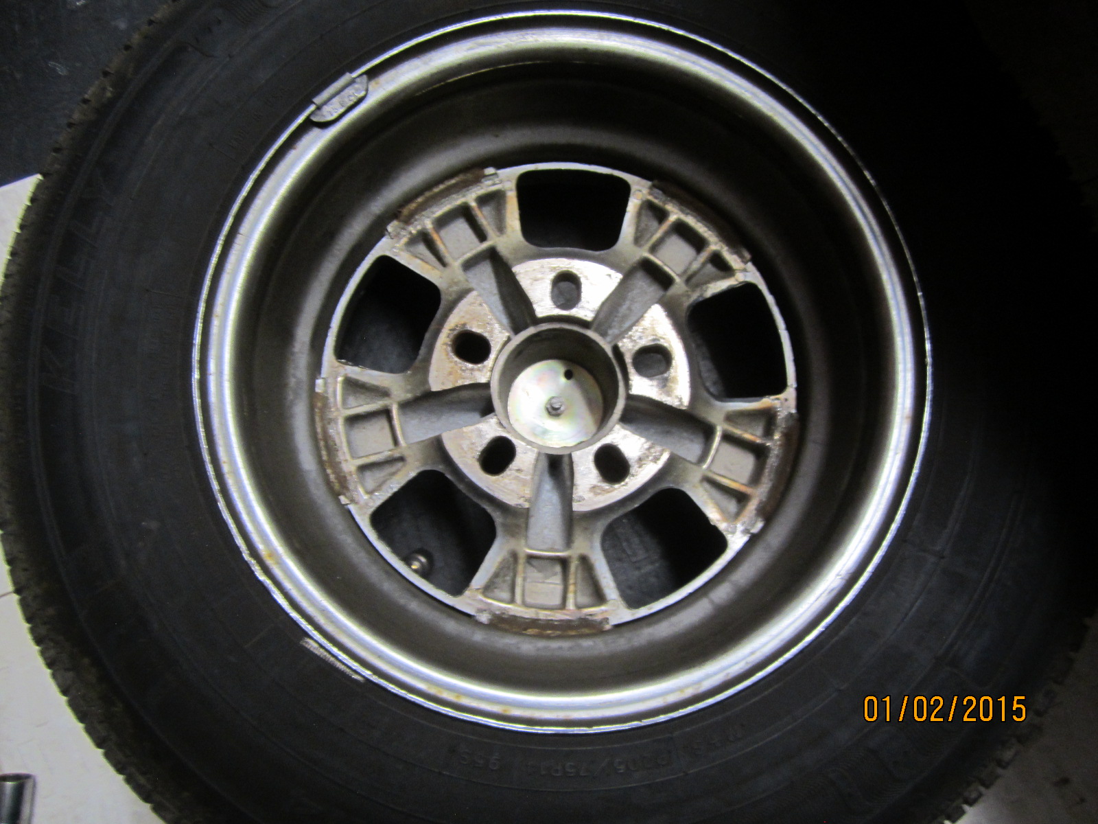

    Hello all. Ive got a 1955 ford and looking at a disc brake kit for the front. They tell me that my 14 inch mag type wheels wont fit. I need disc brake wheels. I didnt know that there were two different sises of 14 inch wheels. Is there a kit with rotors and calipers that will work?? OR am I just stuck with changing wheels and tires, to make any of the kits work. Does anyone know what that disc brake wheel measures on the inside (ID) I'll go measure what Ive got now.

    it's not the ID so much as the shape of the rim. The disc rake wheels are designed to clear the caliper. If you look at your wheels, you can see if they're the older drum brake design, or the newer disc brake design.
    Many 14" wheels will fit disc brakes, but you need to do your homework first. If the brakes were designed for 14" wheels, and the wheels are too, then they'll fit. If not, then it won't work

    found some pics of a couple 14" wheels, first one is for drum brakes, second is for disc brakes.

    OK these wheels i have are probably not for disc brakes. The caliper area is tapered not squared off like your wheel looks like. If you make my pictures full screen you can see it OK.
    Well POOO. Didn't really want to have to get wheels and tires to do this.
    I think most of the kits are using Granada style calipers. i'm thinking there really a heavy casting (caliper) so does anyone know if we can take some meat off the outside of the caliper and make it work??

    looks to me like it's a disc brake wheel, also.

    OK might be beating an old horse here but just to make sure what Ive got what everyone is saying. !! . On my wheel picture, the flat area where the balance weight is. Right where it makes the 90degree turn down into the wheel, that dimension (ID) to the other side is 13 5/8. At the bottom there (clear down by the flat area where wheel bolts up to rotor, the (ID) is 13 1/8. So from what i'm seeing here should work. I bet if it touches at all we can grind meat off the outside of the caliper and we will be good to go.???
    Everyone think this is a thumbs up. ???

    Thats pretty much what I went out and measured as per my post, looks good to me..Maybe just need a 1/4 spacer, maybe not..I give them wheels a thumbs up...

    should not need any grinding, if the brakes were originally designed for a 14" wheel (which most small and mid size and muscle car brakes were).
    The drum brake wheels will measure about 12" ID and won't fit over the calipers.
    If you can take a picture of the wheel from the same angle as those two wheels I showed above, you should be able to see the issue more clearly.
