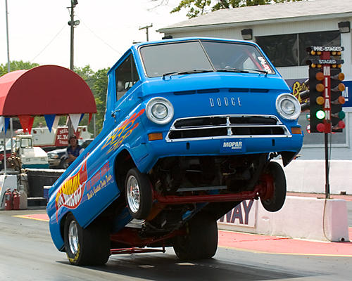

  8. melsfine39
    Joined: Apr 24, 2009
    Posts: 235
    melsfine39

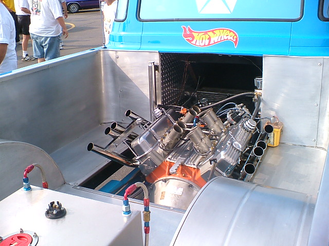

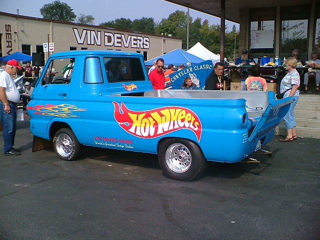

    Here's my friend Art's HOTWHEELS Dodge A100 wheelstander. Built much like the Little Red Wagon,the photos show it running a injected 440 Chrysler. He installed a 8-71 blower after these pictures were taken. The photo doing the wheelstand is at Milan Dragway during the taping of PINKS for the speed channel. He didn't race just made a run. Way Cool truck!! Mel:D

  9. radical flyer
    Joined: Jan 9, 2011
    Posts: 25
    radical flyer
    can you get some pictures of the frame and motor mounts?
    i saw it on pinks very cleah a100.thanks wes

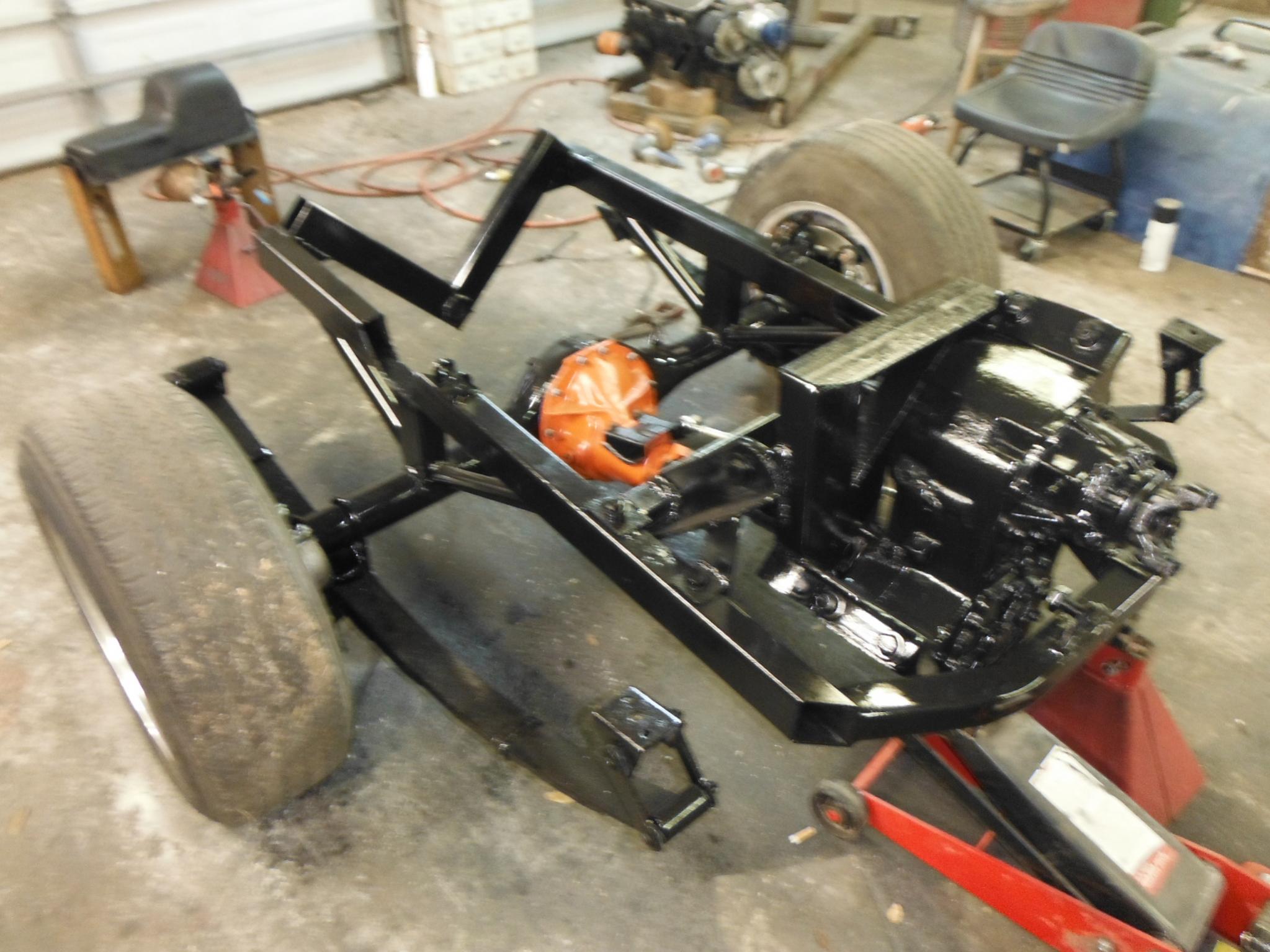

    Im building something similiar out of a 65 Econoline Van. This is a pic of the Little Red Wagons removable subrame, but is not suspended. I plan on building a similiar subframe but it will be suspended with heim joints in the front making a big swing arm. Have you started on yours yet?

    nice the lrw had suspended in the later years i guess this system didnt wor and was crashed.im going to mount the swing arm were the motor mounts were at on the frame 24"wide sub frame with axle floaters turned upside down from the stock rear leaf spings and solid mounted on the subframe along with the motor and trans.

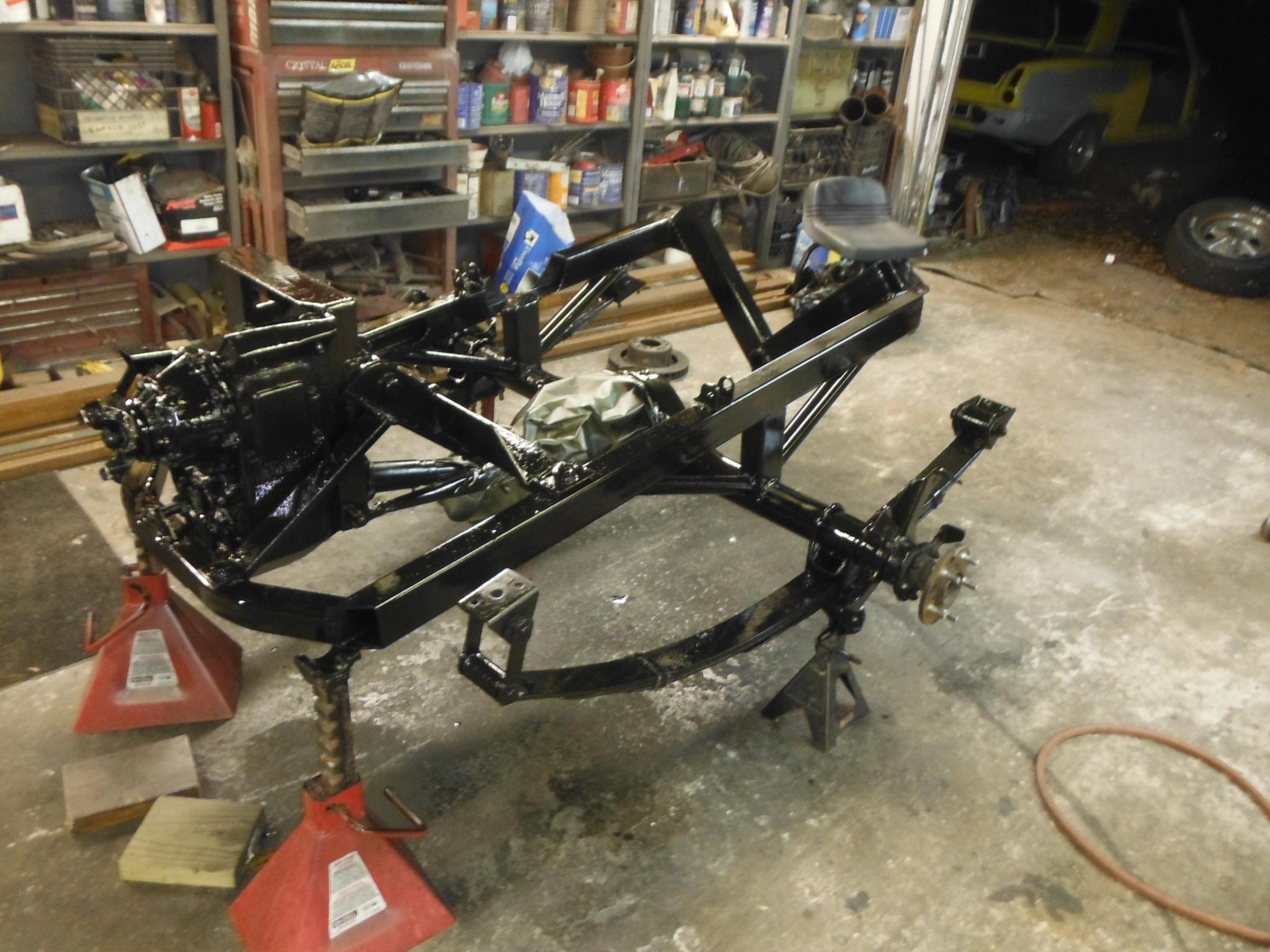

  12. Waggin
    Joined: Nov 29, 2012
    Posts: 7
    Waggin
    from florida

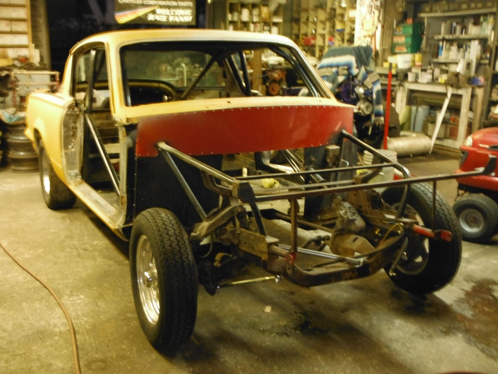

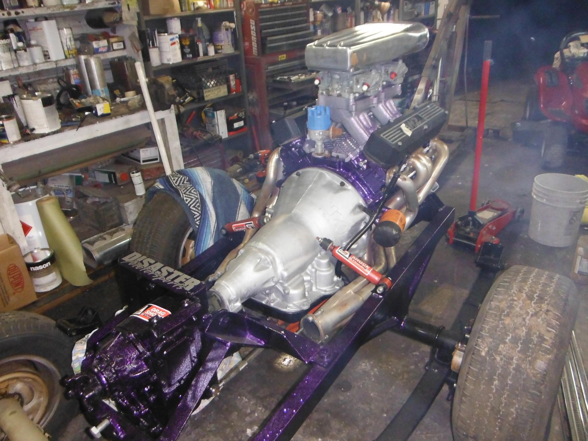

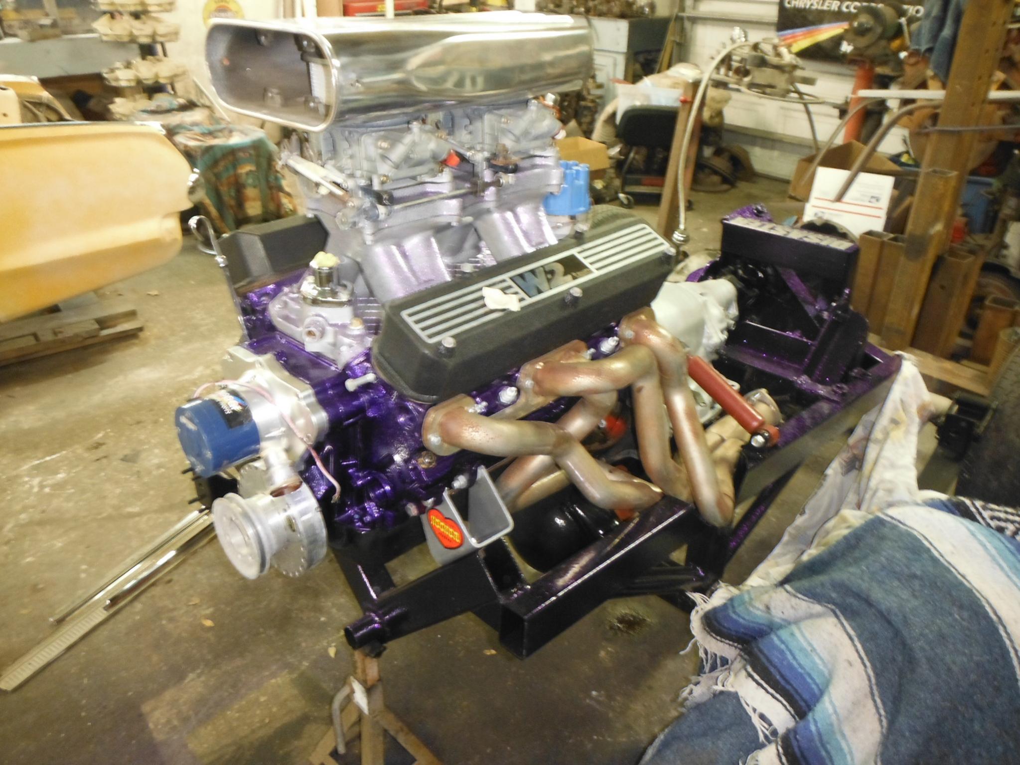

    Found this website lookin for more wheelstanders for some motivation heres a few pics of mine it takes advantage of the super stock springs and uses a pillow block at the front axis of the spring front mount axis for suspension freedom, the car launches nice and straight, it's all apart for finishing and paint work now it's a 65 barracuda formulas s that was too rusty for restoration but I didn't have the heart to send her to the scrapyard, it's now powered by a W-2 headed 340 with tunnel ram and dual 660 center squirters, msd ignition, W-2 a body headers hooked to a shorty 727 with 4500 stall, deep pan and reverse manual valve body, the rear end is an 8 3/4 with 3:23 gears and a power lok (clutch type) carrier sure grip is the cone type. the trans carries the power straight to a 205 divorced transfer case from a dodge truck then to the rear, brakes are handled by speedway motors rotors and hats then weld on caliper mounts using gm calipers two per wheel one set being used for foot brake and the others for the left and right steering brake thru wilwood master cylinders
