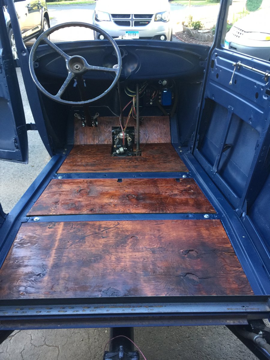

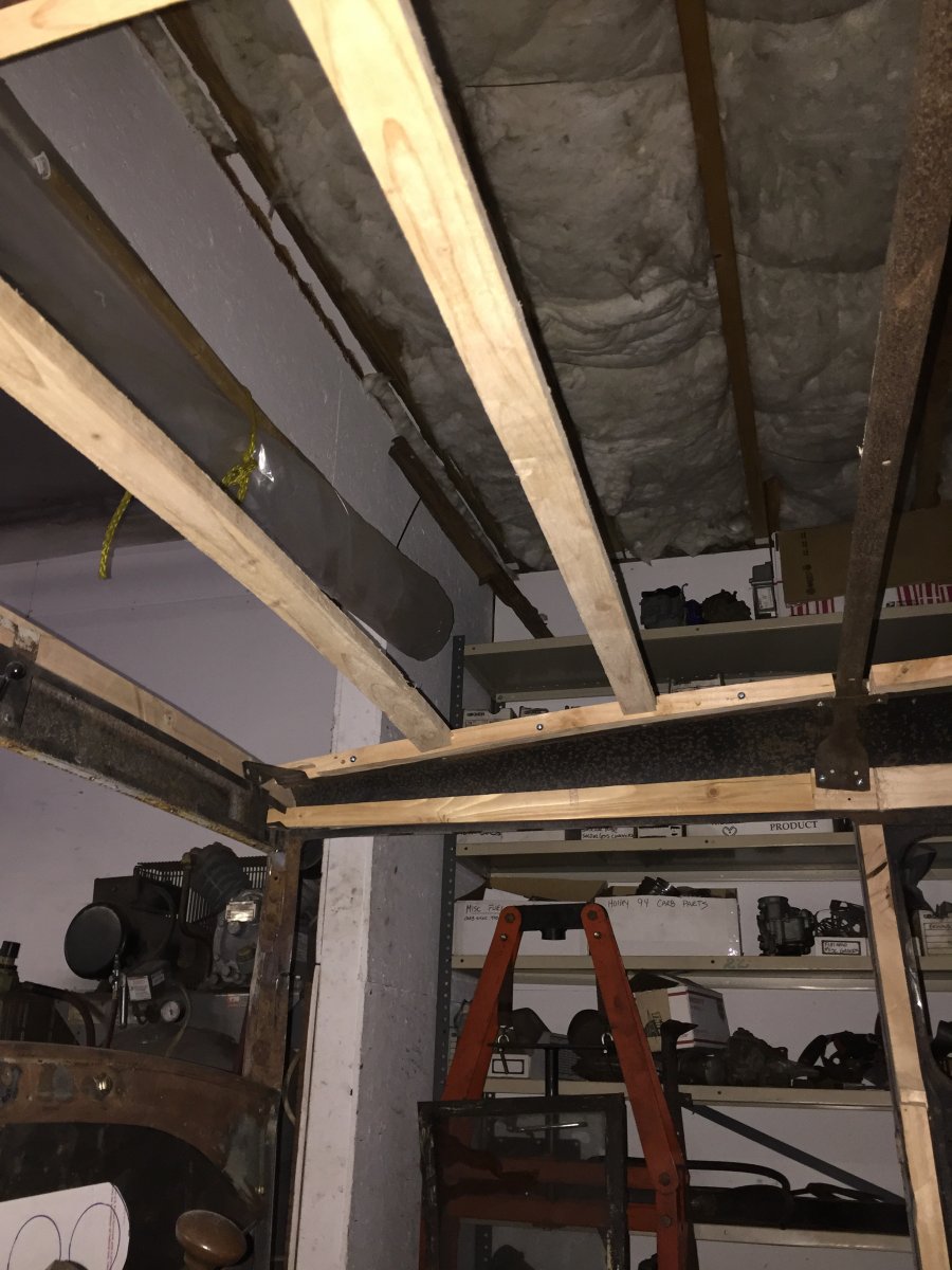

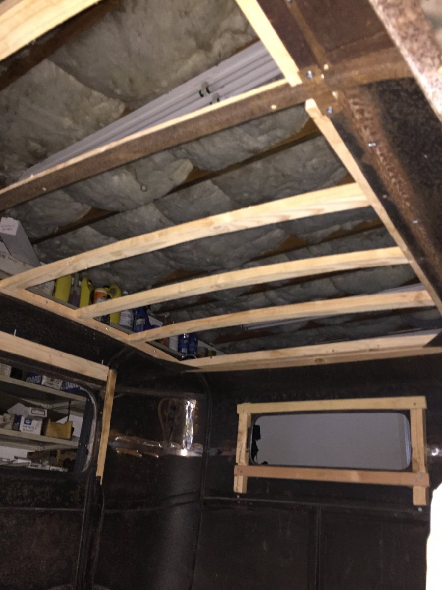

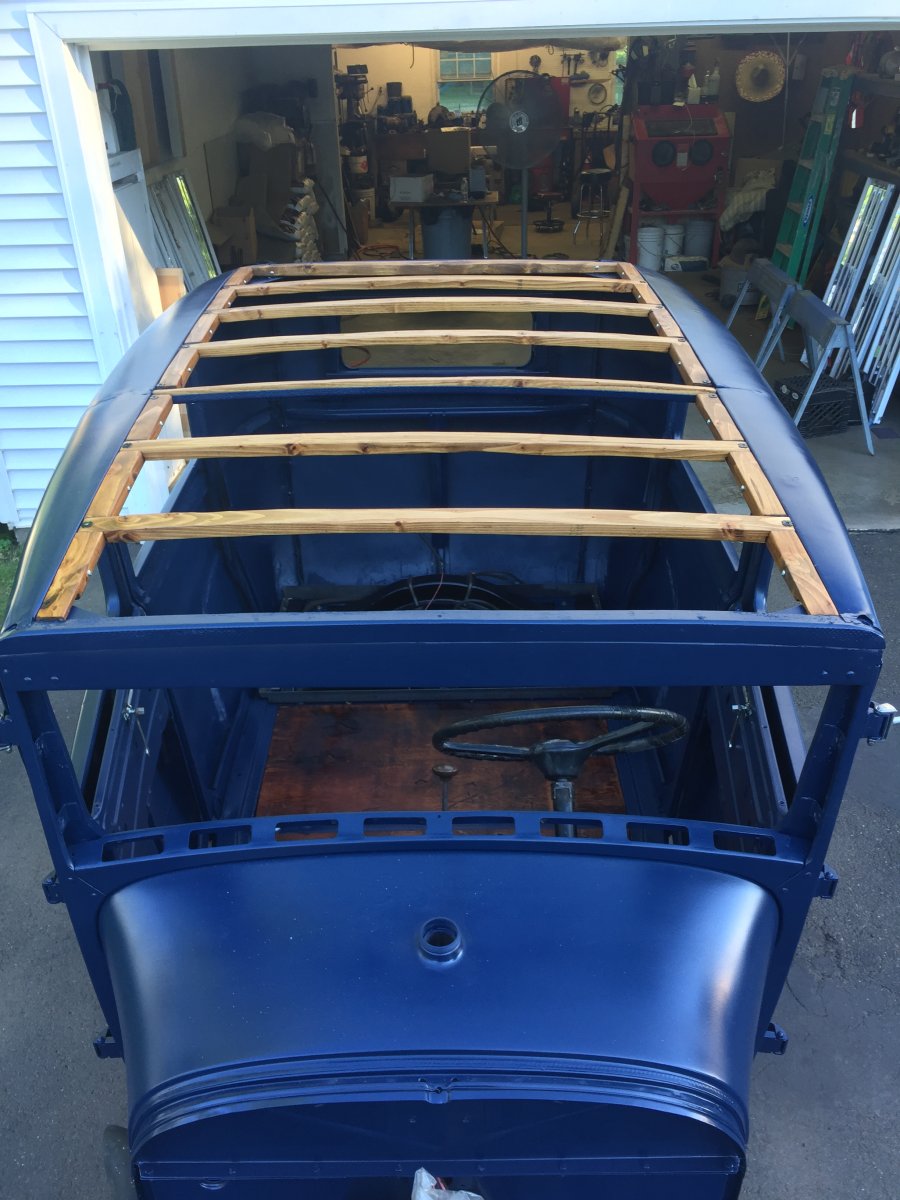

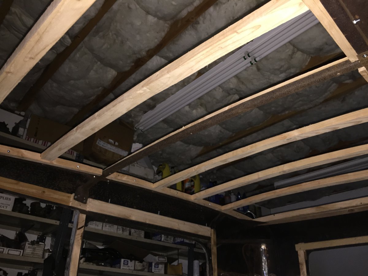

  12. Cliff Ramsdell
    Joined: Dec 27, 2004
    Posts: 1,380
    Cliff Ramsdell
    I couldn’t see paying the money for the body, floor and top wood kits for my Tudor.
    Made my own, wood and hardware I’m into it for less that $150.00
    Cliff Ramsdell
    A0D2EB2A-1FE5-4943-8C23-E1BBBA595AAB.jpeg 4094A155-B5EF-4F06-A496-B6775C3DE8E9.jpeg C73F9332-8E10-4CAF-A133-2ED7D9A099A2.jpeg 153E9117-3A3F-4A61-8BA2-100F39B9FC04.jpeg 892BEAFA-E44B-4A96-A053-72127150CC67.jpeg 58319974-389B-4864-9573-2BD631F1F2F8.jpeg
