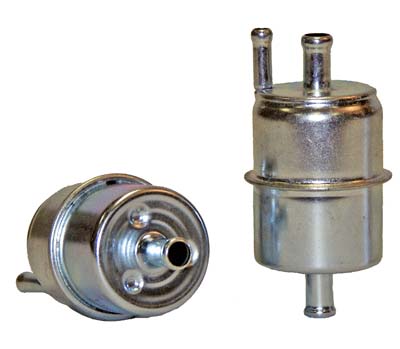

    A 33041 Wix filter and a return line to the fuel tank will cure your problem. It keeps fuel flowing through the system to keep it cooler.

    I have got the wix filter with the byp*** now. If I run a 1/4 " line back to my tank, will I need a fuel regulator or will the pump move enough fuel to keep the carb happy and cope with the 1/4 byp*** return?.

    You won't need a regulator or have any trouble with volume. The filter only byp***es over a certain pressure. When the fuel level in the carburetor drops, the needle valve opens, the pressure in the filter drops so the byp*** valve closes and all of the fuel goes into the carburetor until the needle valve closes again. It was used in many GM cars with large V8 engines and air conditioning. When you aren't using much fuel at idle, the fuel in the lines in the engine compartment gets hot. It usually remains liquid when it is in the line and under 5 to 6 psi pressure. When the needle valve opens, the hot fuel is dumped into an un-pressurized float bowl and it evaporates. Alcohol gas evaporates even faster. The return line allows flow back to the tank over the designed pressure to keep cooler fuel from the tank circulating through the filter. As long as the fuel tank stays cool enough you shouldn't have any problems. If the exhaust system heats the fuel tank or the road surface is very hot, you might have to do some modifications.

    I was trying to find detailed info on how this filter works, your explaination is great. Is there any other technical info for this filter / byp*** available. Like does it have a pressure the relief opens up at, how is the pressure differential managed within the filter.

    Now the fuel thing. The Wix filter and return line seems to have cured the vapor lock issue and it confirms it was happening around the fuel pump not in the carb. My under bonnet temperature on hot days ambient of 82F and long idling [parade traffic, jams etc] gets to around 180F. More recently I have had problems with surge after WOT and kickdown. Initially I was chasing torque converter or trans issues as it felt like the car was jumping from top to second. Today I blocked my Fuel filter byp*** and all my problem has gone away no surging at all. The upshot is, I need to put an on-off valve on my fuel byp*** line. Open for parade traffic and off for open road driving. I cant see any other way around it. I have a high temp switch set up now so that when my under bonnet temps go higher than 130F an auxiliary fan kicks in to help out [ it helps but not a lot]. If I had a solenoid valve on the ff byp*** I could trigger it also from that circuit. I'm not sure about having a sv on the fuel line though. I guess my Auxiliary electric low pressure fuel pump isn't an issue from a spark risk [ the auxiliary electric fuel pump did absolutely squat for my vapor lock issues. I won't remove it but its basically redundant. I wouldn't recommend one based on my experience but also vapor lock issues as previously discussed can happen at different places in the fuel delivery so each to their own]. I will look into the SV option as I know Ill forget to turn the valve on and off at the right times.....
