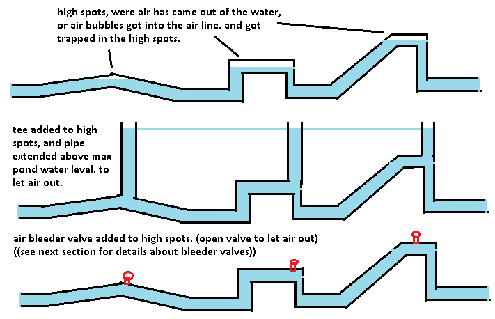

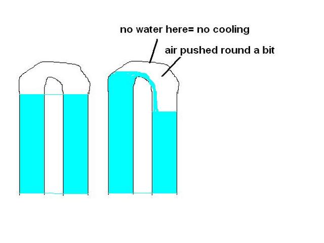

  9. Seems there’s another wave of smart brake fluid just being mean.
    Systems that won’t bleed or stubbornness of this bizarre fluid.
    Below are some basic entry level design elements of an air lock. Ancient civilizations had this licked till the smart fluid came. Stubborn brake fluid doesn’t want to let the air out of one of these. I’m sure it’s really arrogant to think that if I don’t build one of these into my brake line system that mean ole fluid will let the air by. The fluid cuts in front of the air on its way to the bleeder. Gallons of fluid go by and keeps the air in.
    That 4th example kind of looks like a frame rail. EED4EA18-6816-43DE-9A52-CBBCF74AA18B.png
    Where does this smart *** fluid go when you let the pedal up? How does it get there?
    871C6CC2-58BE-4EA7-8494-F9227F22A520.jpeg C6F37A03-8607-4112-B460-5F0CF94FE0BB.jpeg
    See a frame rail? A crossmember, a 4 link bracket, possibly a c notch,,,,,
    799A67EB-8F1A-4EFD-A5BE-21C319CC193A.png C172729D-12E8-4D71-971E-A405524F63C9.jpeg
