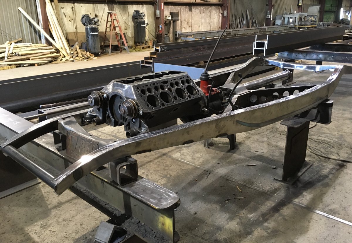

    572AF196-6C04-4A69-B580-5917BC980E08.jpeg Here’s where I am so far on this build.

    Are you trying to be period perfect or just in the spirit of the late 40's? If perfect, then you shouldnt be boxing the frame. It would have been extremely unlikely someone would have done that. But if you just want the basic look of the 40's then go for it.

    I will try to get the ride height with the crossmember and springs. If I’m still not there, then I will drop the front axle myself an inch or two.
    I want my car to have the look of the 40s build with a plan to build more, buy less.
    I had to box the frame. It had too much flex in it after I took it off the frame table. But I won’t box the front horns.
    thanks everyone for the history lesson. I’m new to this hot rods of the past.
