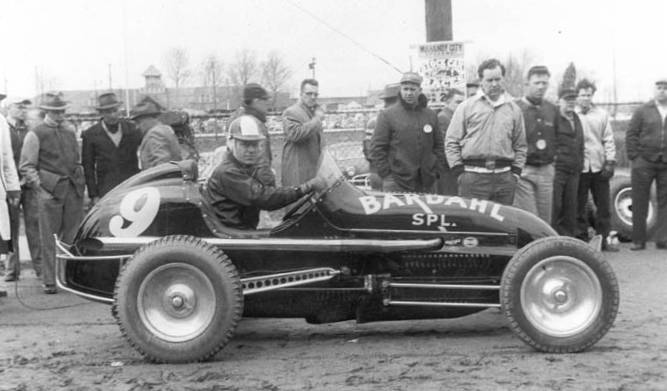

  8. PotvinV8
    Joined: Mar 30, 2009
    Posts: 549
    PotvinV8
    Frank Luptow's Bardahl Spcl. Sprint Car circa 1952, front 4-link.
    winduptoy and rod1 like this.
