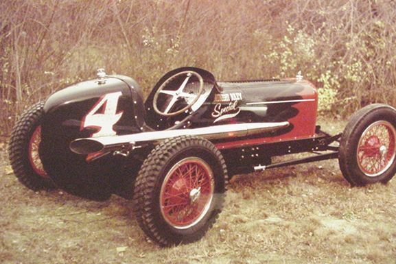

    I really do miss my old Riley 4Port, four plug wires and ONE wire on the car to run the kill switch. Body and paint is a lot more fun than mysteries of electrisity.
