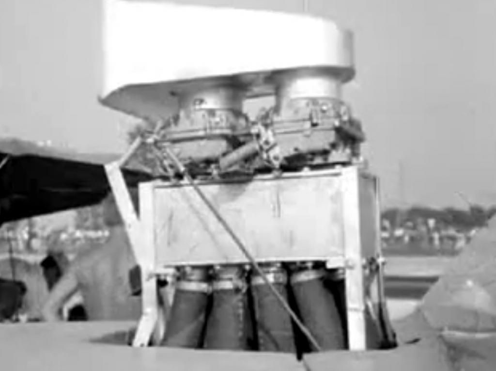

    I've always heard Ralph Ridgeway pioneered the first box type tunnel ram; the "Ridgerunner" intake. The Ramcharger High& mighty was also similar to a tunnel ram. Not quite sure on the dates, would have to dig into the old mags to pin it down

    Totally forgot about the High n Mighty car!! As far as making one....no. I'll probably buy one. If I even get to do this. Anyways, thanks for the quick history lesson.

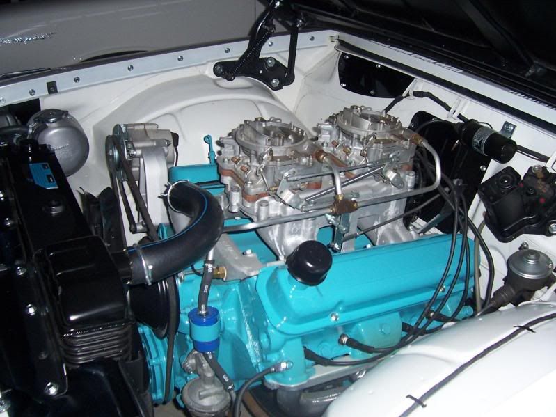

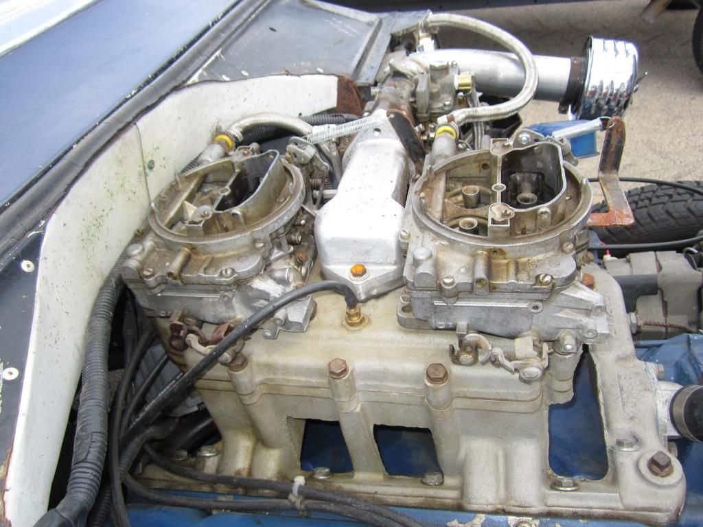

    Pontiac would be the first to make a true 'tunnel ram' intake. It appeared on the 1963 13:1 compression 410-HP 421 SD engines, ready to do battle in the 'Stocker Wars'.
    The setup pictured below has the center one-barrel side draft idling carb intact, very rare to see this. The factory soon found it really wasn't needed and blocked off the opening for the center carb with a plate.
    VANDENPLAS likes this.

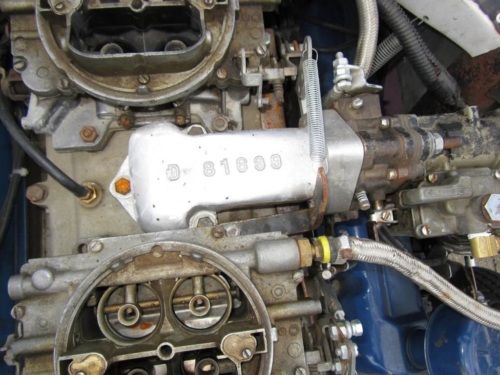

  14. draggin'GTO
    Joined: Jul 7, 2003
    Posts: 1,795
    draggin'GTO
    In all of its naked glory here's a rare reproduction of the 9772128 'bathtub' tunnel ram intake. Later versions of the factory intakes completely eliminated the holes and mounting pad for the center idling carb.

  18. draggin'GTO
    Joined: Jul 7, 2003
    Posts: 1,795
    draggin'GTO
    Factory installation, 1963 421 Super-Duty Tempest.
    Six Tempest coupes and six Tempest wagons were built with the 421 SD that year, very rare factory race cars.
    Perched on top of the 'Bathtub' tunnel ram were a pair of NASCAR 750 cfm AFB carbs.
    A thing of beauty.
    lawman and squirrel like this.
