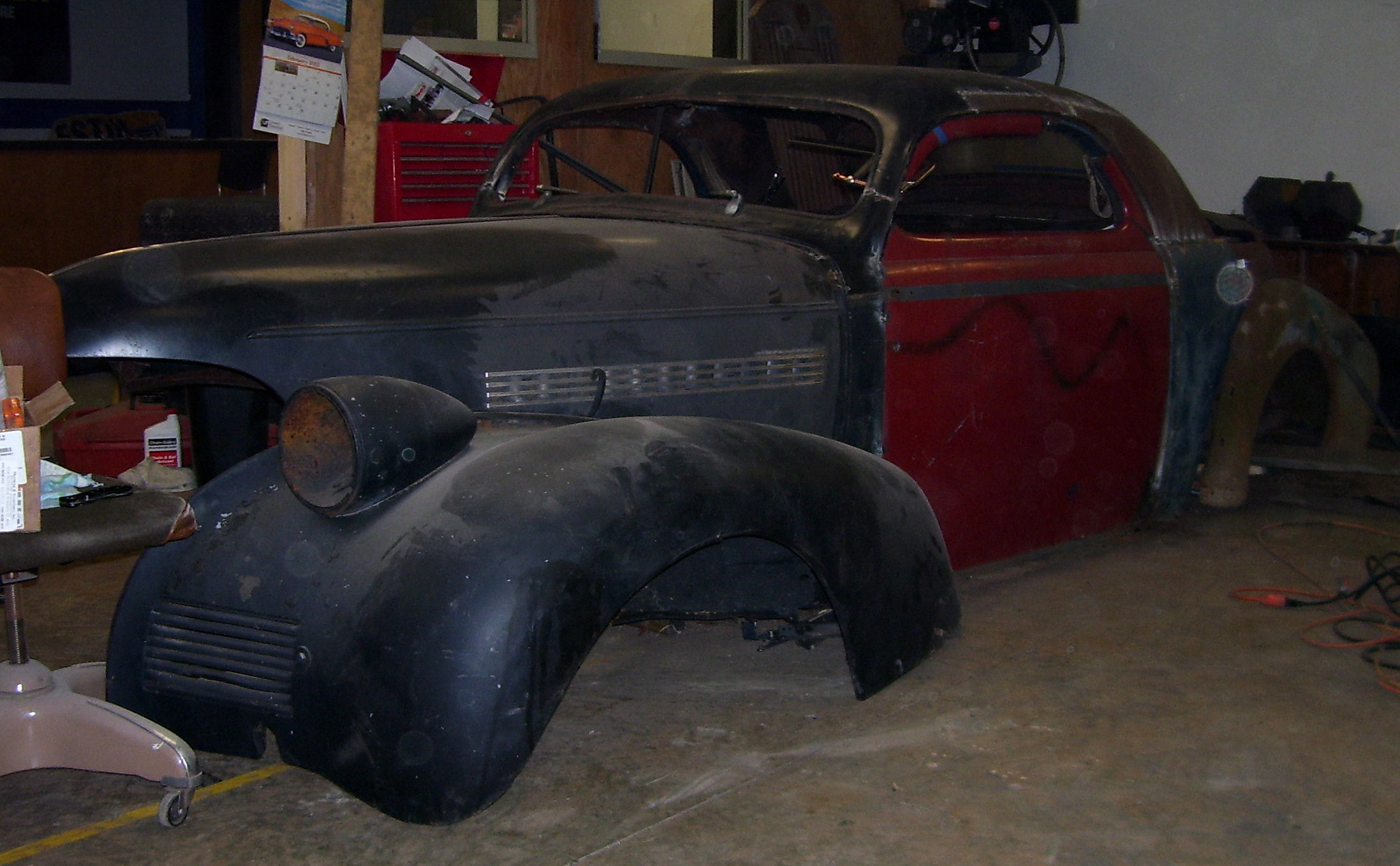

    I'm going to use the S10 ch***is that the 39 Chevy came on. The wheelbase is pretty close as you can see the the first pictures of the 39, but It's not going to matter how close the wheelbase is because I'm cutting the car up to fit anyway.

    The front is lower than the back, but just slightly lower I think it's still safe from the racer look

    Cut the car in half again and shortened it 6 inches. I have to give a shout out to Mike Bermudez of Damaged Goods Customs for ***isting me on this build

    X2 for raising the front of the roof a little more.
    I like what you´re doing.

    Threw the front on just to see how she'll look

    The body is coming together well. Cant wait to see it all together and layed out.

    Proportions are looking really good, I'm a believer now. If you can get that transition from the rear window to the trunk lid just right, you'll have it nailed.
