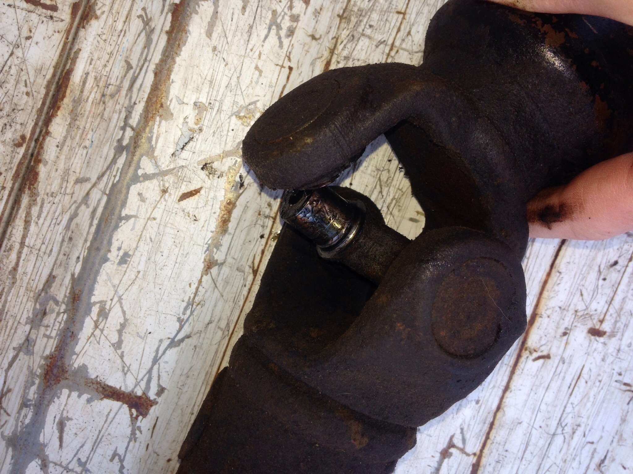

    Sorry to hear of your problem, but you'll always remember this Thanksgiving! Glad it was nothing more than a broken u-joint. Also glad you took the car off C/L - "Act in haste, repent in leisure".
    As far as the RPMs being too high, check out what ratio rear end gears you have. You might want to change them or replace the transmission with an O.D. unit. Also might want to put a tach. in the car so you can tell exactly what RPMs you're turning.

    Ordered some new moog u-joints from rock auto. Should be here in a week.

    Yeah I searched NAPA's website but the only U joints for the rear end side were labeled for a 3 joint driveshaft (2 piece). Where as mine is a single with 2 joints.

    Have you got the drive shaft out of the car to be sure of that? U joint was my first thought when I first started reading the thread as I've had more than one do the same thing. Good to see that it is an easy fix though.

    The cap let go on the highway

    I went all over town trying to get somebody to press in the new U joints. One franchise said no because I had my own parts, another wanted 100 bucks and I found a hole in the wall with a nice guy who said only 40 bucks.
    Well two hours later he comes out and says its bent and he cant do it. This was on the rear yolk that wasnt broken to begin with. The fuckin guy was beating it with a hammer. Now I'm shit out of luck. Theres a driveshaft repair guy he told me to go to and itll be in the neighborhood of 150-250 IF the guy can find a rear yolk to weld on. Of course these driveshafts are made out of unobtanium. Im so pissed

    Oh my god it takes 2 minutes to press in a universal joint with a vise. Why would anyone beat on one with a hammer.
    Take it to the driveshaft guy and see what he says. You know what happens when you jump to conclusions.

    He has done several for me. He did me an aluminum driveshaft with new joints and a new yoke for $150. He may be able to put another yoke on the driveshaft and use one of those crossover type UJoints.
    I also know an elderly gentleman in Mint Hill with an early 50's Caddy he would sell for close to scrap value. It really was running when he parked it. Worst case you could buy the driveshaft. If interested PM me.
