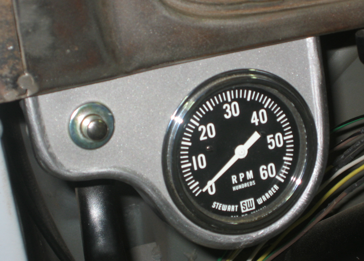

    Didn't want to cut any additional holes in dash or mount on top of dash. Made a bracket on lower left bottom of dash for tach and a starter ****on. Tach is a old 765 model with sender mounted with fuse panel. Six grand was enough for the Nailhead.
  3. I've seen you post this before, to me that is the epitome of cool!

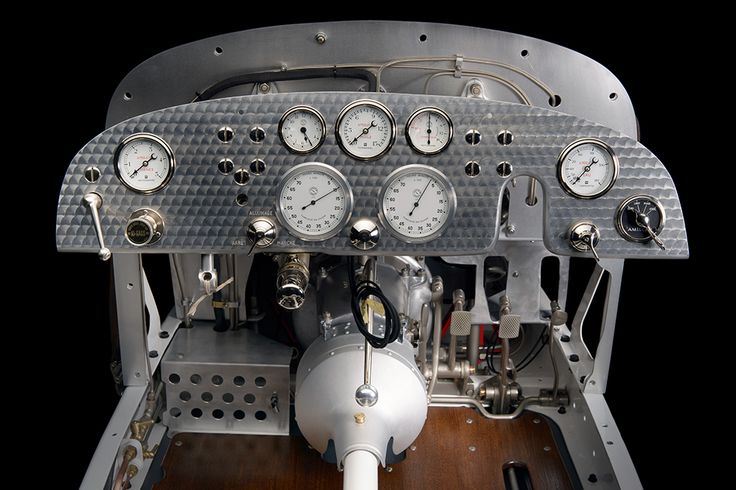

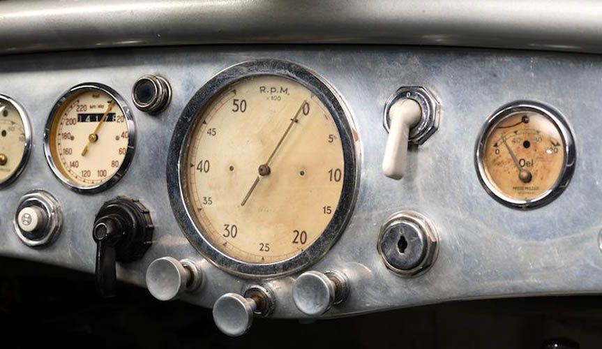

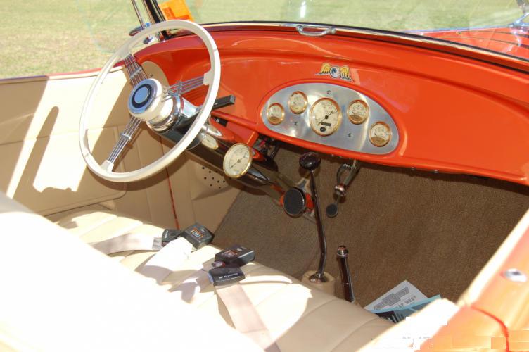

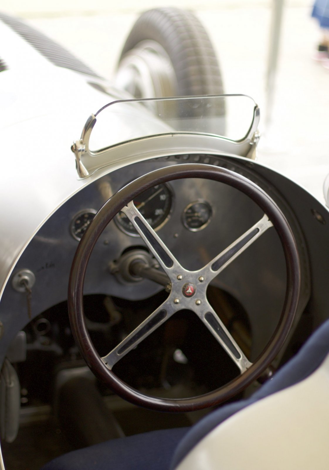

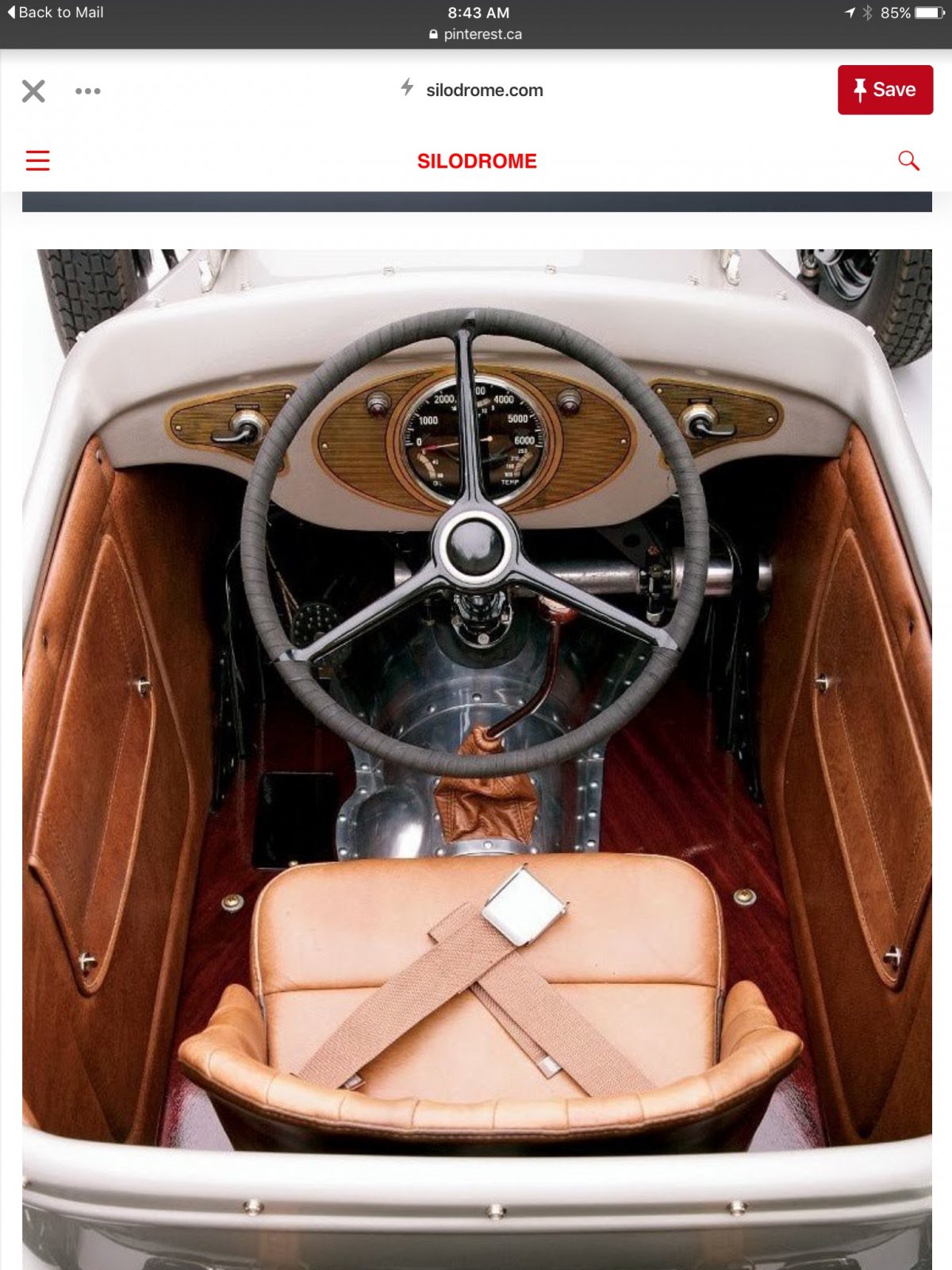

    Some pics I’ve saved over the years for inspiration.
    9F54F61D-ACD7-4A0E-9B59-0757D871E91D.jpeg 63317D9B-6053-4C57-B619-A6A5A19C8333.jpeg F208FA91-457B-4DA4-99B6-D53BB5BF8FAF.jpeg 54EEC15B-3140-445F-BE1C-F35DAC7CB87A.jpeg 84B43734-238B-40EE-B770-D03C2C023EE9.jpeg

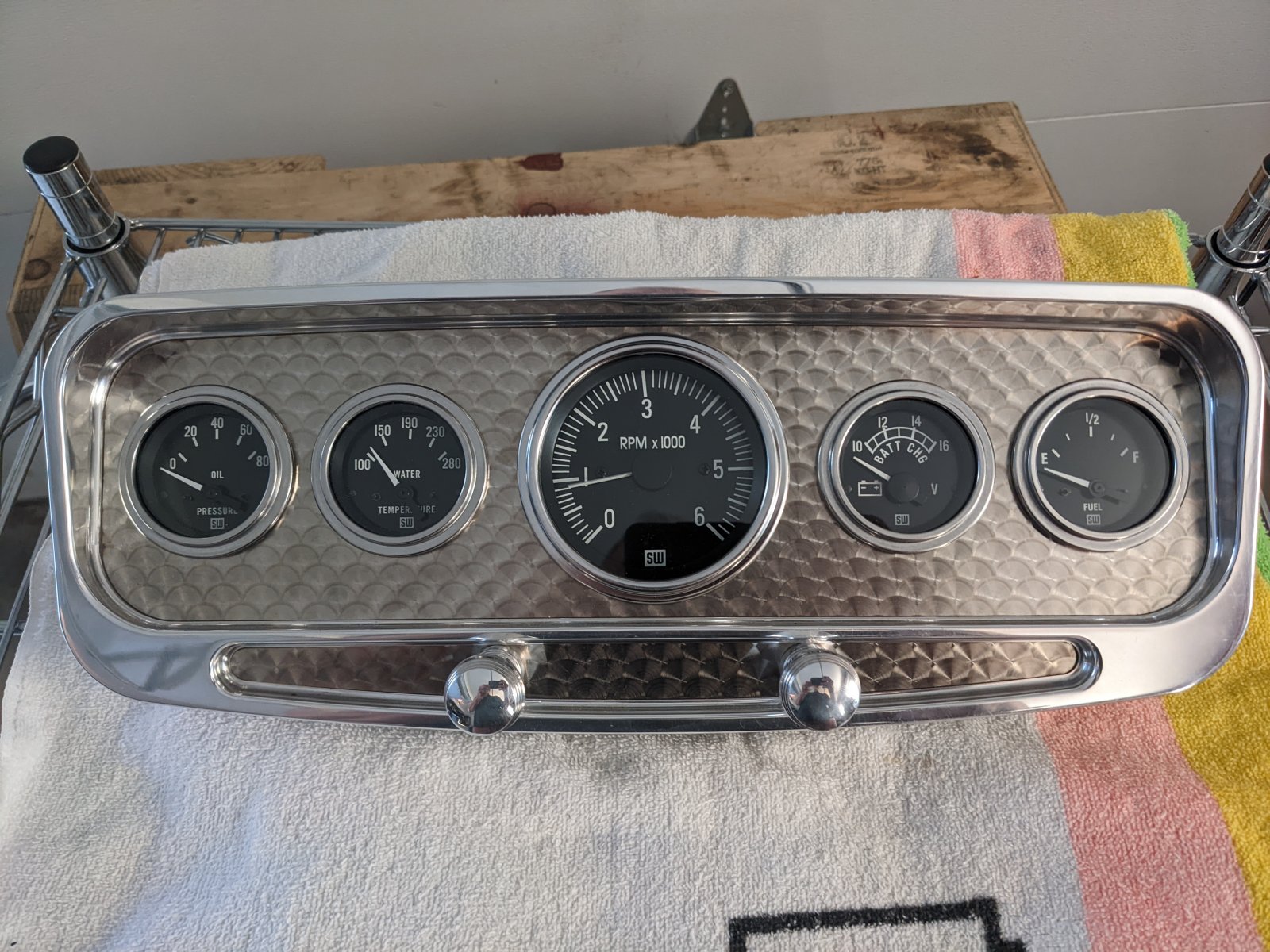

    I put mine in the middle of the console. I retrofit these gauges into the car and didn't want to cut up the dash or otherwise have gauge panels hanging off the bottom of the dash. Obviously they're out of my line sight, but this isn't a performance application and just having them there will at least tell me what I need to know. IMG_5453.jpg

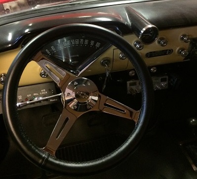

    Here is mine, on my 1957 pickup: cut up an exhaust pipe, welded it to the dash, and mounted a tach inside. Chrome bezel is from a metal travel cup.

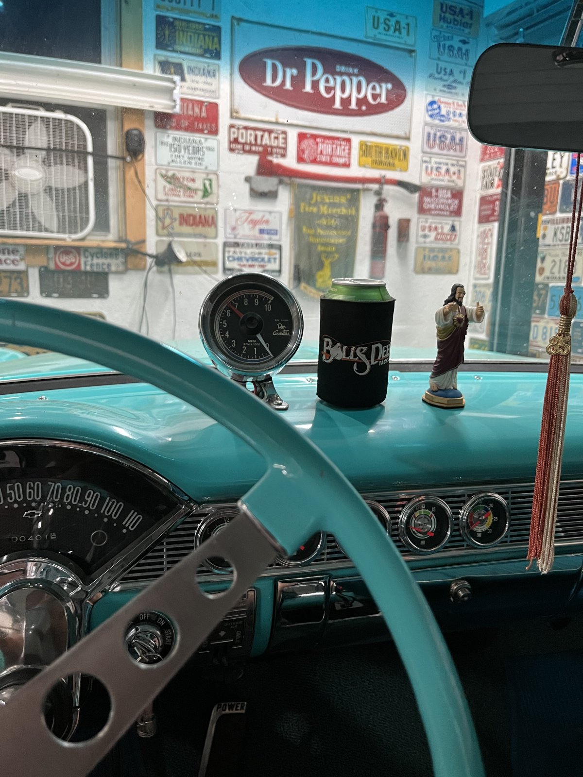

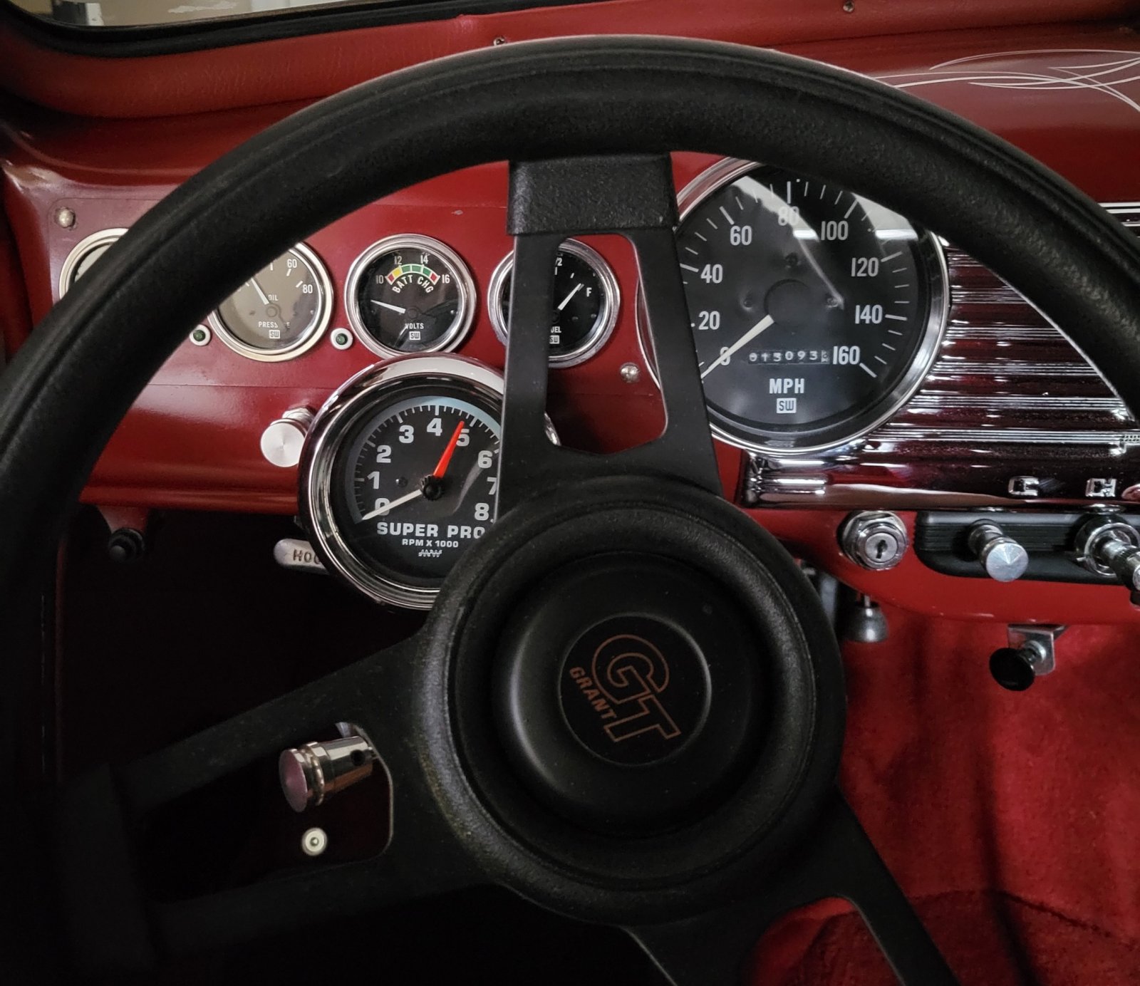

    Mine is conveniently located near the other gauges. Please disregard the red line, it just looks impressive. If it ever got near 5 grand it would be raining pistons in Phoenix.

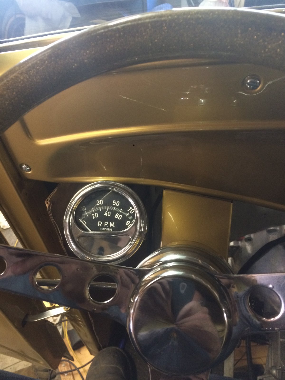

    I went under the instrument panel like a few others. Being the obsessive **** that I am sometimes I had to have the tach and 1953 Sun vac gauge at the same hgt and face angles.

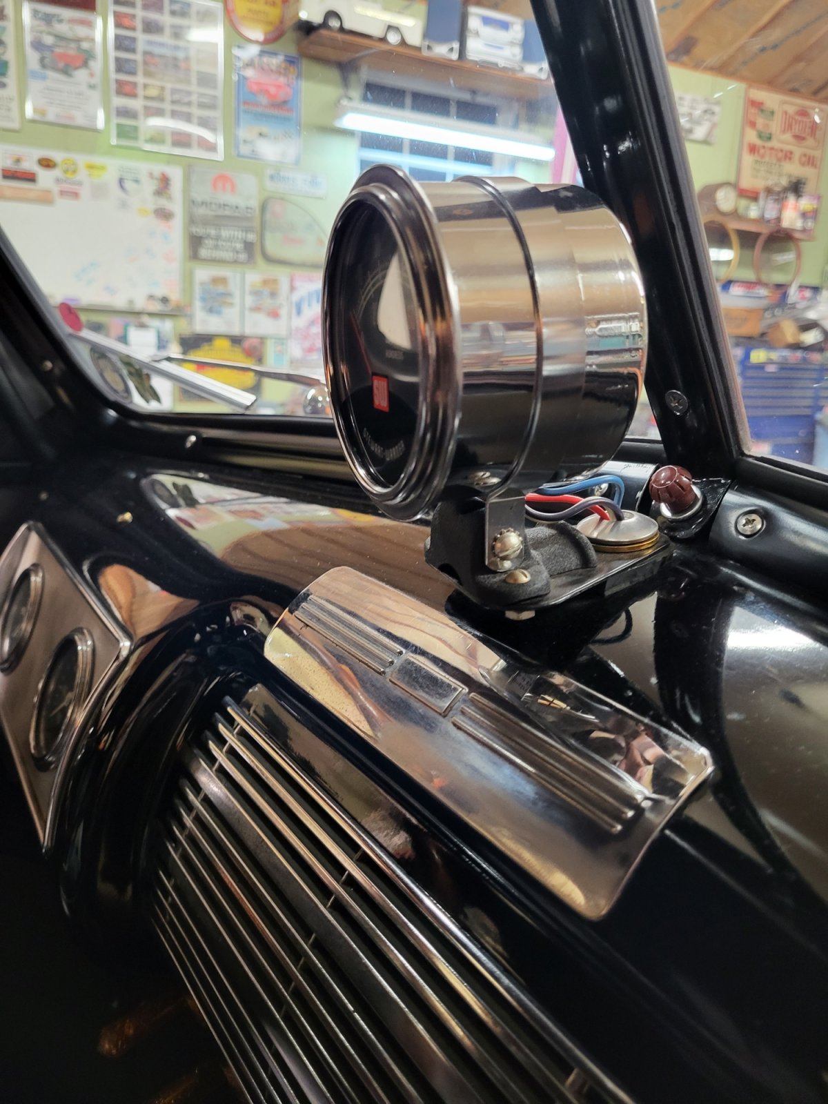

    On the dash..Made a little mount out of aluminum, polished it, and used a screw from the speaker to hold it on, tach bolts to that..have it angled to face me…wrapped the wire and ran that through the speaker grill..

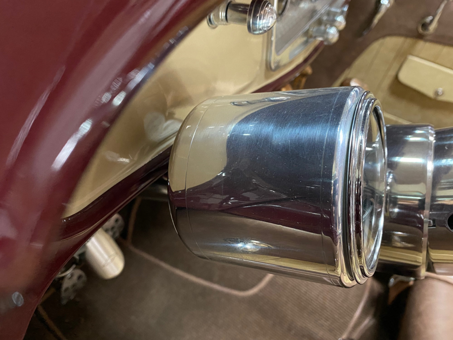

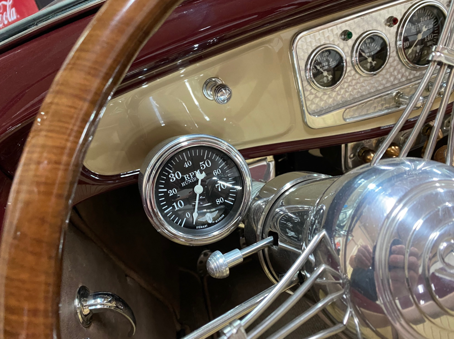

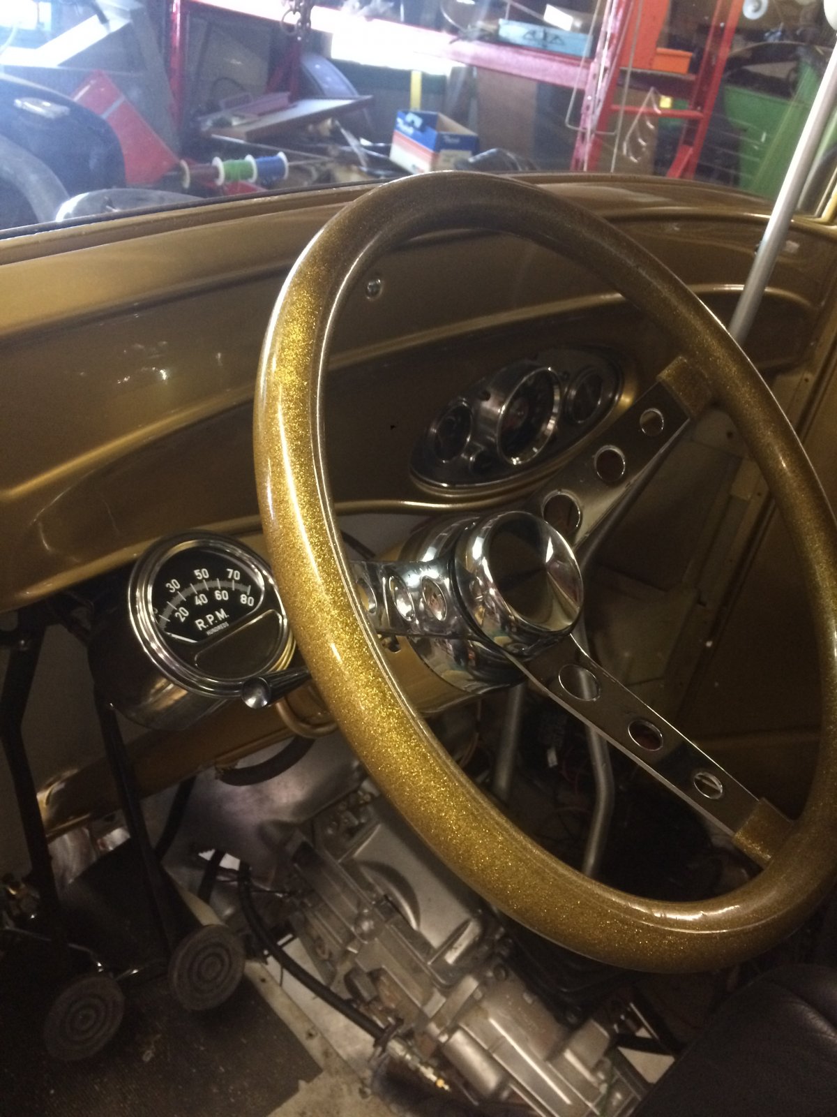

    On my roadster it's on the column in an aluminum cup
    No hose clamps on this one,

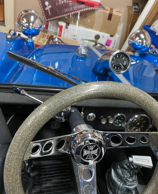

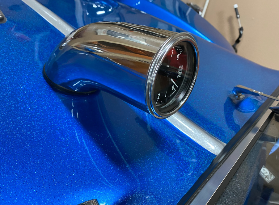

    On my OT dune buggy I stole an idea from @Moriarity on his wild *** Futurian. He didn't have anymore of these boat deck tach mounts in his inventory and the shop he purchased his cast aluminum ones from closed during the flu thingy and didn't reopen yet. So Mark sent me pictures and dimensions so we could built one.
    I purchased a 3" diameter,45 degree, stainless steel street elbow from Summit and chopped it off to fit and @Pist-n-Broke tigged up a mount plate with 3 studs to fasten it to the deck. A little door edge molding around the base and tach firmly secured with silicone. Liberal amount of polishing of course. The result is a cool hood tach that stares you right in the kisser.

  20. Dune buggies are kewl!:D

    Looking good on a hood....

    Vroom-a-Zoom-Zoom!!! :D

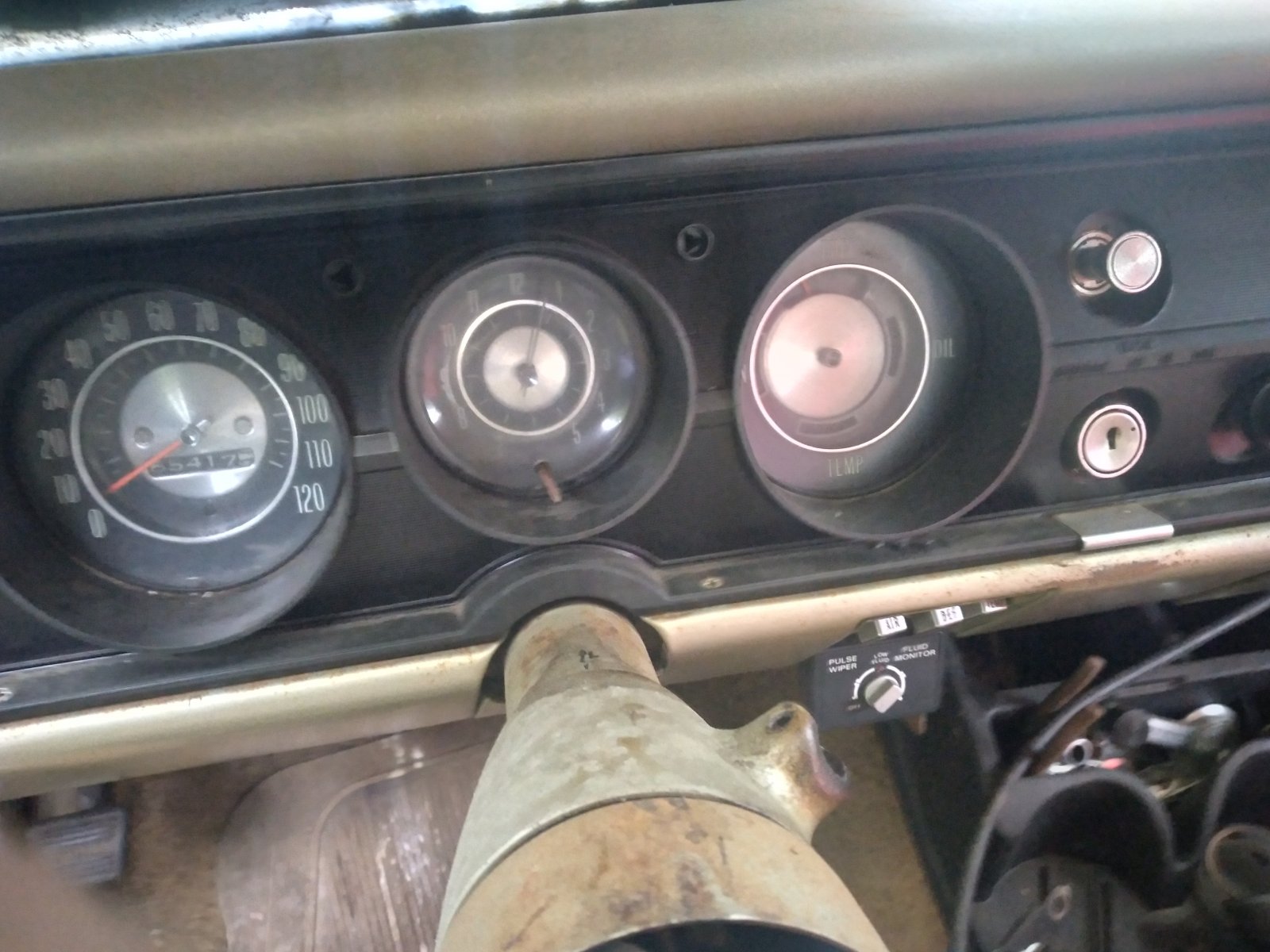

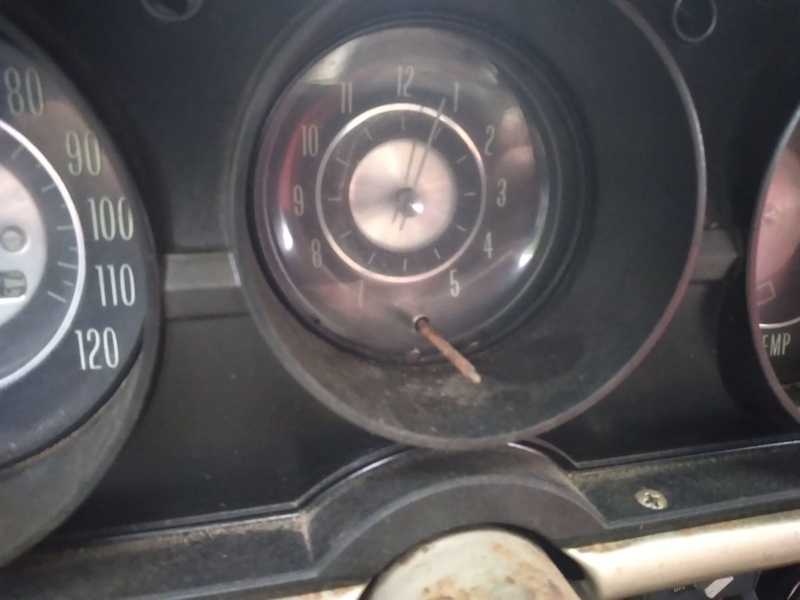

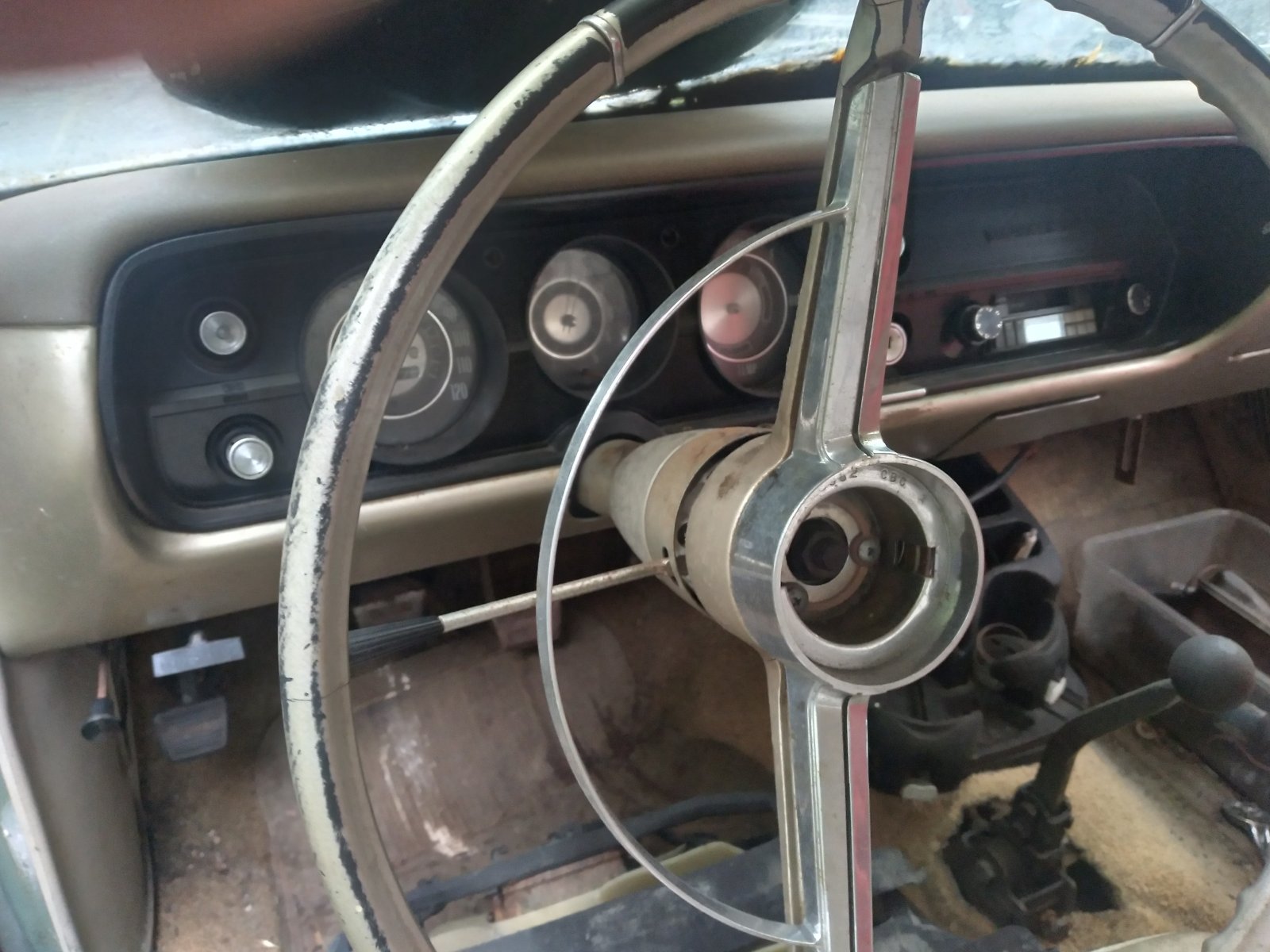

    In my Chevelle I gutted the clock and installed a tach in it. 12 o'clock is 0, 1 o'clock is 1,000 rpm and so on.
    Man I should get this one back on the road.
  24. 427 sleeper
    Joined: Mar 8, 2017
    Posts: 3,369
    427 sleeper
    Now THAT'S ^^^^^^ a Killer idea!!! :cool:
