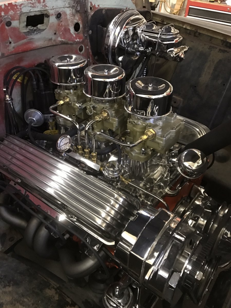

    Did mine with the Eastwood spray also but “dusted” them with a very fine coat of silver to brighten them up slightly.

    Nice looking setup. Good job!
