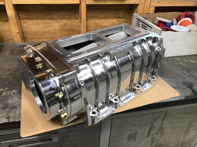

    The Speedmaster parts are cheap and you get what you pay for, I've seen a lot of complaints that things don't fit just right and machining has to be done.
    I had a couple bad buying experiences when buying from private sellers. One was not the sellers fault but the shipping company that damaged the blower and the other was a blower advertised as an 8-71 but when it arrived it was a 6-71.
    So do your due diligence when asking for photos and inquiries about how they intend to ship it.

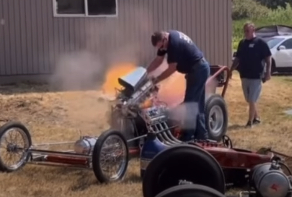

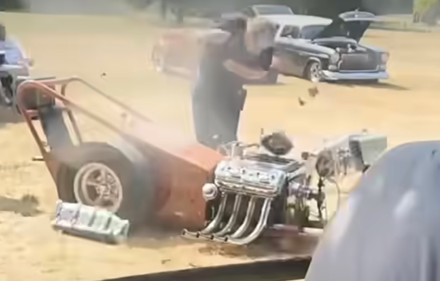

  18. Be more careful than this guy
  19. saltflats
    Joined: Aug 14, 2007
    Posts: 13,636
    saltflats
    from Missouri
