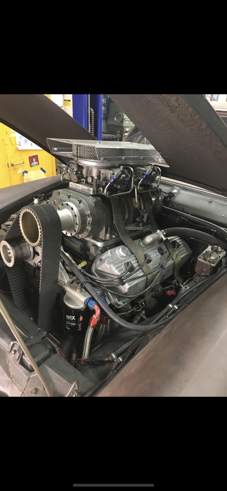

  16. mohr hp
    Joined: Nov 18, 2009
    Posts: 1,576
    mohr hp
    from Georgia
    Not sure what makes you think the blower is too big, it's a 489 inch Gen 2 Hemi with a good set of Dart heads.
    I'm at 3% Overdrive making about 15 lbs. boost on E85 and a pair of C&S 1100 Dominators. Can't remember the cam duration. but it's only .650" lift. It made 1128 HP at 7800 RPM and is very streetable. When I said it wasn't as aggressive at the hit, what I meant was, not as aggressive as a typical tight stripped big blower. It still will annihilate the tires at 70 on the road. It's not a drag car, it's a Land Speed deal. I'm not looking to hop it up any, it still holds the record in its cl***. I have some data logging onboard, but not induction temps. The engine is currently out of the car and in pieces because one of my Crower Maximus lifters stopped rolling, and my pan is full of metal. I'm busy with another project at the moment, so the money faucet on the Hemi is currently "off". IMG_9491.png
    ekimneirbo, swade41, rod1 and 3 others like this.
