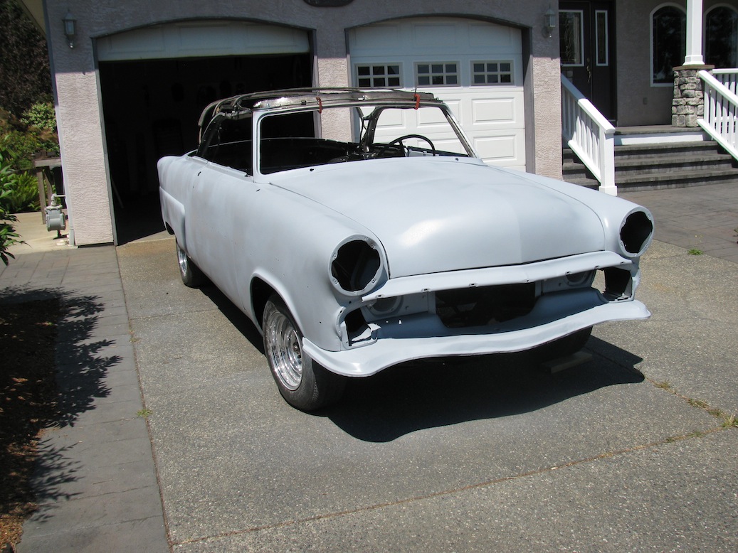

    Put some more primer on this weekend, and earlier in the week got the door/fender gaps looking better. Now everything is just about where I want it. Going to put the dash in, bumpers on and install the 54 Desoto grill - and then put this project away for awhile. Want to get back to my 33 ford five window coupe build - it has been sitting too long. IMG_0566.JPG
    volvobrynk likes this.

    Finally got this project to the stage where I will put it away and get going on my 33 Ford 5 window.
    Here are some current pics showing the grill installed, bumpers on, etc. Really like how it is turning out, and the hard work is over. IMG_0613.JPG IMG_0616.JPG IMG_0622.JPG
