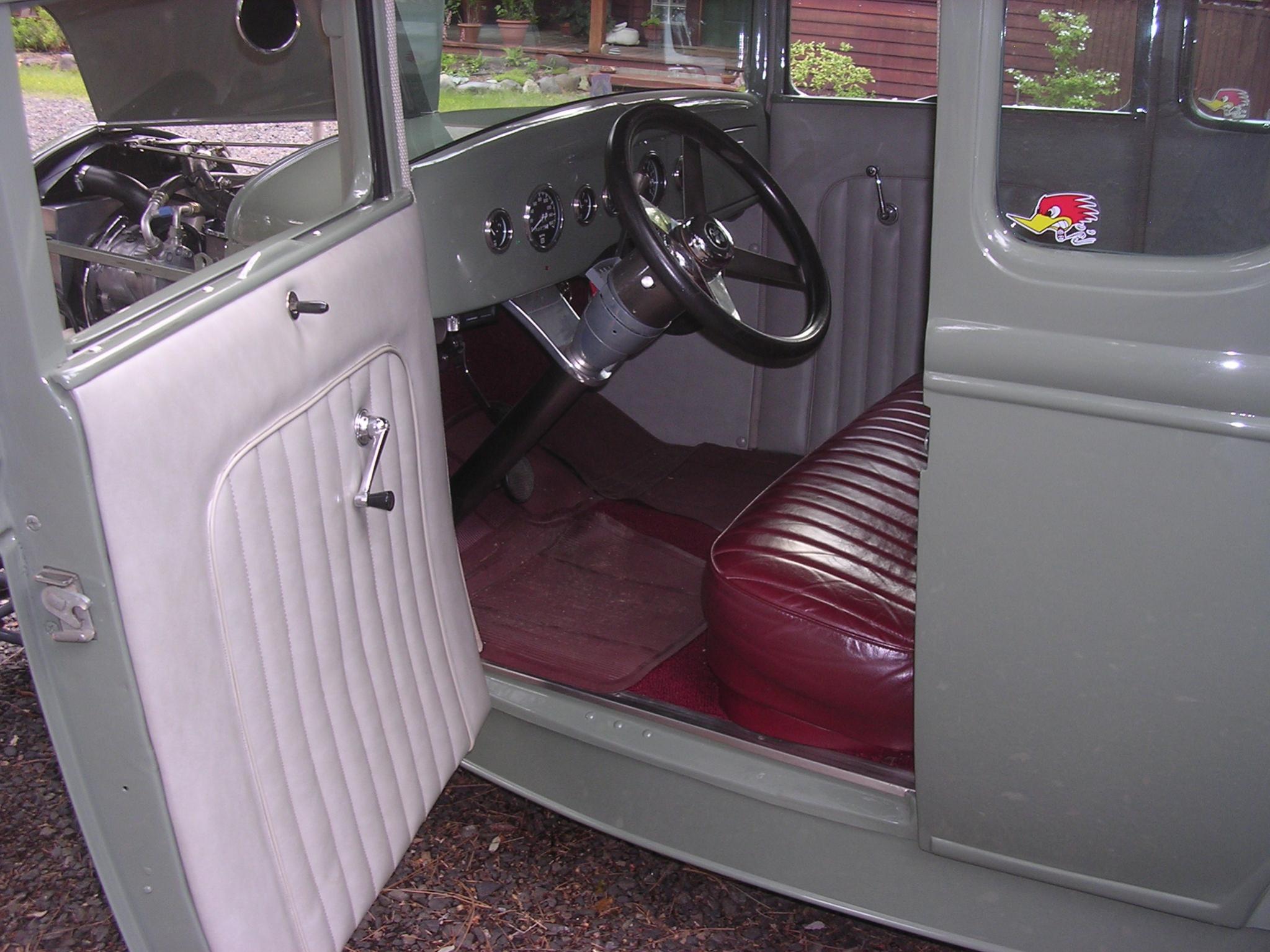

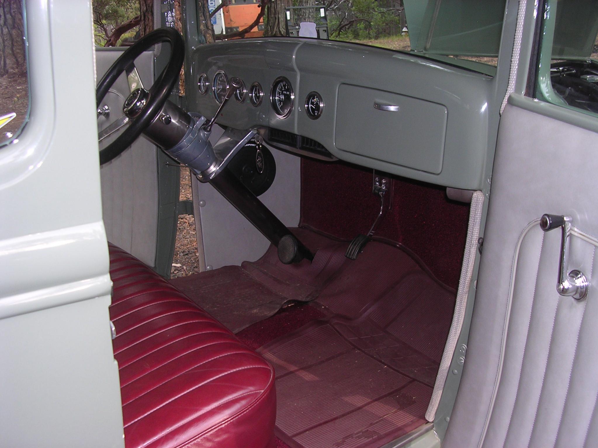

    Don't think I've seen the thread you are looking for but here is a '36 dash I recently cut down for my current build. Somewhere I have some pics of it as I was putting it together. If I find can find them I'll post for you.

    Mine is built over a Model A dash rail and bolts on at the stock locations. That way I didn't have to weld to or modify the body.
    I found a bunch of pics. Here's the first batch...

    You'll notice that some of these pics have the 'horns' in the corners that I reshaped from the original ones on the '36 dash. After I got it done I decided that I didn't like them so I cut them off and reshaped the corners. (per my pics in post #6 above) I like it much better without.

    Last batch of pics...
    Let me know if you have any questions about any of them. It was my first attempt at cutting one up and I really kind of made it up as I went but it turned out pretty nice.

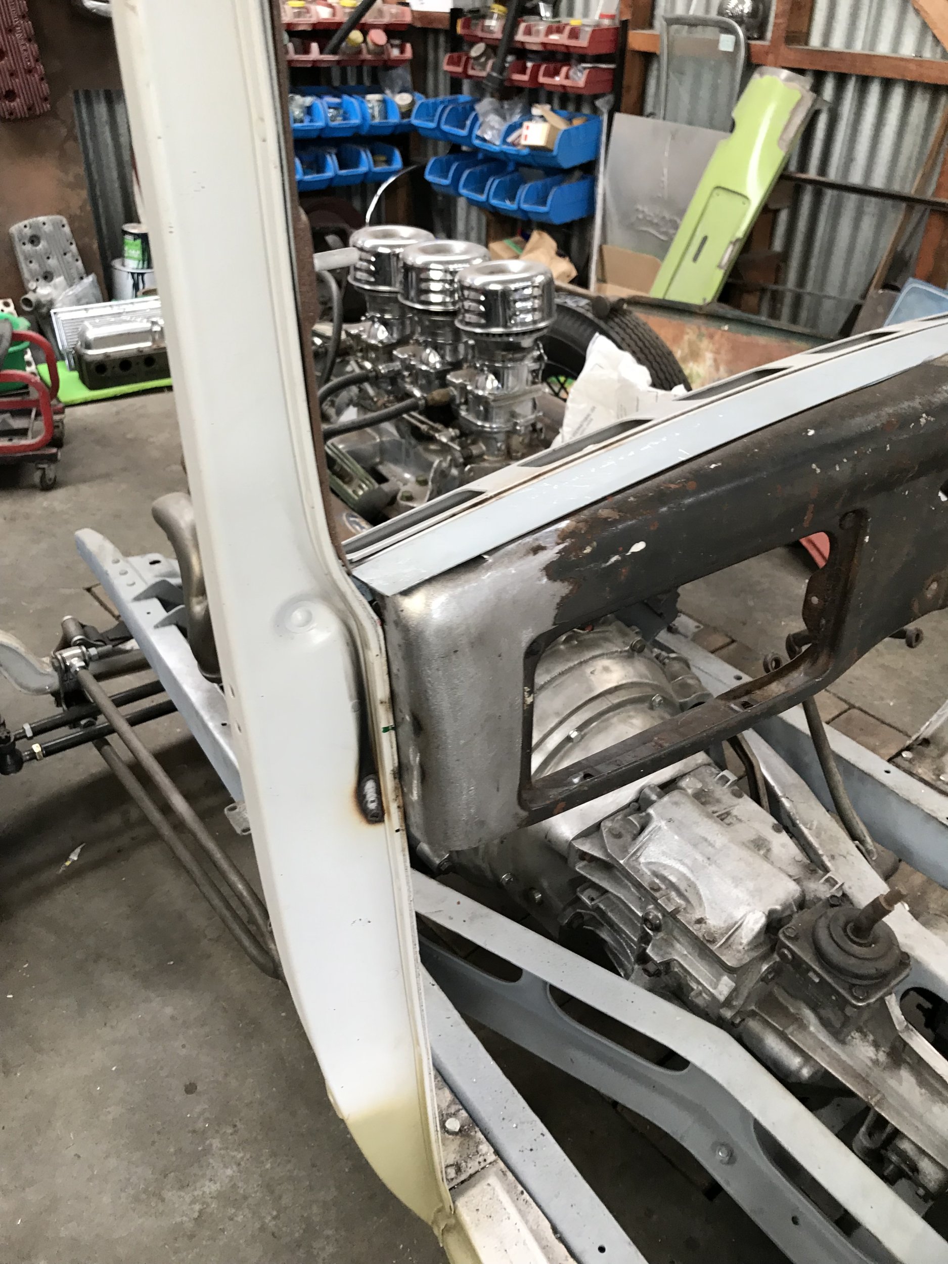

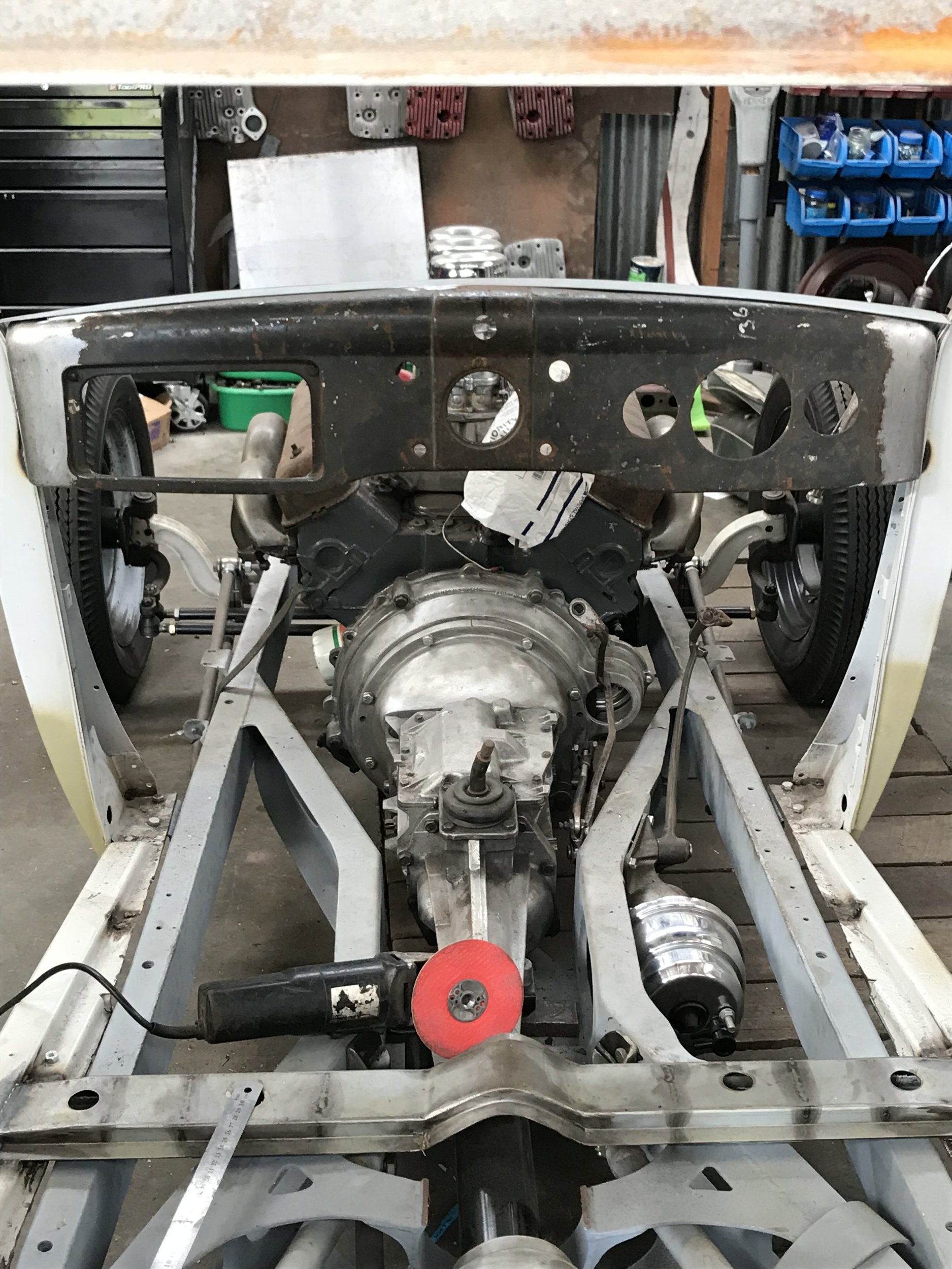

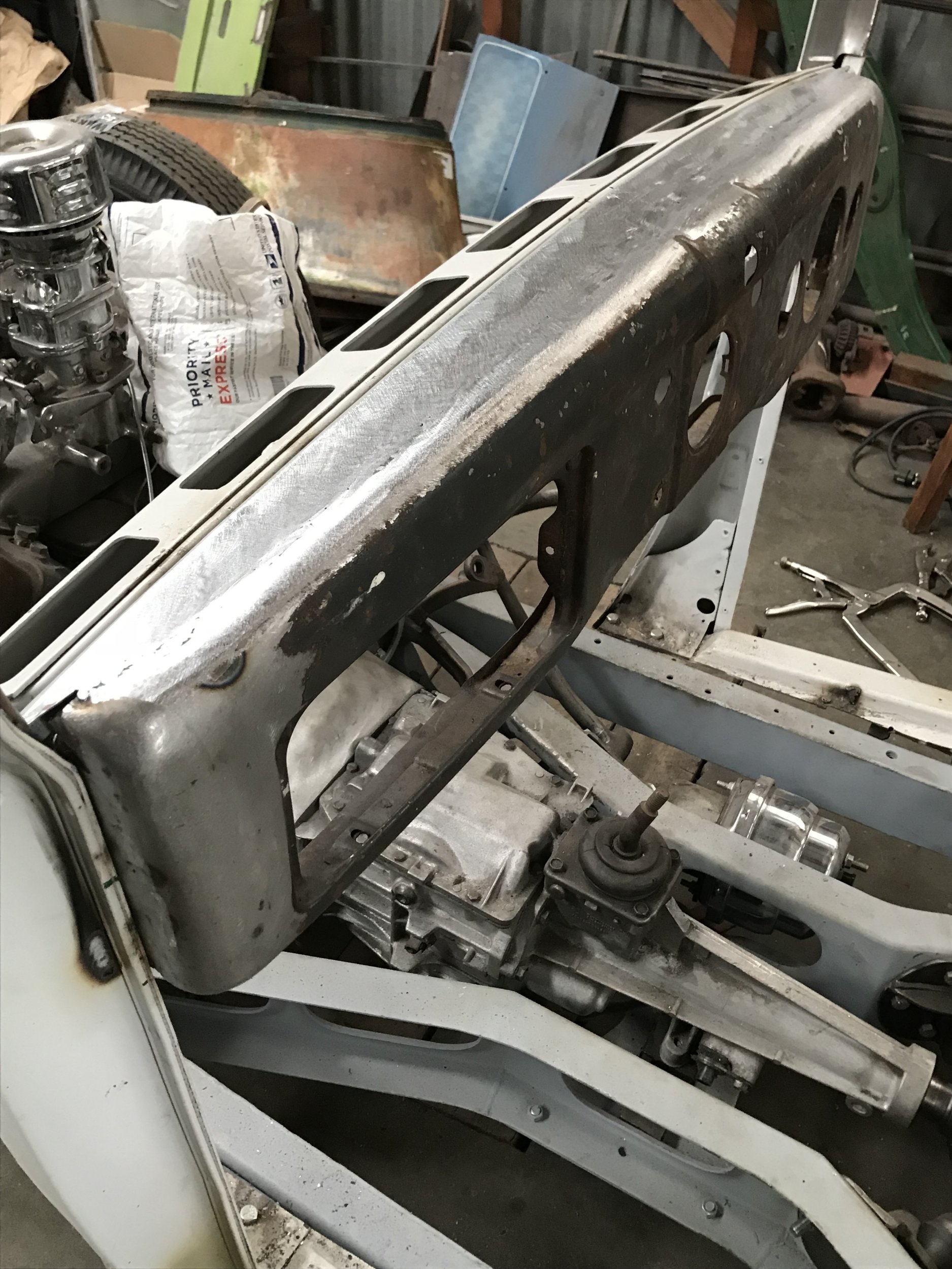

    IMG_0127.jpeg IMG_0144.jpeg IMG_0143.jpeg IMG_0142.jpeg [
    My son fitted one to his 28 , a bit of slicing and dicing. What we didn’t allow for was the window regulator hitting the dash. Thankfully ford had allowed for this and with some manipulation the window regulator mount holes and the door remote hole were exactly the same and we were able to transpose the by a stroke of luck and small metal shaping internally reshaping the remote arm and adding a return spring. remaking the ears was a little more tricky to get it fitting close to perfect. ATTACH=full]6416803[/ATTACH] IMG_0144.jpeg IMG_0143.jpeg IMG_0142.jpeg
