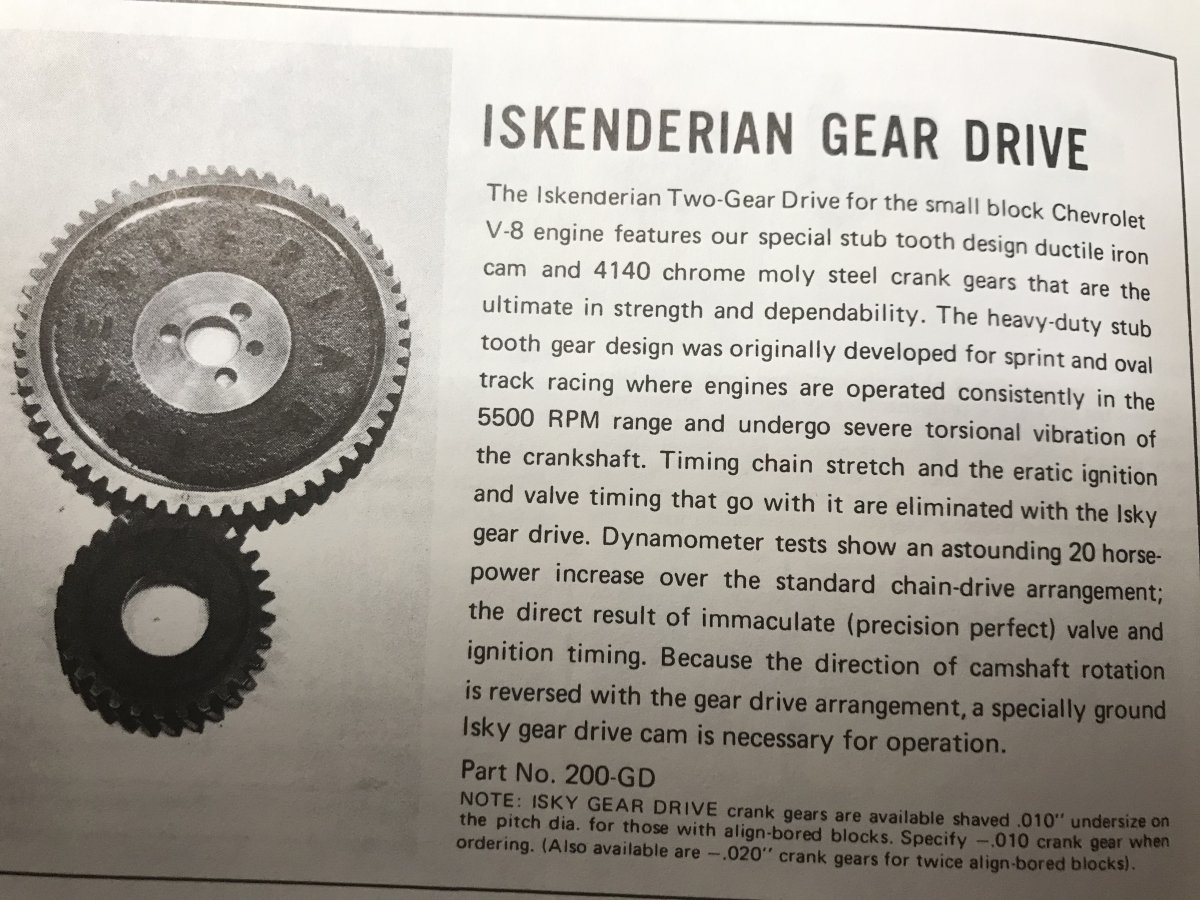

    If you need an engine to run reverse then you swap the chain camshaft drive for a gear drive. The cam, dist, oil pump still go standard direction, just the crank goes in reverse. For ign timing BTC is now on the opposite side of the TDC mark.
  14. Fordors
    Joined: Sep 22, 2016
    Posts: 7,051
    Fordors
    It would be that simple if Isky still made his SBC gear drive, but that hasn’t been marketed in years, all the gear drives today have idlers that would put the cam back into CCW rotation.
    I’m not aware of a two gear GD but I guess there could be one out there on the market.

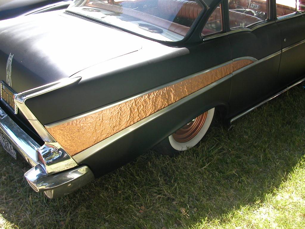

    Looks like the back room at The Cow Palace (San Francisco). I recognize some of the cars in the background, but not this one.
  16. gimpyshotrods
    Joined: May 20, 2009
    Posts: 24,631
    gimpyshotrods
    Car in the background. This picture was taken at Billetproof Nor Cal. DSCN0823.jpeg
