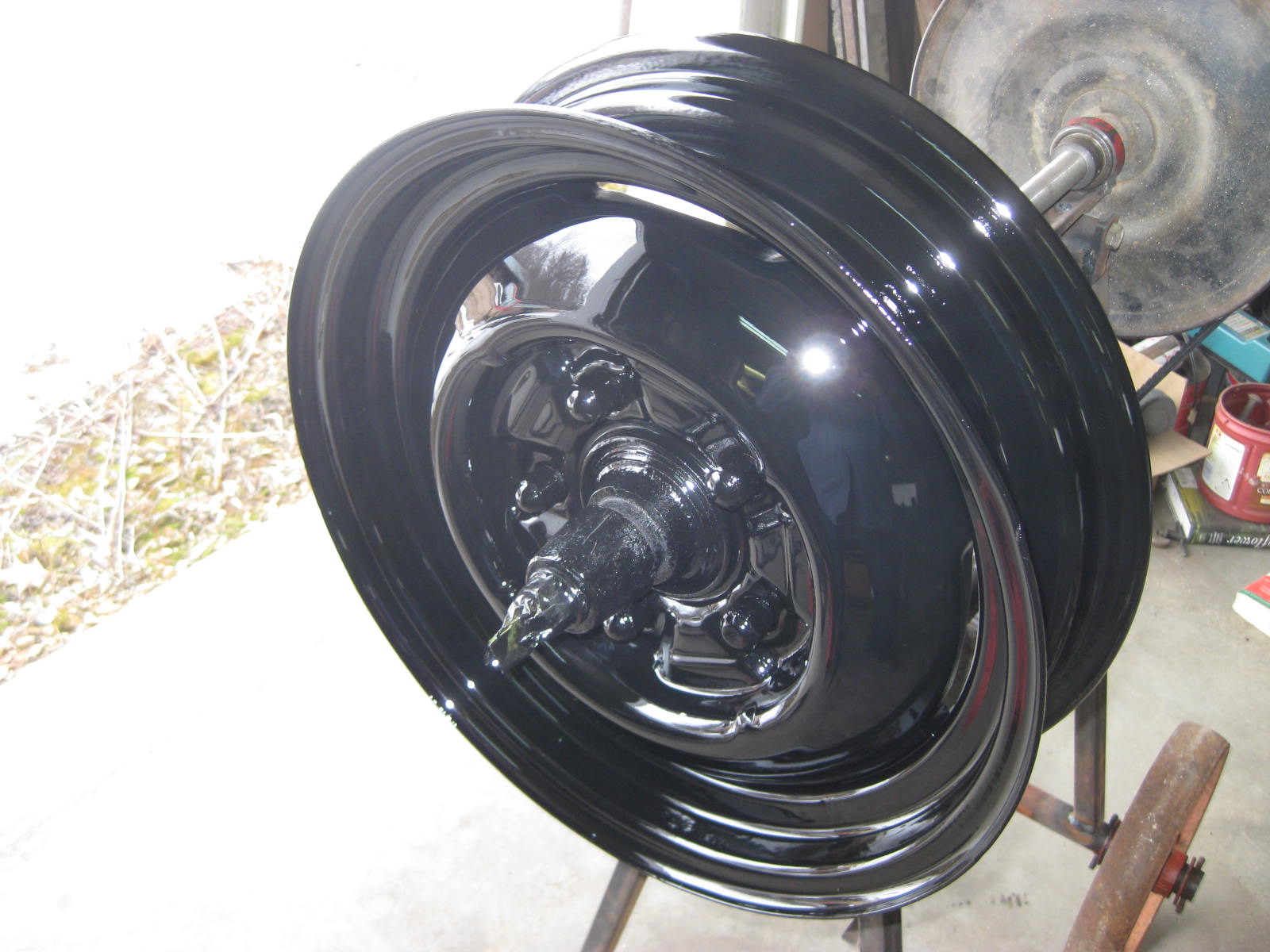

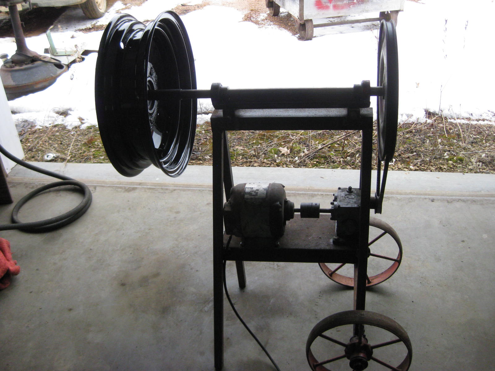

    I made this rig for painting wheels. Works good, no skill required, practically pour the paint on and it flows out perfect every time. Runs at 5 RPM's ED2E8F4B-087C-4D98-91AD-0E6490778B69.jpeg 8CA77411-ECEE-4913-8F49-E20CE59F2F27.jpeg

    First time I used my machine I left it run for about an hour after painting. Not long enough, it had big sags in the paint next morning when I looked at it and had to be stripped and done again. Now, I will leave it run all day. It was free to make as I'm a guy with lotsa junk...Ah...I mean, stuff around. I've since made a few adapters to mount lots of different things for painting, and even can spin a gas tank for cleaning. Its been a good thing to have around if you have space to store it and stuff to build it.

    @Joe H , I've not pinstriped yet, but yes it could be done. I pull a pin and the top tilts to remove the belt so you can turn it by hand. Good for checking a wheel for true, and prepping for paint.
