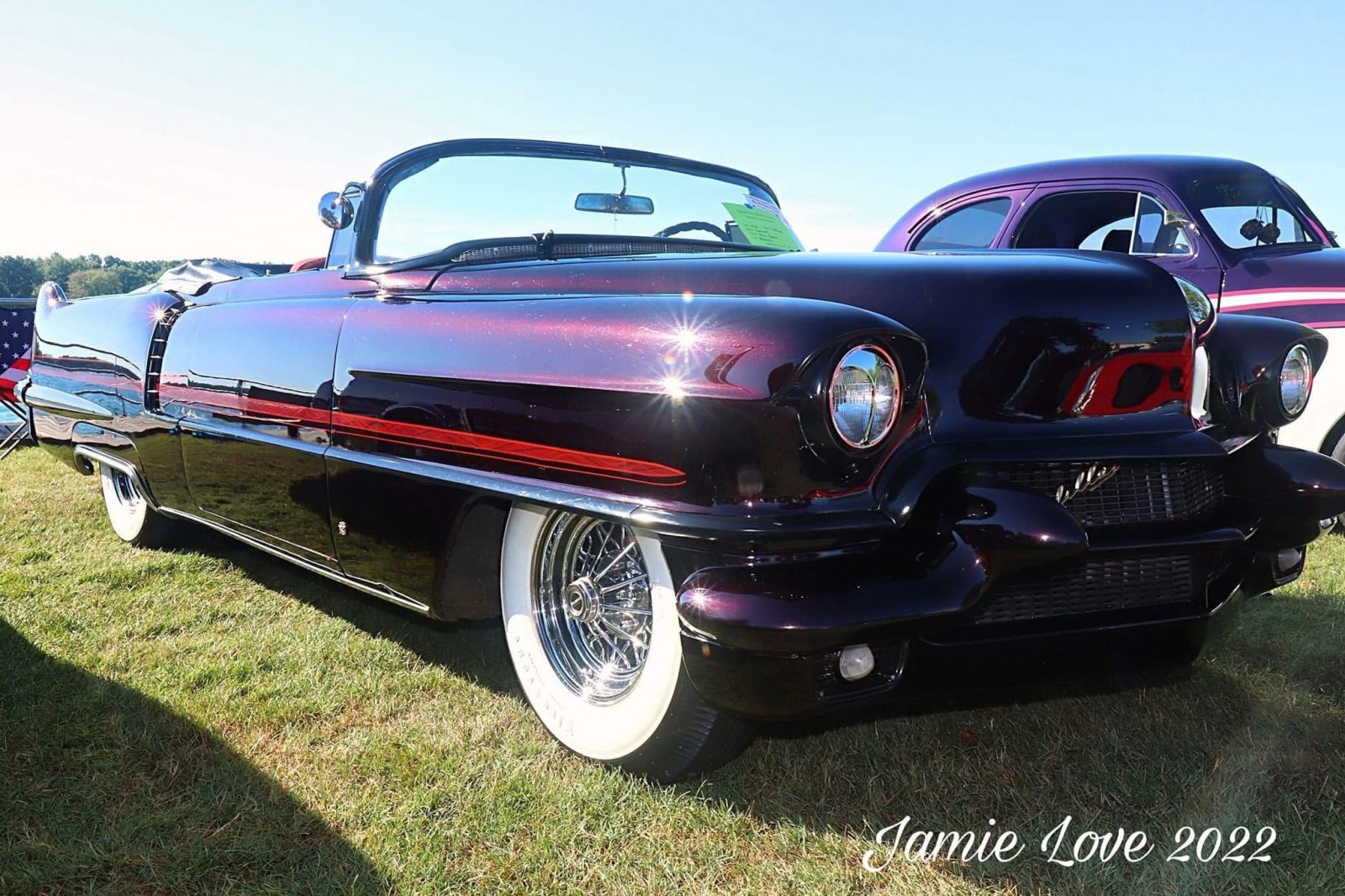

    It's easy to cut it yourself if you have a sandblaster and duct tape. Blow through both sides, cut the plastic inner layer with a razor blade, and dress the edge with a belt sander. If I can do it, anyone can, my old Caddy is proof of that. D1D9DDC3-F237-49DB-BA43-342EC0104301.jpeg Cut the glass FIRST, form your opening to fit the glass. Side glass is flat, any glass shop can cut it if you provide templates.
