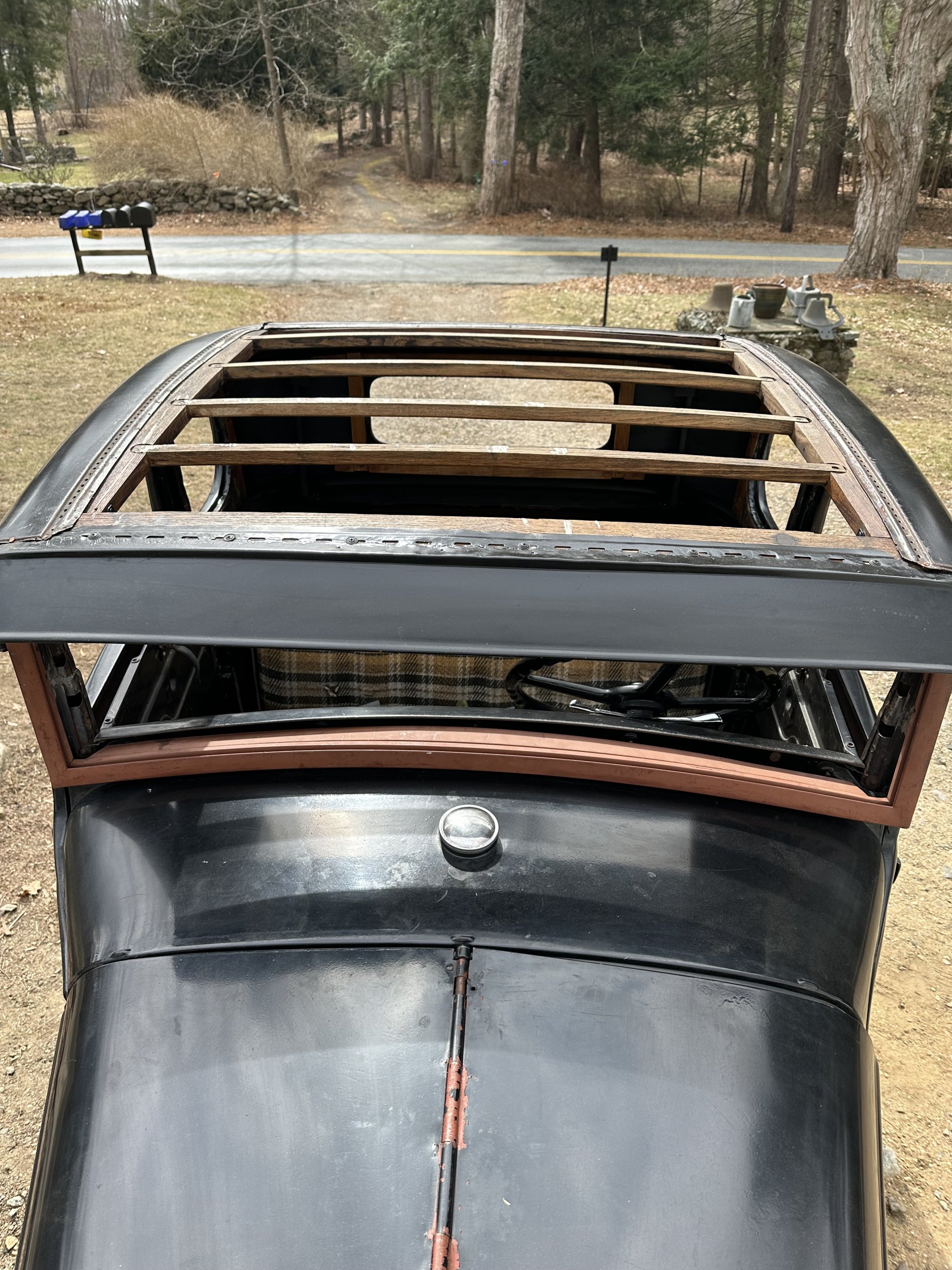

    IMG_3588.jpeg I’m building a model A coupe and am missing the metal that surrounds the roof hole that captures the insert material. My last coupe still had the original intact so I reused it. Either I’m crazy or they just don’t sell it? I can come up with something if I have to but would like the original style if possible. Any leads are appreciated. Thankyou

  2. 31Apickup
    Joined: Nov 8, 2005
    Posts: 3,586
    31Apickup
    Bratton’s or Snyder’s has them.

  3. Karl Wescott
    Joined: Aug 29, 2007
    Posts: 93
    Karl Wescott
    Originals were originally zinc (I think), reproductions are aluminum. There were two retainers, one went crosswise at the visor from rain gutter to rain gutter, the other was form fit from the front retainer, around the back to the other side. Both had an open cross section which allowed nailing through the top into the wood, then sealer added, then use a wood block with a vee cut into it to close the retainer.
    These are no longer being made, however I do have a front one in stock and a rear one in stock . They are shipped rolled up so some forming is needed for installation.
    Very late 1931's may have used the 1932 style retainer with the insert style seal strip. These are not currently available reproduction.
    PM sent. If you get them from Snyders or Brattons great, both are very good people.

  4. continentaljohn
    Joined: Jul 24, 2002
    Posts: 5,814
    continentaljohn
    I have use this kit for years and unfortunately they don’t make the aluminum channel anymore in that size. It was used for landau tops and company stopped production. I know they do sell larger molding that’s used in the RV industry

  5. adam401
    Joined: Dec 27, 2007
    Posts: 3,001
    adam401
    Thanks for the article continentaljohn that’s going to be helpful. And thanks for all the reply’s. Karl Wescott came through for me with the parts I need and they’re on the way.
