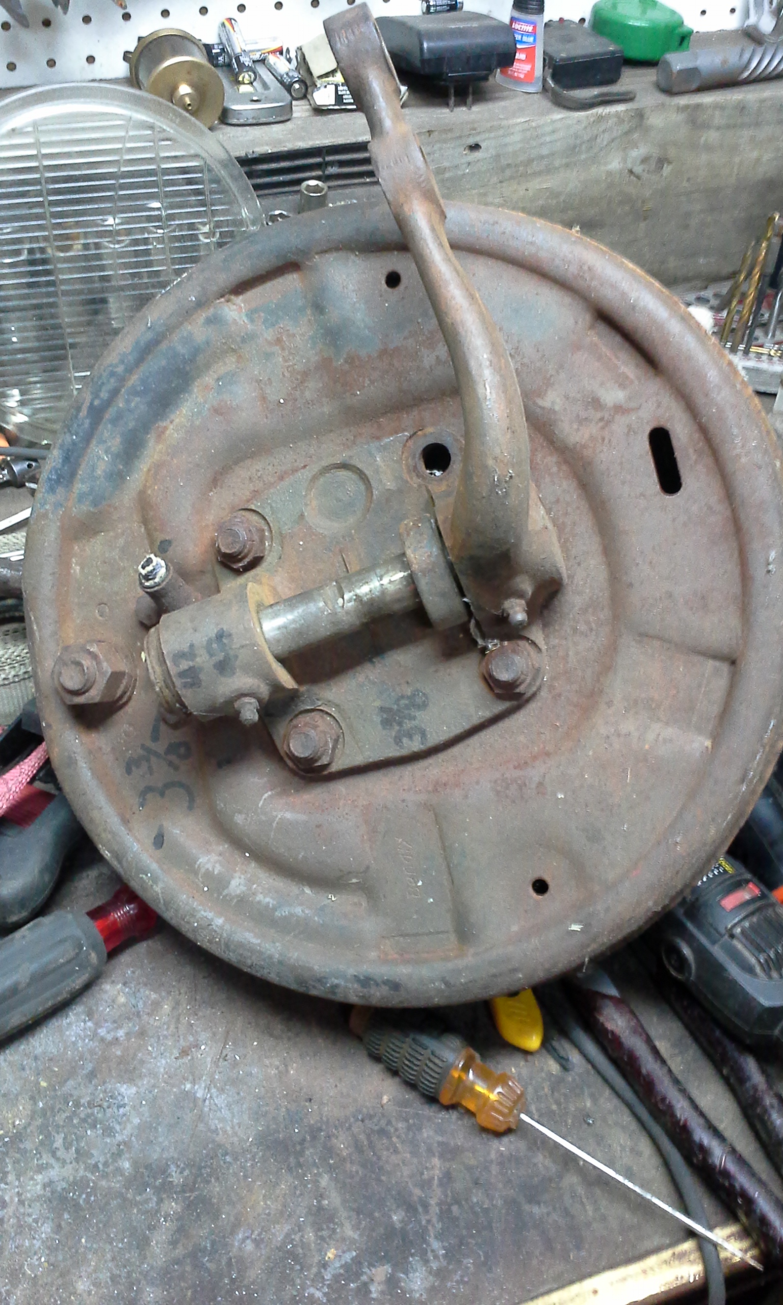

    Is the hole on the 32 different than others? This is the spindle I took off of my heavy 32. I think it was from a 54 Ford Pickup??

    You have a '42-'47 truck or '42-'48 car spindle with an '48-52 F-1 or '53-'56 F-100 backing plate in your picture.
