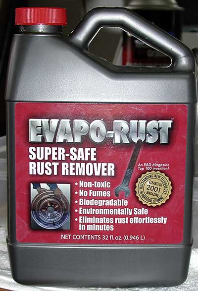

  24. hotrod40coupe
    Joined: Apr 8, 2007
    Posts: 2,561
    hotrod40coupe
    If you are trying to get rid of rust try Evapo-Rust. It really works, is environmentally friendly, and reusable. It is available a Harbor Freight and online (do a google search). it is the best stuff I have found.

  27. jazzbum
    Joined: Apr 5, 2005
    Posts: 598
    jazzbum
    i like naval jelly because it sticks to stuff and doesn't run off as readily as straight phosphoric acid--you can leave it on and let it go to work instead of scrubbing at it for hours. evaporust works too but not as well in my experience.
