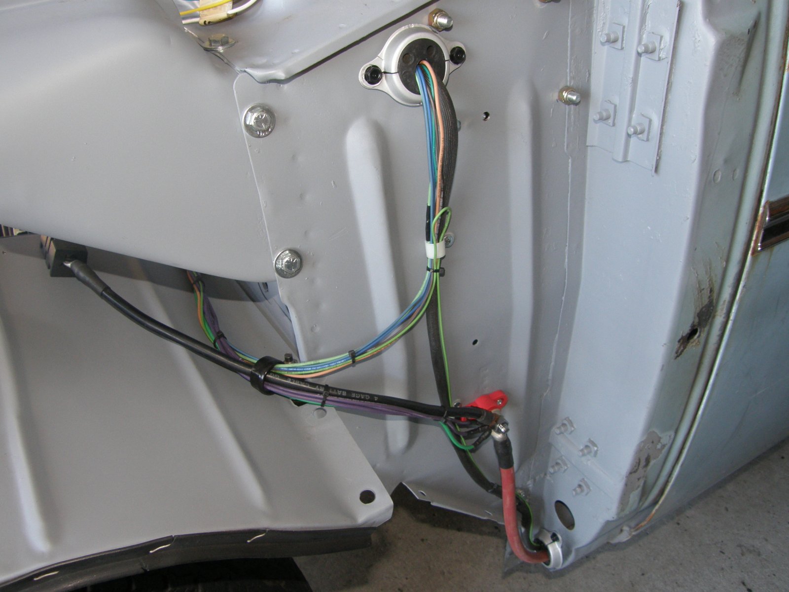

    My batt is in the pass side trunk. I ran 1/0 welding cable all the way up to a power post on drivers side cowl.
    Then a #2 cable to solenoid then 10ga wire to power relays.
  8. Neat relay box. May I know the brand?
