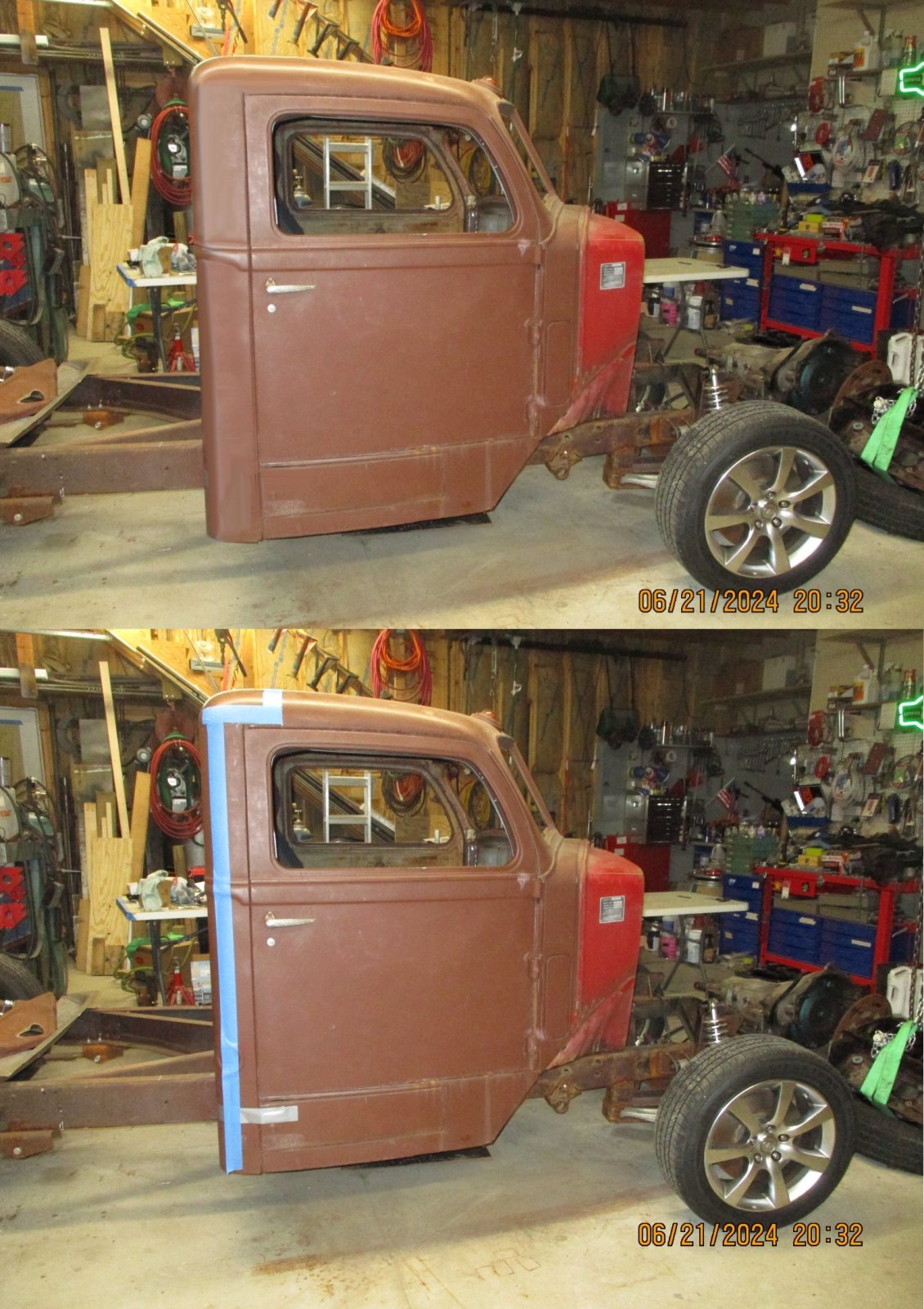

    I haven't started my build thread yet, but I do have a technical question before I touch the cab on my 38 Diamond T. I know that there is plenty of opinion on the forums here about extending or not extending a pickup cab. I have pretty much decided it's the only way we will be comfortable in the cab for what I hope is a lot of travel. I also respect how much ability or the lack thereof I might have to do this but I guess I will learn by doing. I plan on cutting and extending from behind the door post back either 6 or 8 inches. I do not want to cut the door, cowl, etc. as has been suggested to others on the forum many times. I'm looking at merely cutting the sides barely behind the posts, straight up to the roof line and jogging forward about 2-3 inches (because that is where the roof is not crowned in looking across). The cab on this truck has a point where the wedge from the front stops and goes straight back, if only for a couple inches. The doors even have a curve toward the back where it seems to flatten out right before the door post. I have placed some tape on the line where I'm planning on making my cuts. My question after such a long explanation is: am I heading in the right direction or do I need to reset? Thanks to any and all advice. IMG_1026.JPG

  2. I guess you get all the cutting options mentioned due to keeping the cab proportioned.
    I’ve seen some not so nice to look at extended cabs
    I’d make a slice where the best chance of hammer and dollying the welds are
    That’s probably as good a choice as any

    To keep the proportions the same I would go through the center of the doors. It may be more work but it will look better with no chance for blind spots. But your way could work too.

    Having driven many old trucks, my experience tells me that if you extend that cab back 8" to 10" from the point you have the front edge of the vertical tape, and you slide your seat back into that area (the purpose of extending the cab), you are creating a huge blind spot on both sides of the truck.
    Your head will end up being completely behind the "new" side of the truck and you won't be able to see anything on either side of the truck without leaning way forward. Your field of side vision will end at the back edge of the door window. The rear facing window in the cab won't help with your side vision. If a car is on either side of you but behind the door window, you won't be able to see it at all. If you come up on a stop sign on a road at anything less then a 90 degree angle to the road you are crossing, you will not be able to see anything at all on the that cross road on the sharper angle side. You may not even be able to lean far enough forward to see anything.
    You can test this pretty easily if you can sit in the cab currently. Simply put a sheet of paper how ever long the section you are adding to the cab length to the back side of the door window covering the door window (if your adding 8" of cab, add 8" of paper on the rear part of the door window). Put the paper over the back end of both door windows. Then sit with your seat back against the back of the cab. What ever side view that piece of paper is blocking, the extra length of the cab will also block. Have someone stand, or place an object at the farthest rear point you can see on each side. Then mark or have someone stand at the farthest forward point you can see looking through the back window of the cab towards both sides. Everything between those two points on each side are blind spots in real life. If you need to get out of the cab and view size of the blind spots from outside of the cab, do it!
    Then tell me how much will you will enjoy driving the truck without being able to see that much area to either side of you?
    Now you can see why guys are putting windows in those cab side extensions. If you consider adding a side window, that could change where you might want to cut the sides of the cab.
    The other option may be exploring a shorter steering column, repositioned seat (higher, lower, more upright), different seat, or modified floor, to gain more space. Old truck cabs are just smaller then modern truck cabs.

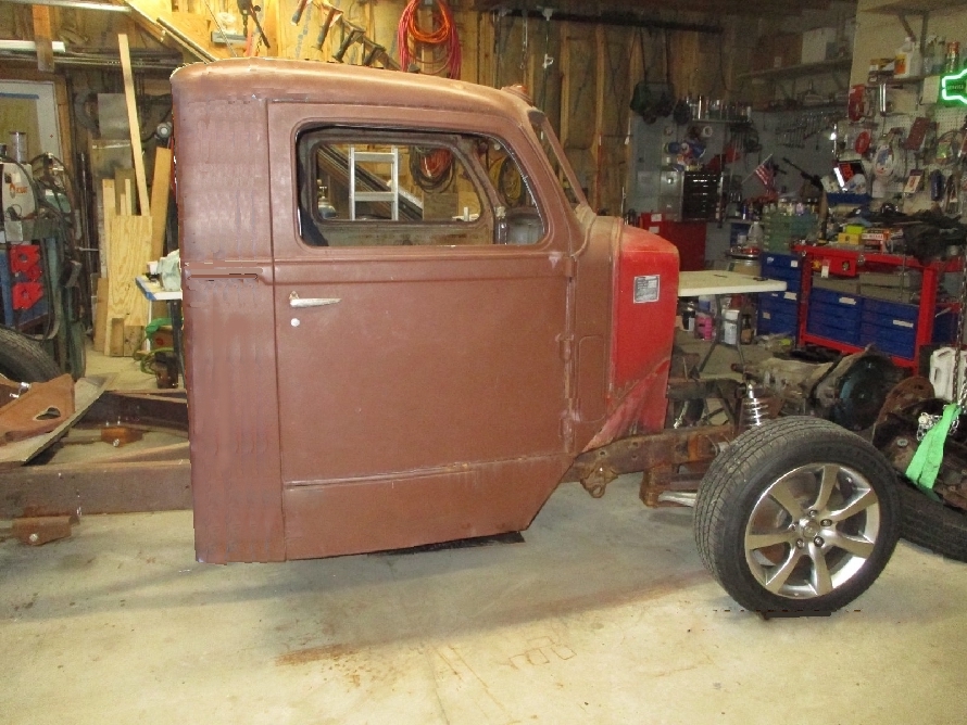

    @StreetKruzer
    Maybe this will give you some idea of how it might look.....
  10. StreetKruzer
    Joined: Jun 24, 2024
    Posts: 21
    StreetKruzer
    Thanks themoose! Is it stretched in this pic? I can't tell a difference other than the tape gone. I think I have to go at least 4" to get a difference in comfort. I already tried with the seat in, problem is coming back with the firewall enough for a 6.0 ls really jams into the floor area, and I'm 6'.

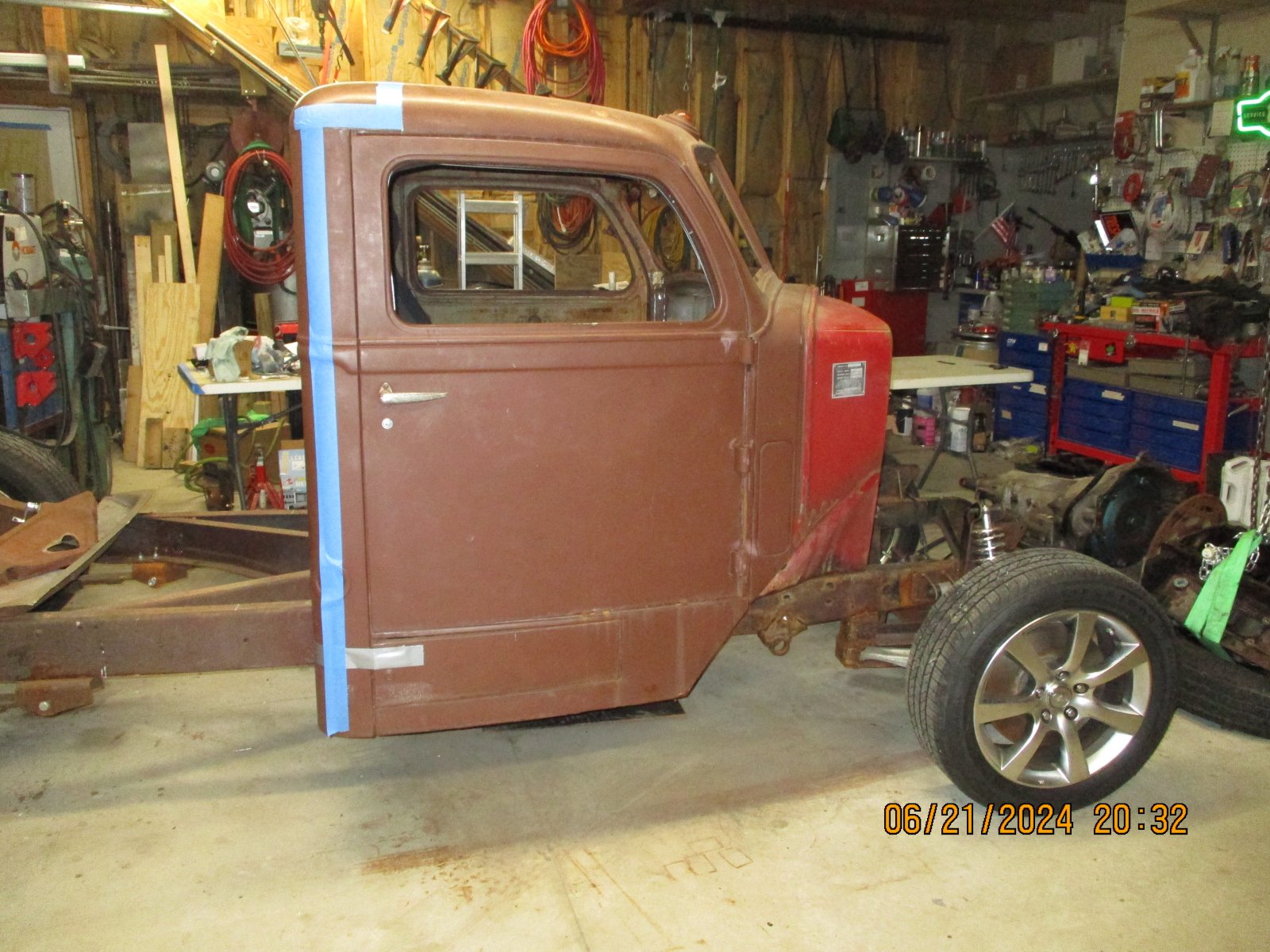

    Yes it is..Here's an image if showing where the tape was on the original picture

    I don't see where you added 6 to 8 inches to it?
  14. StreetKruzer
    Posts: 21
    StreetKruzer
    I'm thinking about 1"?

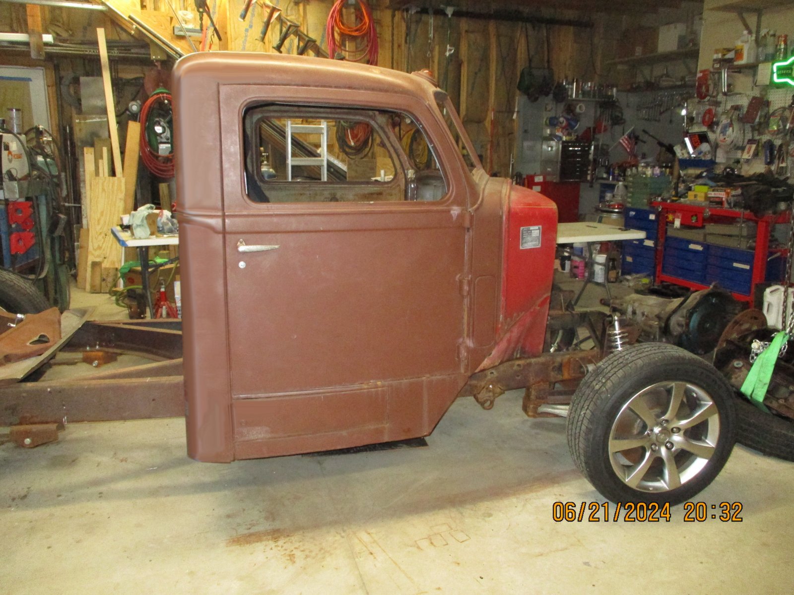

    Sorry Moose, but by the looks of the two pictures squirrel posted, it looks to me like only about 1/2 the width of the tape was added to the length of the cab. If the tape is 2" wide, the original cab extended about 5" behind the door, a 5" extension should have at least doubled the original length. The OP was asking for a 6" - 8" extension. I used the trusty pointed end of a ball point pen to measure the distance between the back of the cab and the back edge of the door as a measuring stick for all the photos, and ***umed the tape is 2" wide. The OP has the advantage of actually measuring the original distance between the back of the door and the back of the cab, then adding however much he want to extend the cab. I'm betting what is now 5" to 6" is going to be 14" to 15" with that 8" extension.
    That is going to change the look of the cab pretty dramatically, and is going to make my 1st post here important.

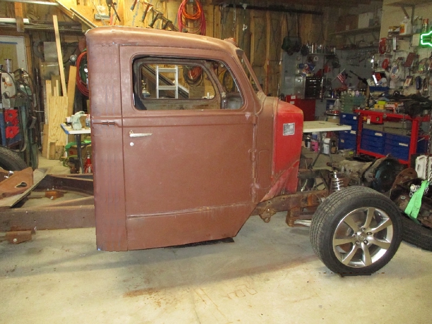

    Rot & Kustom just did some photo shop for me. Boy are you guys great. I'm thinking the 4" gets the most room without chopping anything else. I'll have to see how the comfort is when I put mock it up after the cut. What do you guys think? That's 2", 4", and 6'. Cab 02 wide.jpg Cab 04 wide.jpg Cab 06 wide.jpg

    I think that 4" looks pretty good, hopefully that will give you enough room!

    That's what I'm hoping. Doesn't look out of proportion to me and maybe enough room to be comfortable.
