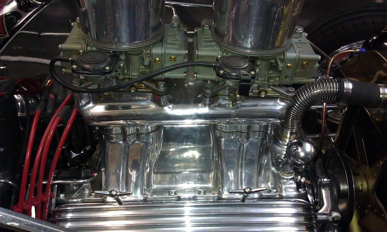

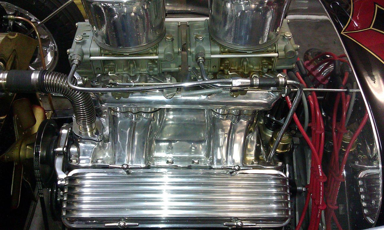

    OK....lots of things to start with.
    I should have prefaced the thread first off by stating this car is near a museum piece and only minimal (mostly non visual) changes can be made. It was built and completed in 1971 and other that the tires/wheels and swapping the 600 Holleys for the 450s is ALL original to when it was built. So no changing the tunnel, the distributor, adding additional coolers, fans, linkage etc. This may limit the options but so be it I have to work within these constraints to keep the car as original as possible to when it was built.
    Here is the thread I posted a few years back detailing when where and how i got the car. http://www.jalopyjournal.com/forum/showthread.php?t=381399
    When we got this car back and began this process we discussed changing the converter when we had the transmission out. However, given it only has the smallish ****** cooler built in the radiator those who suggested it then retracted thinking the transmission could more easily overheat. So, we opted to leave the stock one in. It does ok with the stock one, doesn't load the motor at an idle too bad that I can see. I agree it would most likely help a bunch getting the RPMs up to get a super smooth start right off. But unless someone can convince me it won't add a bunch more heat and cause other issues I'm sticking with the stock one.
    Like I mentioned in one of the earlier posts I had to fit a 1" spacer plate under the front carb to get the vacuum reading at idle. Never intended on running it with the gauge on it. I see how that could be a good source of info moving forward. I would have to have a port drilled, either in the baseplate of one of the carbs (preferred) or in the intake (probably not going to happen on the intake). If we put the port in the base plates, where should it be placed?
    Here are a few pictures of the setup:
    Drivetrain was originally taken from a 1964 Impala, engine, ******, rearend. All stock other than the list in my first post.
    It has backfired a few times, especially when it was cooler out or when it fouled a plug so power valve(s) could be blown.
    Your continued input very much appreciated.
