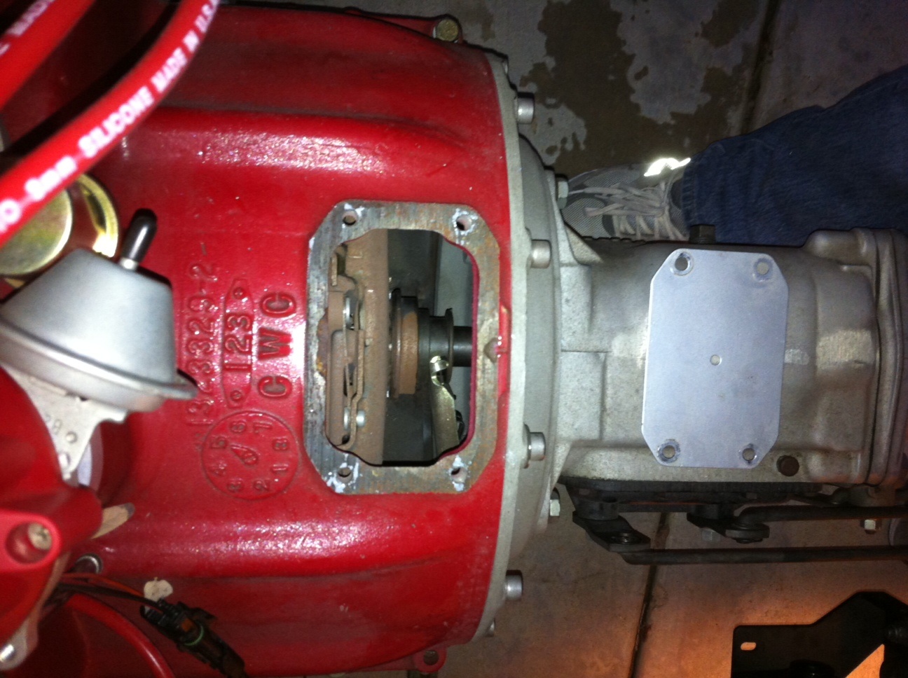

    For some reason I can only attach one pic at a time. So here's pic number 2

    Good idea. Not to be a smart ***, but it sounds like you might need someone to guide you through this. In the second pic., it looks to me like the throw out bearing is not engaged very well in the fork. Also, it looks like this ***y. may have been sitting for a while, cuz of the obvious rusty parts. May make sense to take trans out and inspect everything. I really can't see clear enough in the pic to determine if there is even a pressure plate in there, maybe that is why the fork is so easy to move back and forth.

    This engine and trans were just rebuilt not too long ago, it's just been sitting under a car port for a few months. The rust isn't as bad as it looks in this picture.
    There is a pressure plate in the their, the clutch fork slides back in forth really easy, probably 1-1/2" throw, when I push the fork all the way forward until it stops, I can then go about another 1" forward and that has a decent amount of tension on it.
    I just want to make sure that first picture is what it looks like when I push in the clutch.
