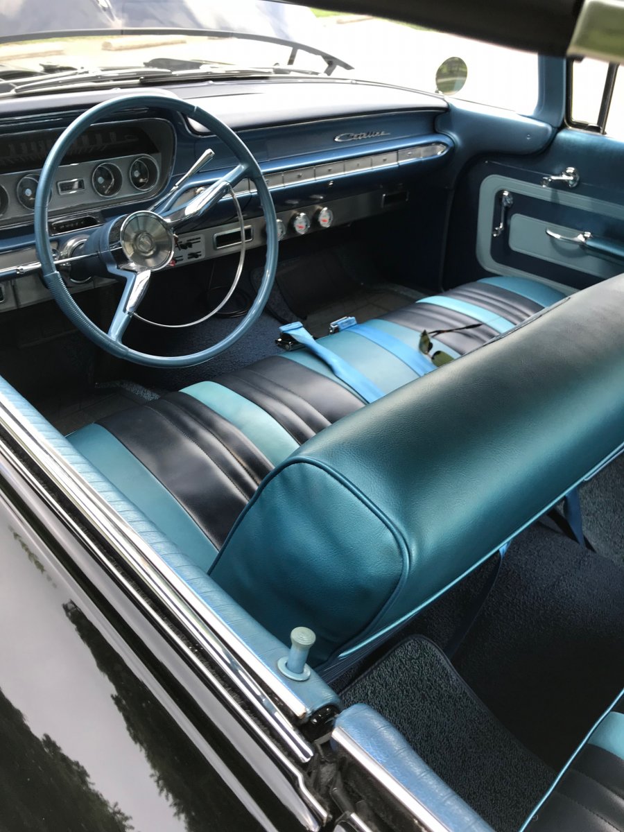

    WgL%60TCSLCkfNFFjNkKNQ.jpg Myrick, I built an extension for the lower dash on my 60 Pontiac that houses the A/C controls, vents and engine gauges. It also hides the A/C evaporator and ducting from view. You can't see it can you? It looks like a car without A/C. Thats what I meant by saying thats what 2020 technology looks like. Or would you rather be staring at a fugly A/C unit hanging on to the front of the dash? I have to admit I do like the Art Deco look of the unit Squirrel installed.
    olscrounger likes this.

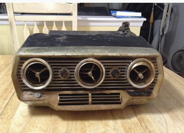

    3553B72B-6EE3-4E3D-9422-2AC0AEC76697.jpeg F0C2BCB6-F694-4BE3-AA11-69EFAA1F4EDB.jpeg
    I have a Sears under dash unit I’m saving if I ever put ac in something of my own. None of my rides have AC or radios one doesn’t even have heat and has manual wipers.
    If I ever build my merc, I may attempt to use an electric unit like you see on an electric car to keep from having a compressor under the hood and vent it similar to a 50s Lincoln.
    Like these
    68D3C574-6BB5-401B-8EE8-4F9B4F68D3B9.jpeg 5B0FCE81-BB83-4305-9D81-2648216DAC1B.jpeg
    My current ride is a short bus and plans are for a mini-split heat pump and run it from an inverter.
    Nothing under the hood and hid under the factory heat unit. Some creative sheet metal work will blend it into the roof for the evaporator.

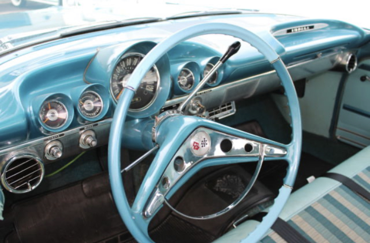

    Myrick, the car I built just before the Pontiac was a 63 Chevy Impala with a Vintage Air Sure Fit Gen lV system whose evaporator stuck out in the front of the p***engers seat like a sore thumb. Even the wiring always staring at you as it was extremely visible. Once you install the VA unit in that 59 you'll see what I mean. Chevrolet dash boards do little to hide anything as they don't come down very far and everything is wide open and visible. VA does offer several different styles of control panels. The better they look the more they cost. One of them with the electonic automatic temperature control has a price tag of over $400.00.
