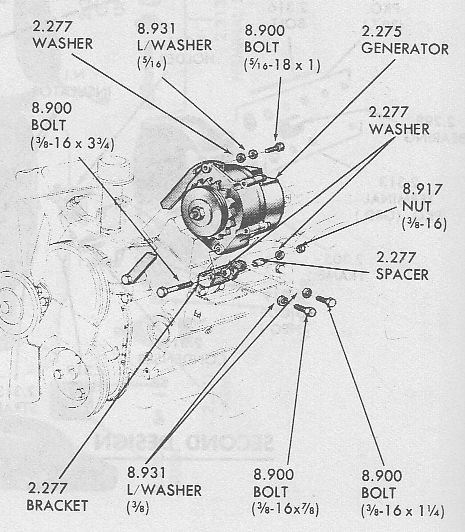

    I have a set of the Corvette ram horn manifolds from Speedway and want to run LH alternator & RH A/C compressor. Does anyone have pics and/or know where to get some brackets that will work? The pictures in the Corvette resto parts catalogs have been no help. The bolt spacing on the LH manifold is 3-3/4" & the RH is 4-1/2".

    Checked the site out, but they don't seem to carry stock style brackets, only universal type. I'm trying to stick with stock style brackets on the engine. Thanks for the link though.

    this is how things were put on the passenger car engines in 1963 or thereabouts.
