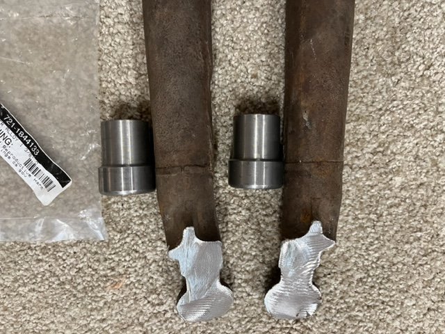

    I just happen to have a pair of 1940 ford front wishbones for sale on here they have the stock 40 front hangers that are easily chopped off and the fellow I bought them from spilt the 1 piece wish bone right down the middle of the center and wishbone ball. I have the HD weld in inserts (3/4" fine thread) that uses GM HD tie rod ends just like the CE spit wishbone kit and the space between the front yoke is 2 1/4" (stock 40 ford) asking $100 for inserts and both split pieces close up threaded  insert for .75 in GM tie rod.jpg end view of where thread inserts should be welded.jpg radus rods split with threaded bungs.jpg
