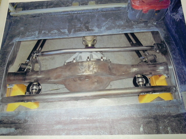

    I wasn't trying to impress anyone but myself, they will have to lift my trunk floor to fully appreciate what this cost.
    Have an all aluminum engine too, you don't even want to ask what it cost.
