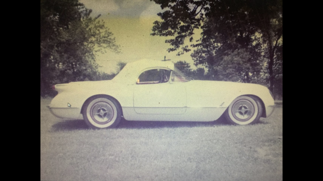

  28. Trent R.
    Joined: Apr 27, 2021
    Posts: 59
    Trent R.
    Thank you all for your input,
    This is in fact going in a 1954 corvette with a power glide. As for the cam we’ll probably end up going with the Duntov, I won’t argue the fact that there are more efficient cams out there for the money. Grandpa is 82 and just wants the car to be a good cruising car in town. He also is trying get the car similar to the 55 corvette he had in high school thus the early 60s circa treatment on the 283. We attempted to track the 55 down but it is now in El Salvador as of 2011. Looks like we’ll also have to look into some dodge lancer hubcaps.
    Again thanks for the advice,
    TR
    Grandpa’s 1955 Corvette Circa 1961
    Budget36, 427 sleeper, raven and 2 others like this.
  29. guthriesmith
    Joined: Aug 17, 2006
    Posts: 12,074
    guthriesmith
    That was a cool car your grandpa had! And, very cool that you are trying to help him with another one. :cool:
