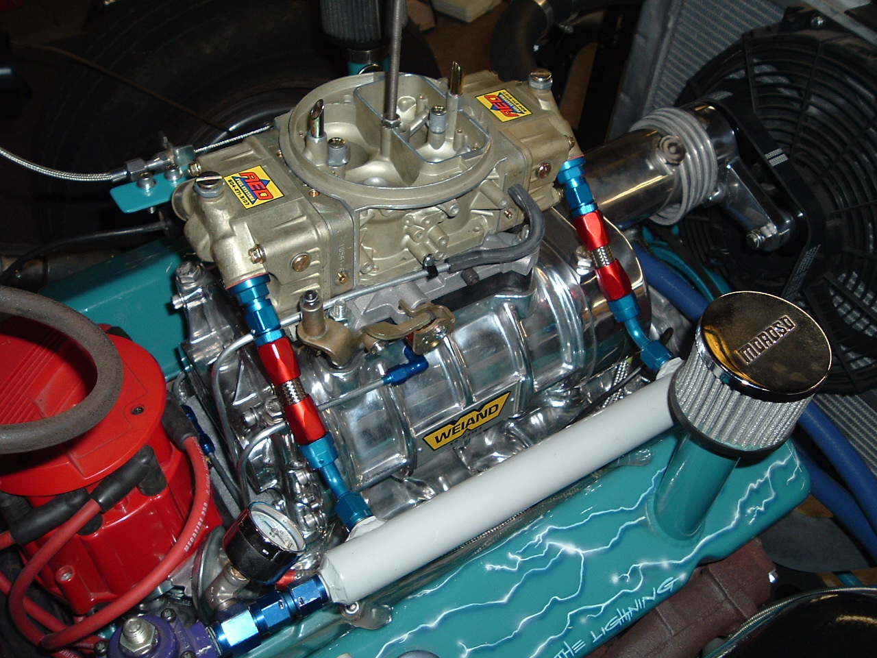

  10. woodywagon1965r
    Joined: Feb 6, 2010
    Posts: 351
    woodywagon1965r
    Running a sim setup 174 weiand on a 306 sbf this is what worked for me
    750 demon mech sec check your power valve.. if like mine va*** reads 8lb at idle i went with the 6.5 powervalve ......jets ..well i put a wideband gauge in the car and dialed in in that way you want the AF to be in the mid to low 11s under full throttle i dont like mine to go much higher than a early 12 AF
    this setup has let me drive everywhere better to be a little rich then lean
    and post a best so far of 11.7 at 118 leaving the line light MAKE sure your timing is not too much mine is set at 30 full advance unless you have a boost retard this is the safest way 10 to 1 is a little high comp i am 9.58 so in the same boat and run good fuel.. driving 2 hrs to the track i do run 91 oct but never floor it once closer to the track i put in 94 oct and good to go any other help let me know you will love this little blower it really wakes up when set right
