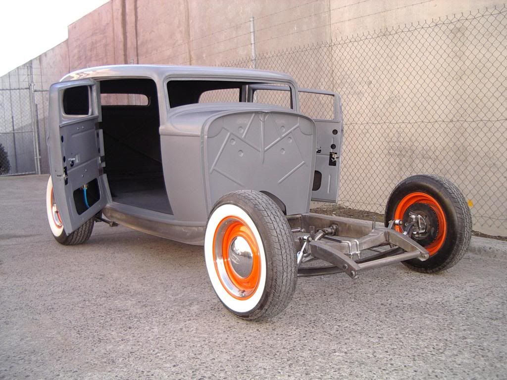

    Anyway, I shoulda posted the pics first; I know. Truth is, I was just too lazy to post all of them to Photobucket. But, with all the replies, How can i possibly disappoint?
    Here it is. I don't have the X member in yet. Just have boxed rails and the front end installed. I have designed some 4-link brackets and bars and am going to use Currie's Johnny Joints instead of Heims or bushings.
    The Rails are JW Rod Garage and are about 1/8" thick. The fish plats are all 1/4" and the boxing plates are all 3/16" Overbuilt? Probably. Worries? Probably not. I hate doing things twice.
    Money IS an object, but I'm spreading this over a couple of years. The body is on another frame, so disregard. Mine will be a lot lower.
    I'm about to pull the trigger on a mock-up block and a Tremec 6 speed. But then it's fab, fab, fab while i pay the bills and let the money tree bloom again.

    I just don't visualize that sedan as it sits in the photos with a blown big block or hemi in it. Blown and honkin engine in this hood usually means those 16 inch wide tires on the back and those B word wheels on it. That thing would be sweet as hell with the 331 Desoto Hemi that I have out in the Milk house with a pair of 4's and a 4 speed behind it. Or an Olds, or Cad ohv dressed out in it.
    It sounds like the whole concept is taking a pretty sweet almost HAMB poster car and making something else entirely out of it.
