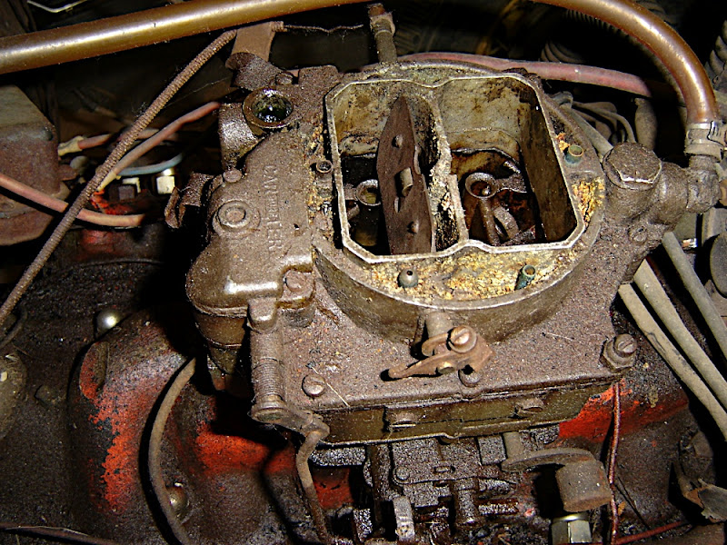

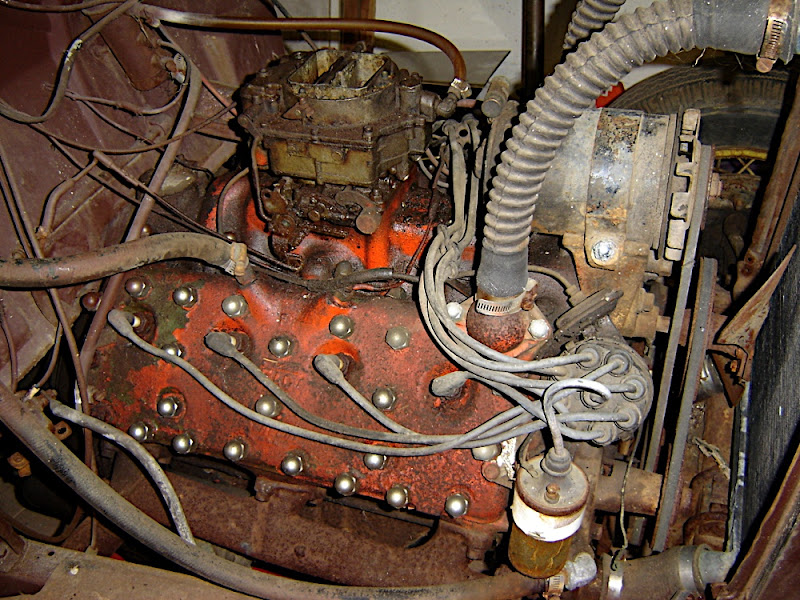

    ...and how much should I be asking for it?
    I am pretty positive it is not original to the car ('32 fordor). If it's worth something I'll get rid of it (to help fund the car). If not, I may just tear into it to and look around. I love the old Carter on it.
    Let me know if you need better pics or different angles.
    Thanks.

  2. The motor is 48-53 vintage. The heads look to read ?CM, that is the desirable Canadian Mercury. Already has a 4 barrell. I would rethink that move, this motor would be cool as hell in a 32 anything.

    Its either a Ford 8BA or Mercury 8CM, both late model Flatheads.It will say either 8BA or 8CM on the cylinderheads.I think this model of Flathead first saw the light of day in 1949(Could be wrong)

    Above the center bolts on the head is an "F". Below that in large letters is "EAC" and just above the "EAC is a tag that reads "3222".

    That intake and carb is a hot setup. Hope you can find a tag on the carb.
  6. Cm heads would be the Canadian Merc motor, that had the crank with the stroke everyone is looking for. If they are CM heads the next to do would be confirm the crank stroke. Pull head or pan to confirm by measuring. If it is a Canadian Merc they were produced 48-54, production in US stopped in 53.
    I don't know, I would be hard pressed to remove that motor. Someone did alot to get it in there, There is even and old vintage electric fuel pump on the firewall

    Can't find a tag on the carb but it looks like "WCFD" is cast in the front of the body under "Carter".

    EAC is '52-3 Merc, though heads don't necessarily match innards. Nothing Canadian in anything mentioned here...C for Canada goes at beginnings of year prefixes.
    What's under the carb...is it on an adaptor, or is that an actual iron 4-barrel manifold??

    WCFB probably. corvettes used them, a**** others.

    It is a Cast iron intake (no adapter), but I don't see any stampings on it.

    Motor and heads have the 52-53 Ford color, but it looks like that was painted over another color. Don't trust the heads to determine if Ford or Merc crank inside. You should measure the stroke to be sure. The motor has the 51-53 narrow belts, but, again, anything could have been bolted on. Remember, the block for 49-51 is the same whether Ford or Merc. Same applies to the 52-53 blocks but they came without the hard valve seat inserts.

    It failed the magnet test so I s****ed some paint off. It's aluminum.
