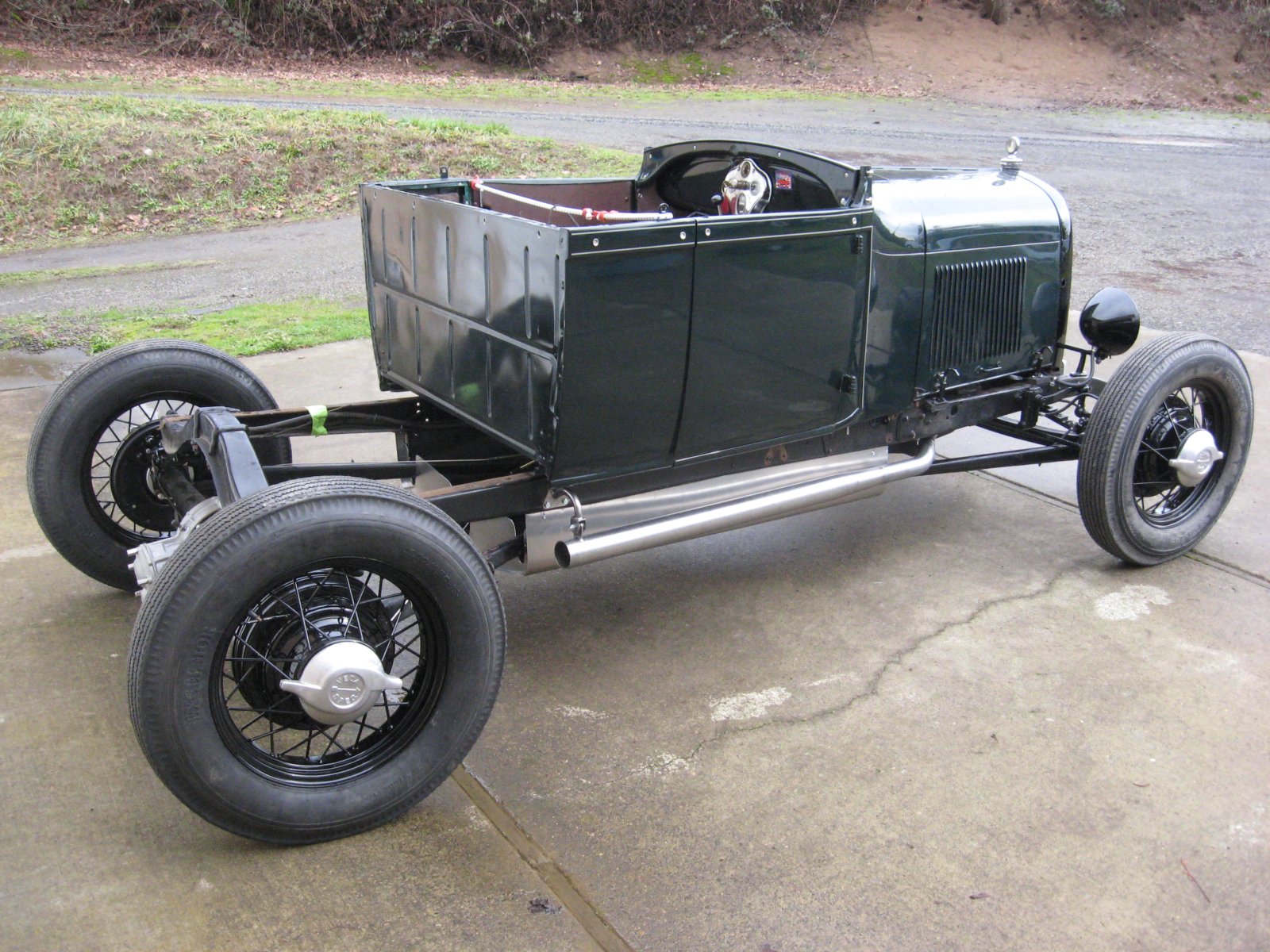

    I did this 29 for a friend, using Charlie Yapp's cast header. Built the pipe using 35-36 driveline. IMG_6167.JPG IMG_6177.JPG IMG_6180.JPG IMG_6205.JPG IMG_6210.JPG IMG_6219.JPG

    Depends on if you are after hp or the kewl drive-in look.
    I did a lot of dyno diddling and found a 4 into 1 with 2 inch pipe and 1/8" reversion dams made the most power at 6000 rpm but my engine had 4 welded in intake ports.
