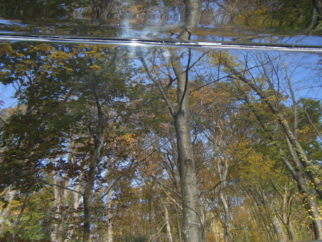

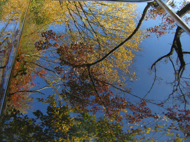

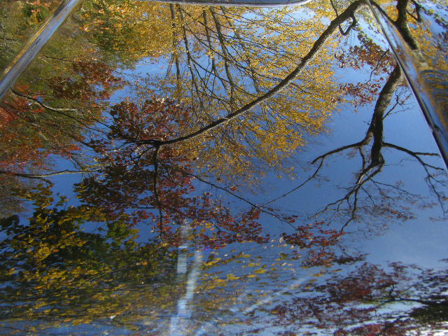

    Everyone makes conjecture statements about DDL but I have the real proof that DDL can hold up for decades in the harshest sun on the planet. I painted a cammo job on on my hunting rig, a 1962 Scout back in 1985. It has never been indoors and has been parked in direct sunlight in the California desert since 1990. These are death valley weather conditions! It hit 123 degrees this summer. Much to my amazement, the lacquer has held up better than any other paint. period! I know, it goes against what we have always heard about lacquer, but the proof is right here. Now, granted, there is no clear or metallic in this paint job. The finish was never buffed or waxed. It dried to a semigloss as you can imagine, and still looks very similar. It has minor oxidation on horizontal surfaces but will still buff out to look great. Urethane finishes are coming off in less than 10 years out here. Another interesting thing about this paint job was that we didn't shoot it as if we intended for it to last more than a couple of hunting seasons. It was a late night party paint job with no consistency in film thicknesses etc with no primer, we shot a light green base coat and then mixed various shades of greens, browns and tans from left over stock. I would image that we under thinned the paint as much as possible to get it from the gun to the surface and still get it on wet for a fast build. Perhaps this had some bearing on the longevity. Lacquer is not intended to be applied this way and is typically shot in many thin coats trapping more solvents in the paint. Perhaps the legends of early lacquer failure has to do with buffing and applying wax before the solvents are all out of the paint, which can take months for lacquer, thereby trapping solvents in the paint? Another interesting thing I've learned about DDL is that it holds up to heat as an engine paint better than urethanes or enamels. Just my $.02.
