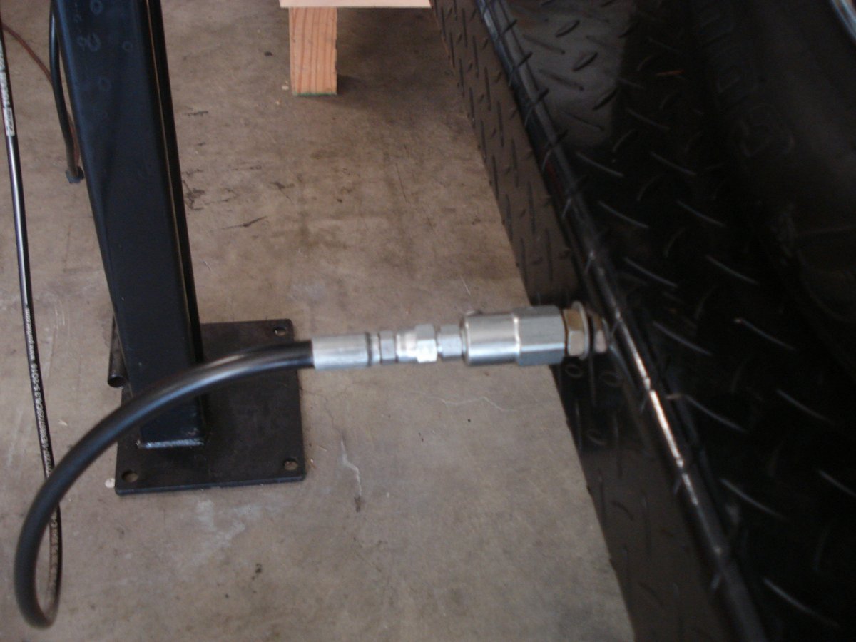

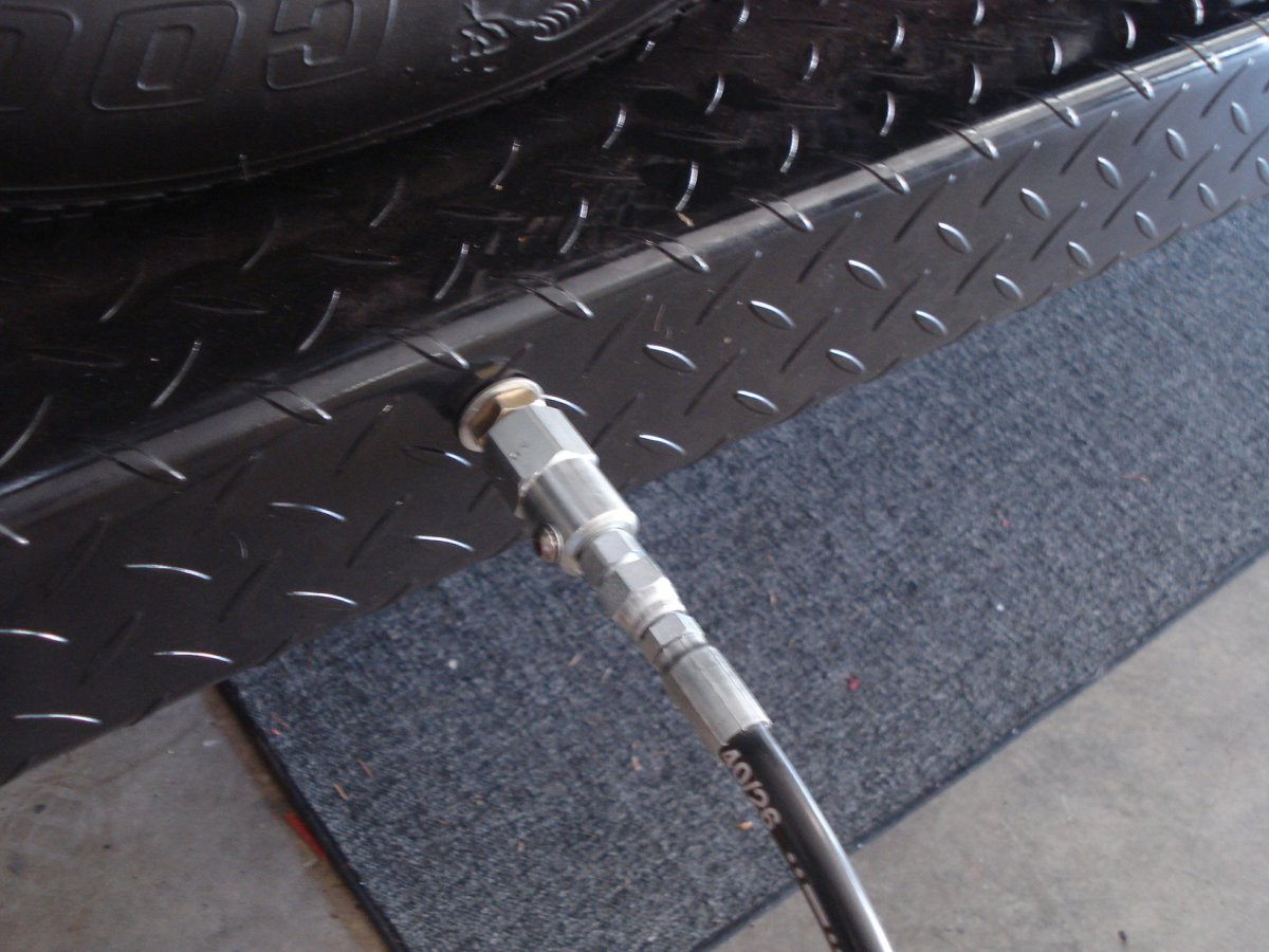

    Izzy: I have the Atlas 8K Hobbyist 4 post and it has served me well for about 3 years. I previously also had a Bendpak 6K scissor lift which I was also very happy with. I am sure you would be pleased with either but I would not be afraid of going with the Atlas unit. The photos attached show a modification I made to mine to prevent the hose from twisting as the ramp travels from the floor to the highest setting. It is a Super Swivel product, 5000 PSI rated which will do the twisting and the hose remains relaxed at all times. I also picked up some 1/2" wire loom protector from Harbor Fright and use that to prevent abrasion as the hose will scrape a bit on the floor in the lower position.
