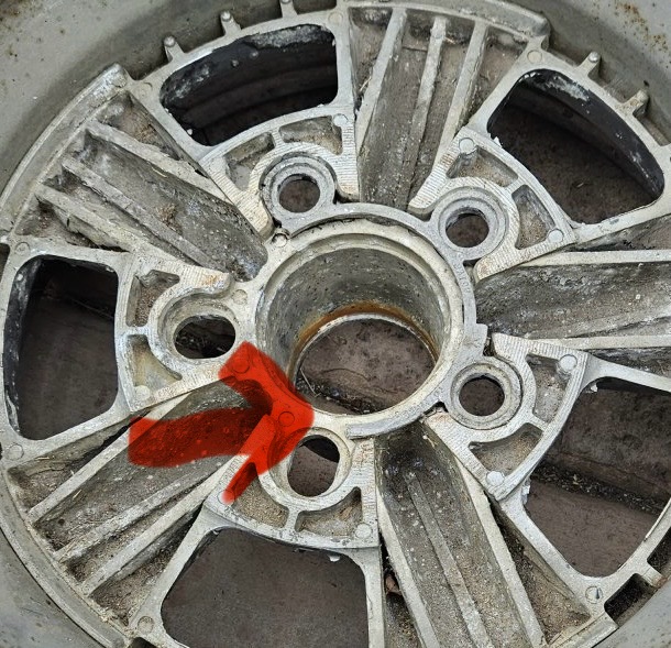

    You need to look at the wheel mounting surface on the back side - earlier Cragar “vari-fit” wheels use a ring that fits into a cavity - you must use those if your wheels are this style or you risk cracking the casting and/or loosening lug nuts. It’s not a problem, you just want to use the right combination.
    Pic (stolen from another HAMB thread of course) shows the cavity and a partial broken vari-fit ring.
    Lots of people bash the various types of multi-fit wheels but most* are fine if correct parts and procedures are used.
