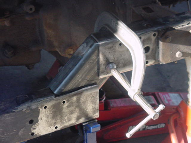

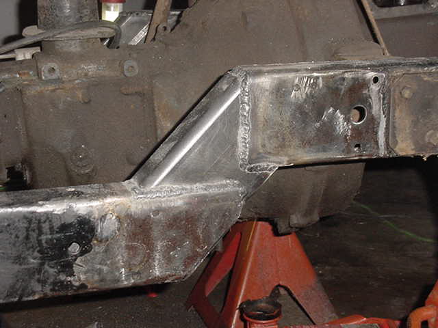

    I did the add in method... I chose this method because I figured I could weld all the way arround it. Also it did not change my wheel base.
    This is the Front "Z" by the way
    Here's a few pics...
