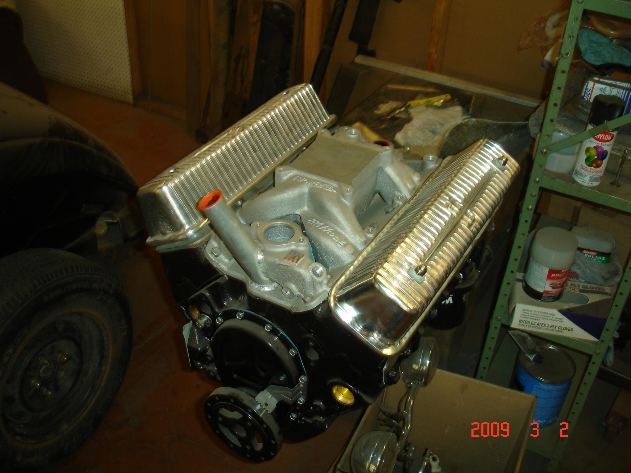

    Hi,

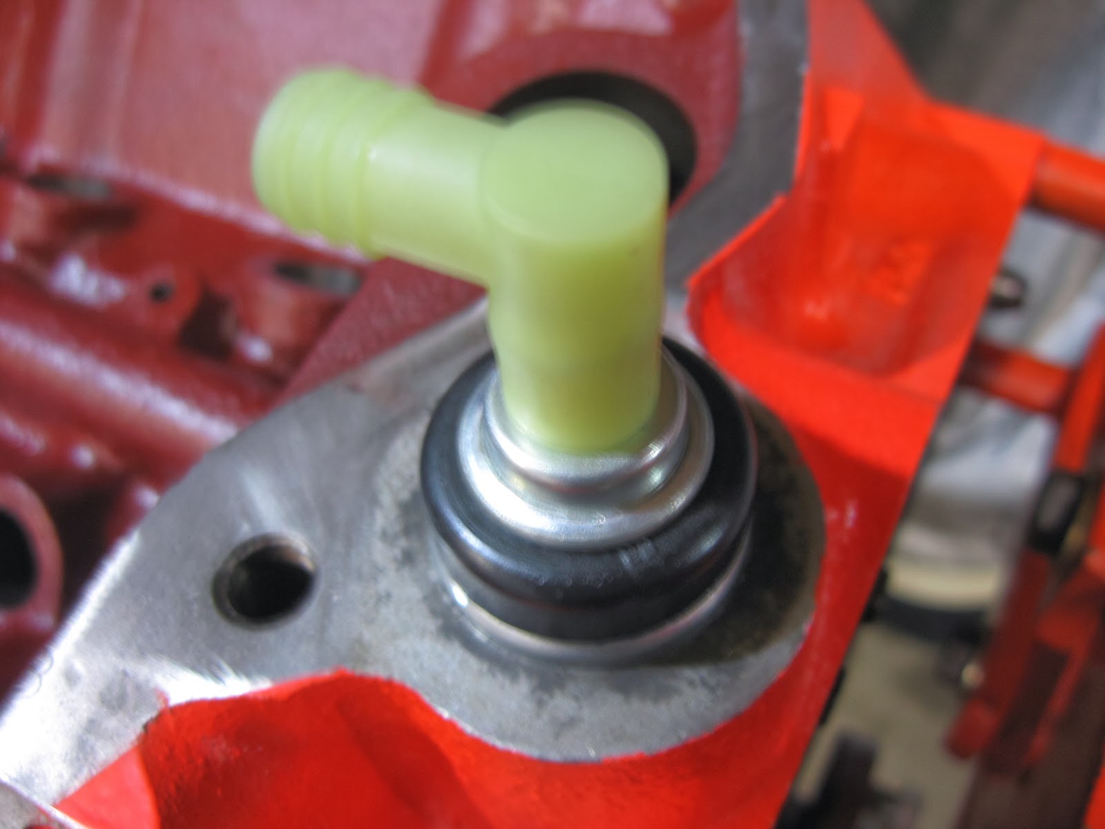

    I have a 1965 327 in the 55 and I am about to machine the hole in my intake for my oil filler tube in the front of the intake so that I can run a set of finned M/T valve covers without any holes. I am going to run a PCV system in the back hole of the block where the road tube use to come out and I have sources an original baffle for the valve valley. All I need to do is select the right oil filler tube for my intake. Some of the oil filler tubes look short and most of the ones on eBay look kind of long. Which oil tube should I use? I am also concerned that the oil filler tube might interfere with the upper rad hose that connects to the rad in the stock location. Do I really have to worry about this? I have attached an original pic of what the motor looks like right now just for reference.

    it's just a tube, buy the long one and cut it down if you need to. the breather cap just shoves in there, there is no lip or anything in the ones i've ever done. there is a couple different diameters too, get the filler in hand before you drill.

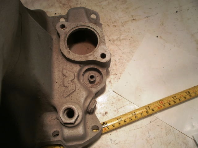

  14. tjet
    Joined: Mar 16, 2009
    Posts: 1,350
    tjet
    1. Early Hemi Tech
    My old Weiand tunnel ram has a small hole where the tube goes - almost looks like a valve guide.
      60.1 KB
      580

    That's the tube I got. It uses a sealed (non-vented cap). The PCV screws into the side. The 66-67 are like that. 68 & up went to the PCV at the valve covers. He needs the 63-65 arrangement (non-FI) - which it looks like he now has as long as the tube cap is vented (IE: breather)

  24. What is the application for this PCV? I'm in the process of doing the same type of set up for my 327. At this time I have a "freeze" plug in the draft tube location with a hole in it for a valve cover PCV grommet. This looks easier.
    BTW, I took an intake oil fill tube and drilled some holes in the OD. Then I welded on a tomato paste can to make my draft tube baffle. Then stuffed in a SS scrub brush. The oil fill tube is the same diameter as the draft tube baffle. Knocked it home and called it done.

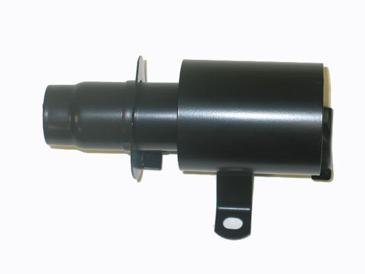

  25. Jay Tyrrell
    Joined: Dec 9, 2007
    Posts: 1,631
    Jay Tyrrell
    I too have a frost plug back there right now and am in the process of setting it up properly. I actually sourced the original oil baffle (pic below) that is supposed to sit in the valve valley and connect to hole that leads to orginal cast hole. I will put the oil baffle in and then run a PCV valve with a rubber grommet just like the picture. The hose will come off the PCV and go to the large vacuum port infront of the carb. When I do it in the next couple weeks I will post pics. You idea of creating your own oil baffle did it work?

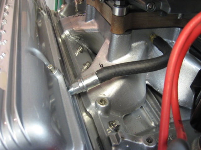

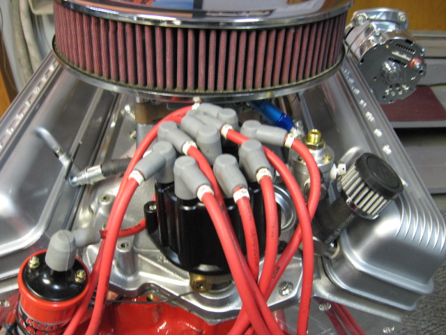

  30. tjet
    Posts: 1,350
    tjet
    1. Early Hemi Tech
    Here is another way to do it using a pair of valve cover spacers. The PCV is the threaded '66-'67 unit. The breather is a K&N
