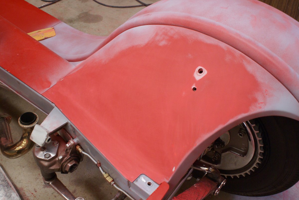

    I totally agree. Because I planned to paint my car red, I used KD red primer and grey KD for guide coat.
    Any re-coating required would guarantee no issues with paint compatibility. The House of Kolor red base coat covered
    really well and the few rock chips that have happened are very incon****uous. DSC05740.JPG
