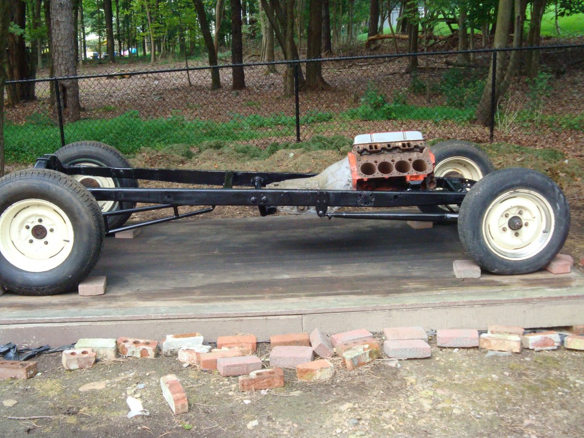

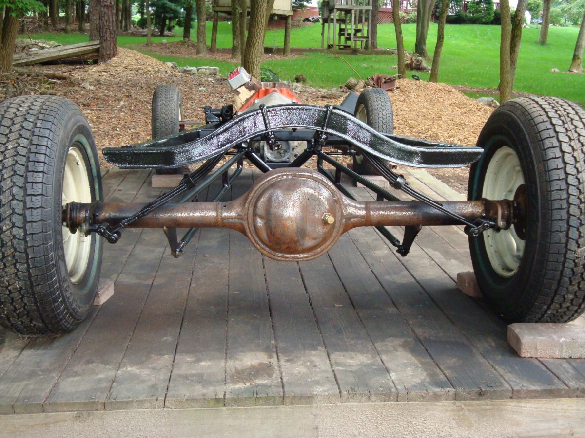

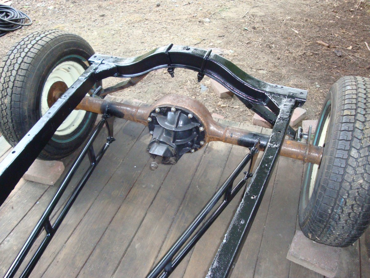

  7. geoford41
    Joined: Jul 26, 2011
    Posts: 766
    geoford41
    from Delaware
    I started a build on an '30 coupe with a 5" frame extension on the boxed stock A frame. This allowed me to use a posie rear 32-48 spring mount with the swivel type mount for the shackles to be able to adjust the drive shaft angle on the rear with home made hair pins that were angled to the centerline of the car frameand a 1 1/2" square tube cross mount. This was of course on a 9" Bronco rear open drive line . If I had to do it again I thnk I would have flipped it over and shorten the frame with spring in front of the axle centerline like a lot of the real early guys did to get the car lower. My coupe was going to being channeled 2 1/2" so floor was going to be fabricated anyway. I used a Speedway Medium arch A spring, the reversed eye stock A spring was too long with the 9" Bronco rear, it put the backing plates & hanger too close so I used a shorter spring. Unfortunatly it moved on down the road to another builder in Jersey when we moved to an age restricted community in DE. the mounts shown above tend to Jack the rear up too much, unless you "Z" the frame 4"-6"
