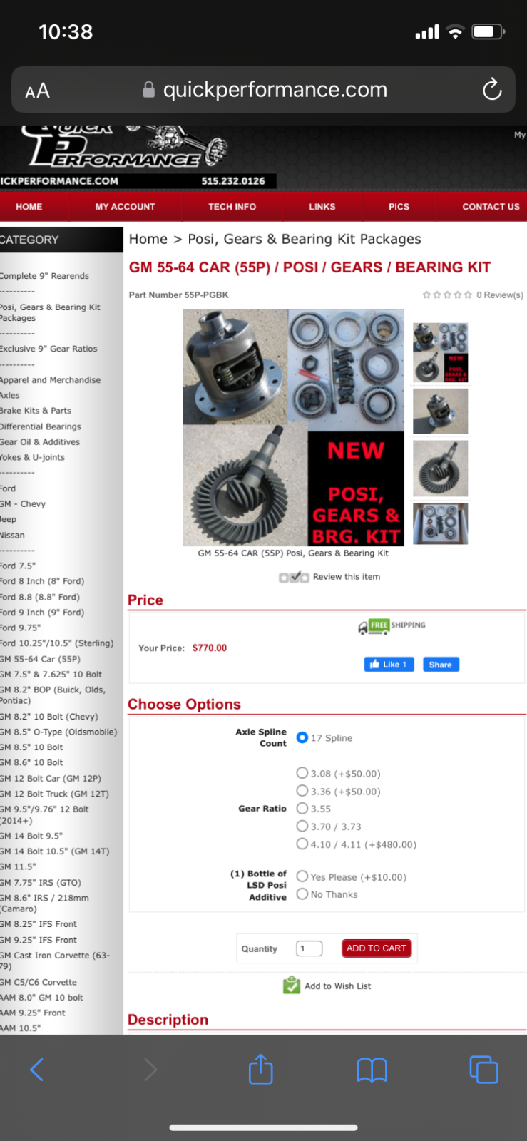

    I am keeping my eyes open for the major parts to piece together my coupe and needed to tear my rear end apart to determine gearing so I can select an appropriate trans.
    Long story short I have a 55p rear differential with 3:36 gears and posi .
    Since I had to blow things apart to determine this I figured I might as well clean everything up and ***emble good so I dont have to double back when I actually get started on the car.
    Now to the question, I ordered all the goods based off a 58 corvette cause This axle came to me stripped of all mounts and I was just guessing based on what I could figure out. Everything came in and so far everything looks correct(wheel cyl. adjusters, seals etc) short of the shoes are 11x1.75" instead of my old ones are 11x2". What vehicle would have the 55p rear end and use the 11x2" shoes in the rear? Looks like the BelAire used 11x2" up front but with the same drums?
    Can I use the 11x1.75 in the rear with these drums, or what can use to source the 2" ones?

  8. BrokenOx
    Joined: Feb 6, 2024
    Posts: 22
    BrokenOx
    from Michigan
    Ok. thanks for everything so far.
    I was unsure of this rear end and based on my research I found that its an "early" 10 bolt. With the drop out center section. Bearing plate axle retainers not c-clip. 17 spline axles. And I believe 8.4" ring gear.

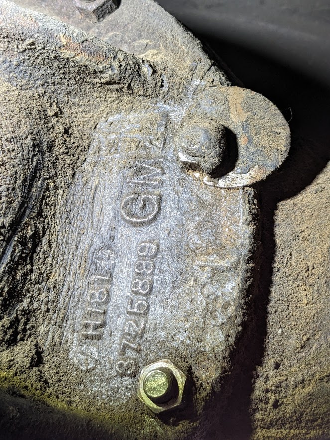

    So casting looks like:
    A134
    3789812????
    Algoma56 likes this.
  11. squirrel
    Joined: Sep 23, 2004
    Posts: 60,068
    squirrel
    January 1964. What about the stamping on the other side of the front of the housing? That will tell what gears it came with, etc.

    Do you mind explaining how you deciphered that?

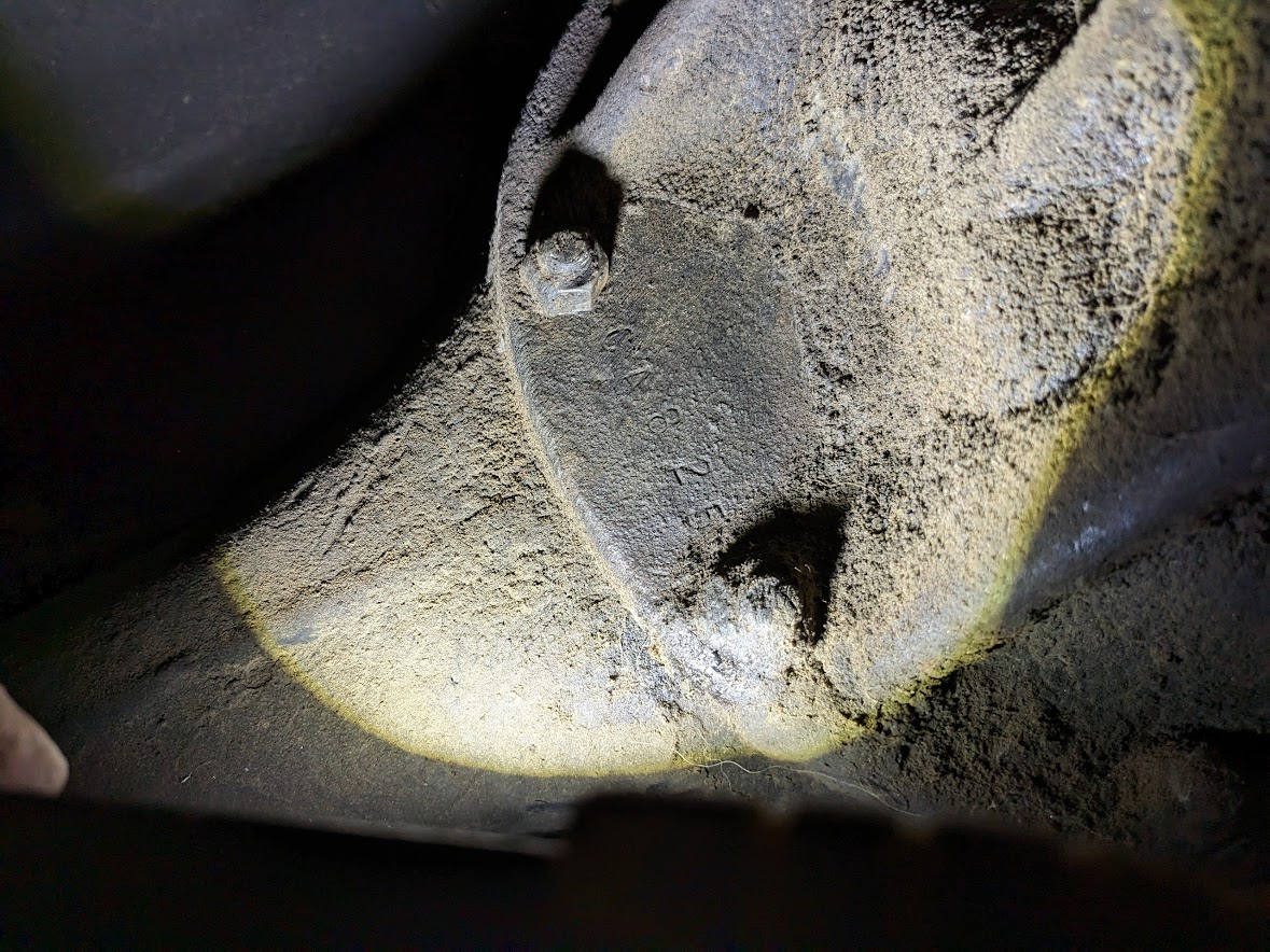

    Chevy casting dates have one letter followed by two to four numbers.
    A is the first letter of the alphabet, which is the first month of the year in the code. So January
    13 is the day of the month
    4 is the last digit of the year. We know that that part was only made from 1957-1964, so it must be 1964. Also they sometimes used two digits for the year, so you have to kind of get a feel for how the numbers work.
    I wonder if it's an over the counter (from the parts department) housing? to account for no stamping on it.
