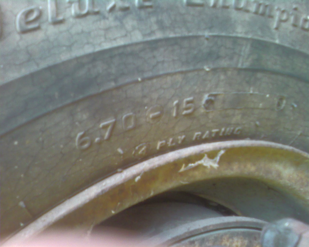

    No idea but all things eventually deteriorate / break down over time. Case in point circa 1990 I commenced restoring a 66 GTA Fairlane convertible after it was imported from the US. At this time the rims were fitted with four (4) new WW radial tyres. When I'd finished the restoration I refitted these tyres and commenced driving. Not long after the tyres commenced to separate. After the second blowout I cut the sidewalls of the remaining [good] tyres with a box cutter and noticed fine cracks where the tread joins the case. These were new tyres and placed on the shelf until I'd finished the restoration. It was a weekend and not daily driver.
    In 2004 I bought 4 x new radials for my 35 Chevy phaeton when I put it on the road. Early this year I had a blow out on the front when the tread separated from the case not far from home. The car has 35k's on the odometer being a weekend and not daily driver. I looked at the case where the tread joins and saw quite a few hairline cracks. I then checked the others and saw similar cracks so I removed all four (4) tyres and bought new ones. I ran a box cutter through the sidewalls to prevent them being reused. Better be safe than sorry IMHO as it was only a matter of time before the others went the same route. I erred on the side of caution and didn't put a price on my safety and that of others. If they'd only gone flat I wouldn't be too concerned however I'd suggest looking for any fine cracks in the side walls, tread and case.
    As an example these are the tyres that were on my 46 Olds when purchased. Very old with hardly any miles as car had been sitting.. Starting to show signs of age. Could have cleaned them up and sold but didn't want to run the risk. Look at the side for the date code (Manufacture)
