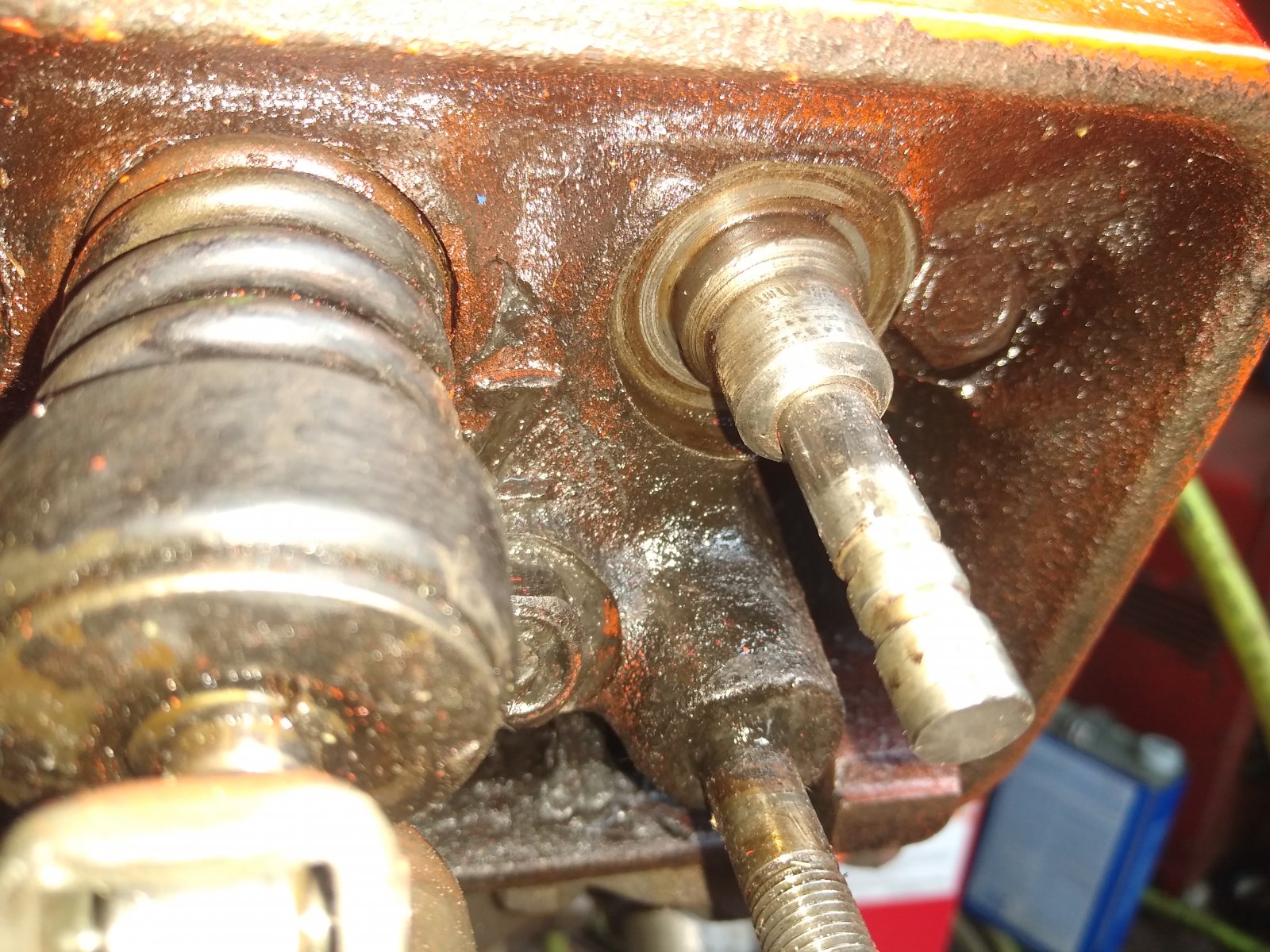

    SBC head casting 3917291, guide boss is about .580, 11/32" valve stem. It had umbrella type seals that were hard, cracked, broken and were hung up in the double valve springs. IMG_20210724_090109474.jpg

    There were no O-rings on the valve stems, but I am in the process of removing the old umbrella seals and installing the o-rings. Only 12 more to go.

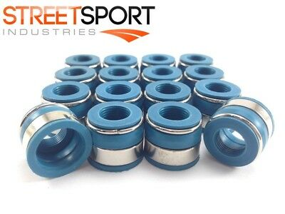

    If you install non- umbrella type seals similar to the ones in the picture, be sure you do a valve movement check to insure that the spring retainer does not contact the seal and that the valve springs clear the seal. Don't want any contact with the retainer, and not all non-umbrella seals are the same. SBC-BBC-SBF-VITON-Positive-Valve-Stem-Seals.jpg

  15. Those are not umbrellas,,,,,
    Those are a type of Viton seal,,,,,and the guide o.d. Has to be cut to the correct size for fitment.
    And it is usually a good idea to go ahead and cut the guide height down a little while you are there for good measure .
