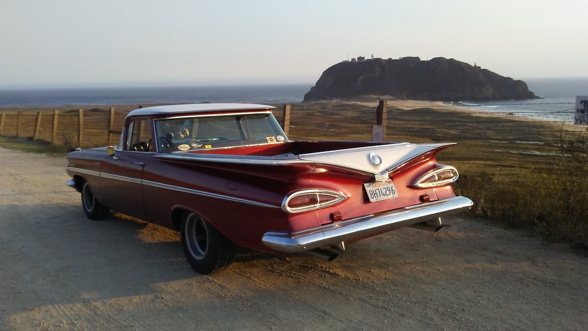

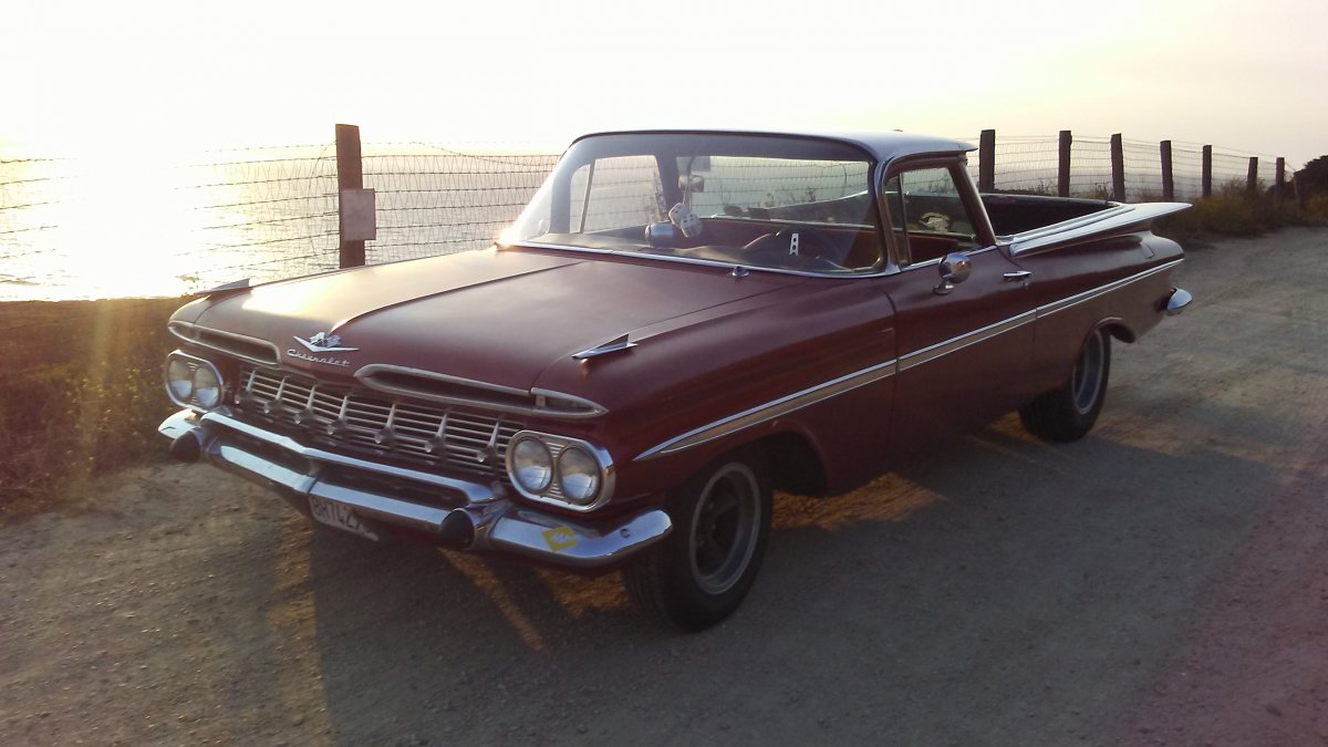

    20180811_191257.jpg 20180811_191229.jpg 20180811_191257.jpg you can bet if the springs are original, they are shot. I replaced the springs in my 59 ElCamino with stock Wagon/Elcamino rear springs, and Big block/ ElCamino/wagon front springs(forgive me, I don't remember what they were listed as exactly)all readily available. I cut 1 coil off the fronts, and left the rear stock. It sits a bit high. I bought monroes for the front, but they were junk, and now have bilstiens which made a big difference. Next for me are front and rear sway bars.
