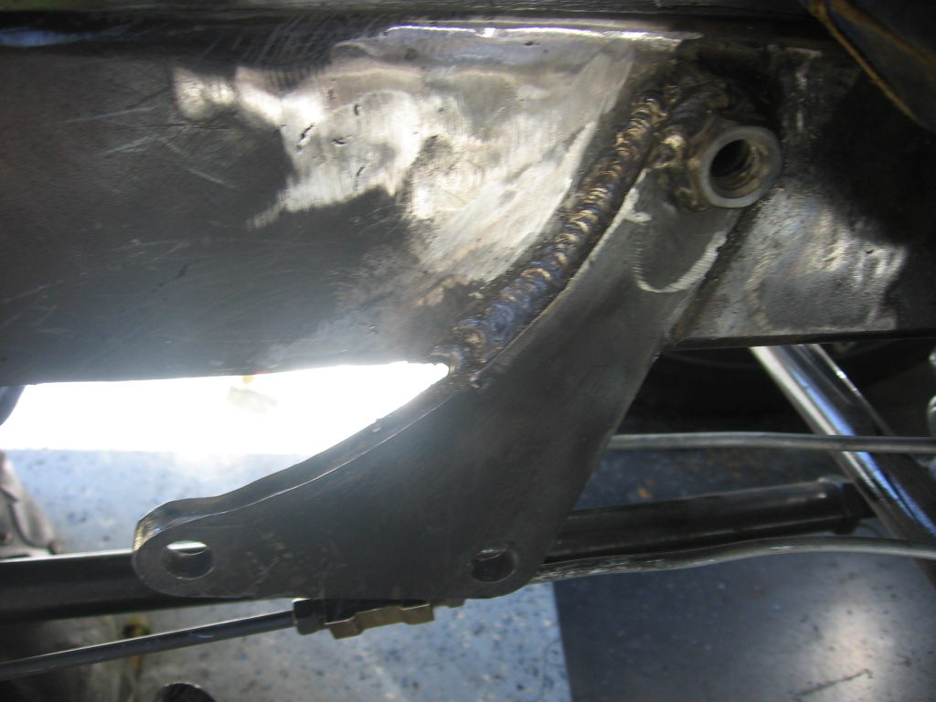

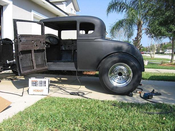

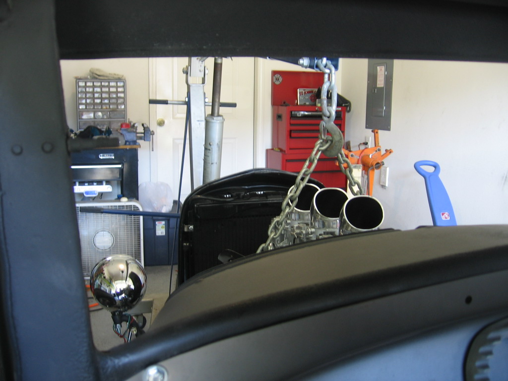

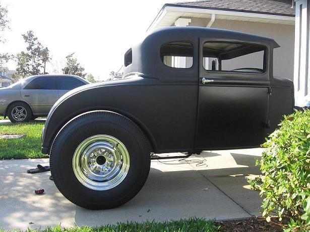

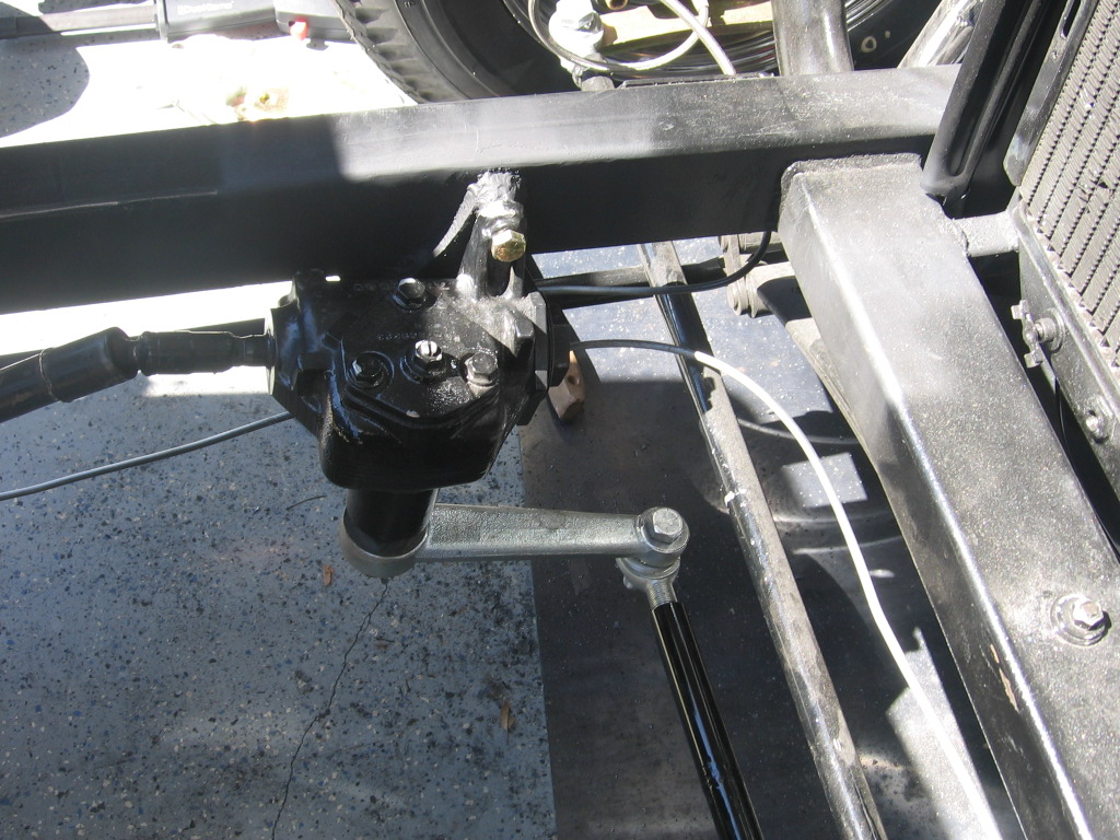

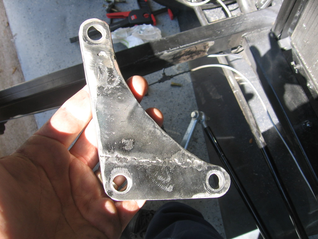

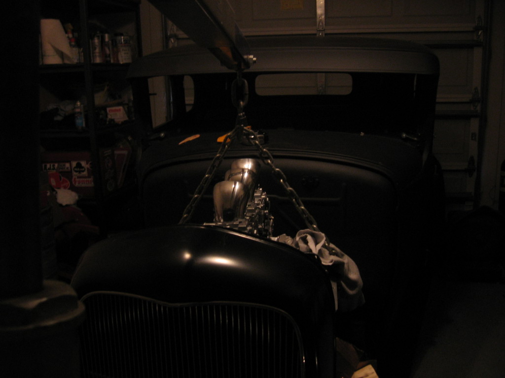

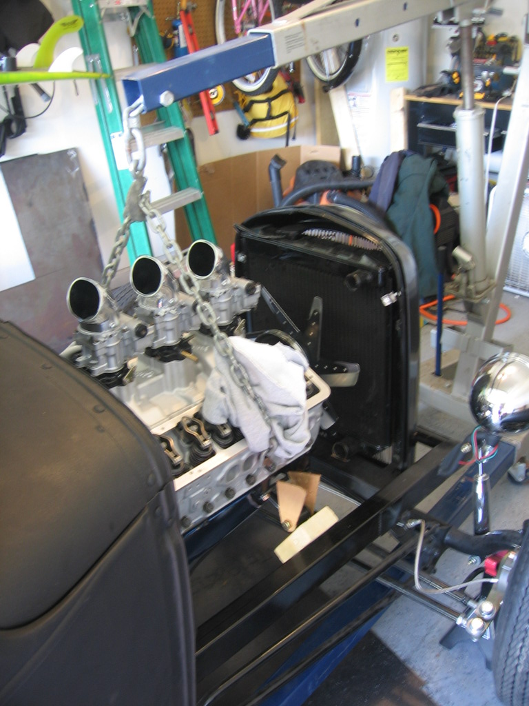

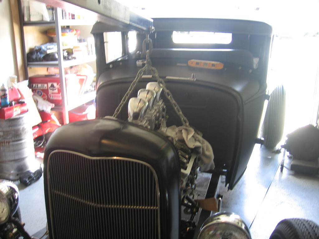

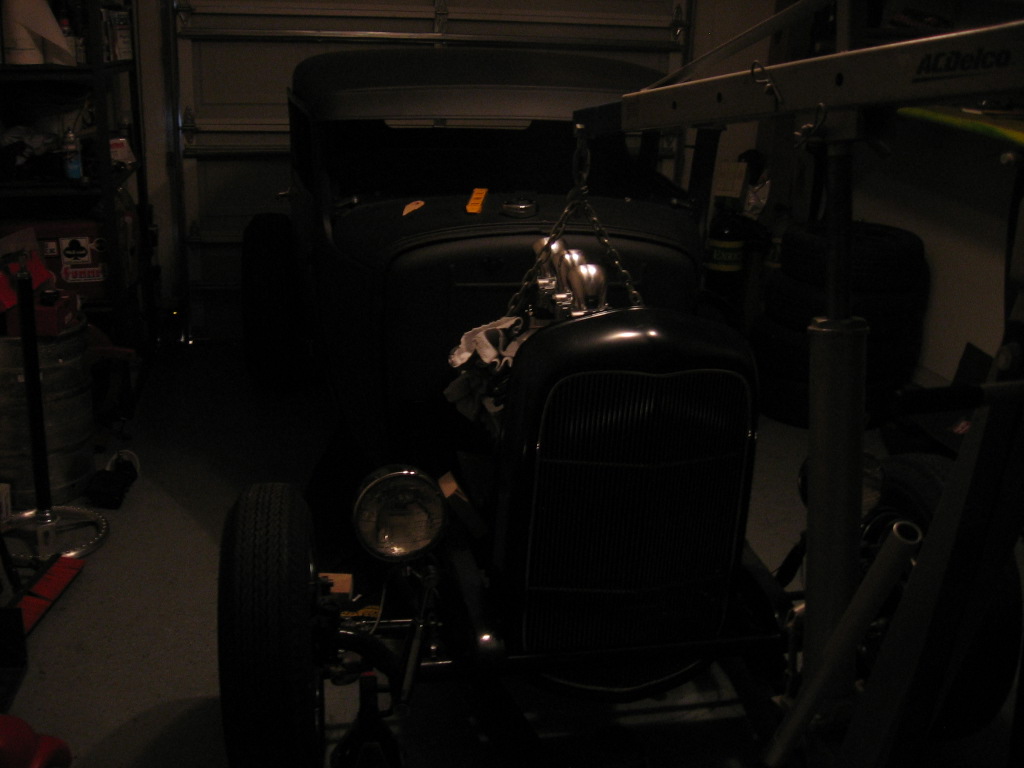

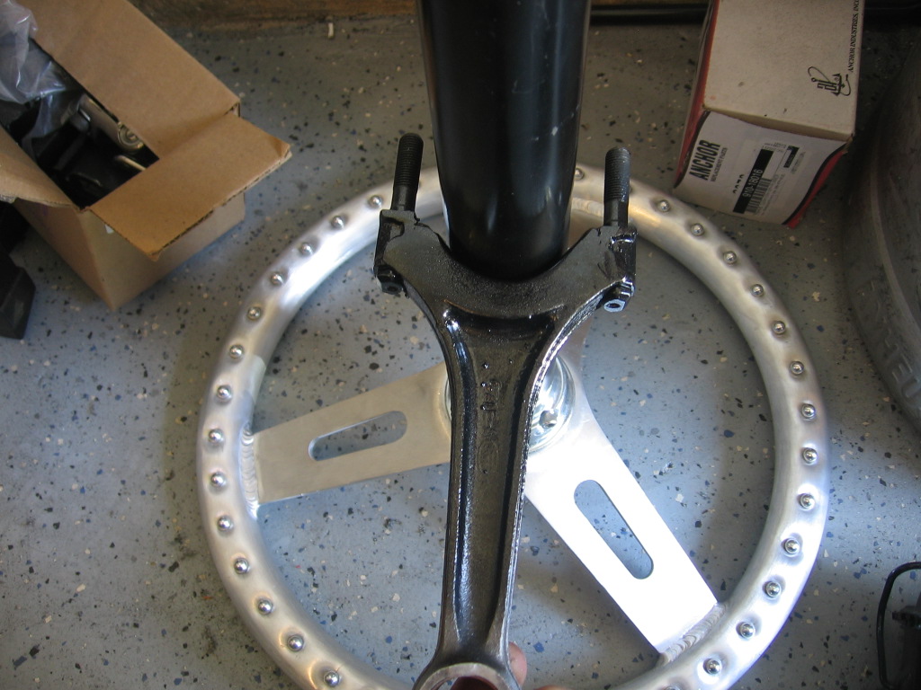

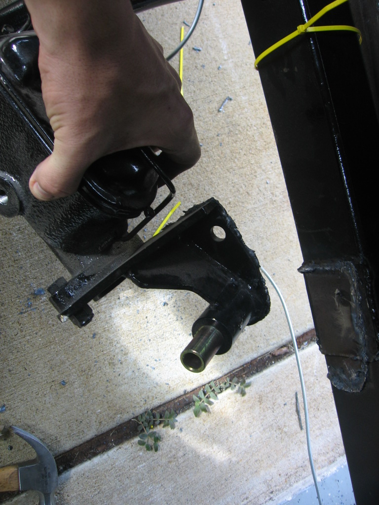

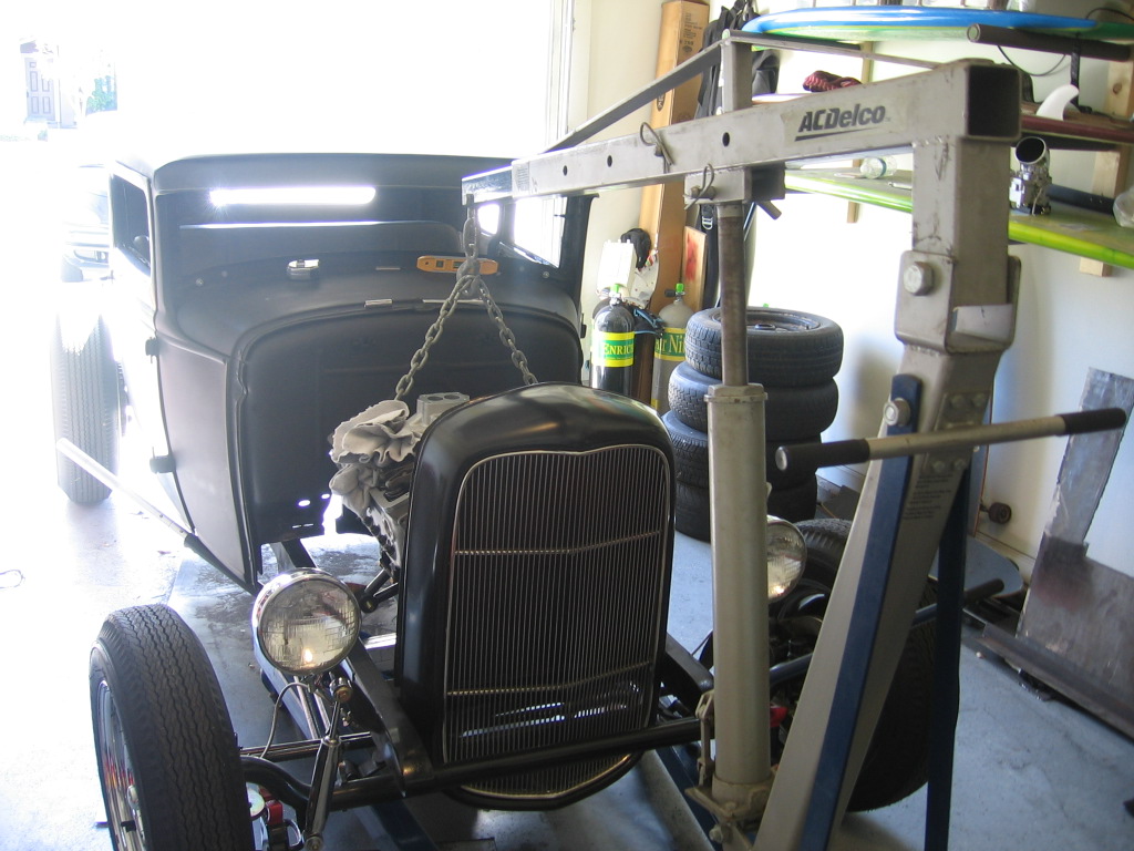

    Well I didnt get my motor mounts welded in today being that I only had 1 set of hands and my pops was out of town tending to my sick gma. BUT I did......
    finish modifying a ford v8 rod to fit my column (3 pieces of flat stock on the top and bottom hand bent, cut, welded, grinded to make the rod fit my column)
    Got my trans mount and brake booster cut off the frame (had to cut them off to move them being that my wheelbase is no longer that of a limo's)
    Got my vega moved forward, measured and all welded up with an extra reinforment
    Got the engine lowered in and measured up so when my pops gets back this week we can get the motor mounts cut and all welded up
    Its coming along despite the usual road bumps but overall for working this morning and early afternoon I got alot of work done today getting back into the groove of things....
