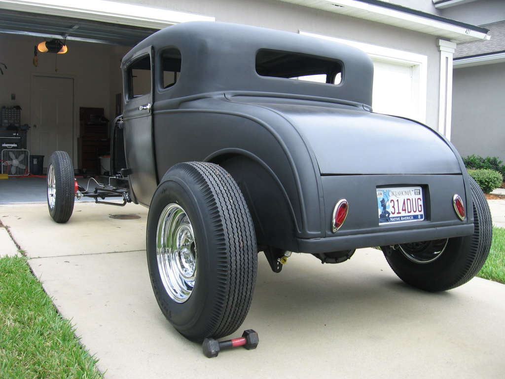

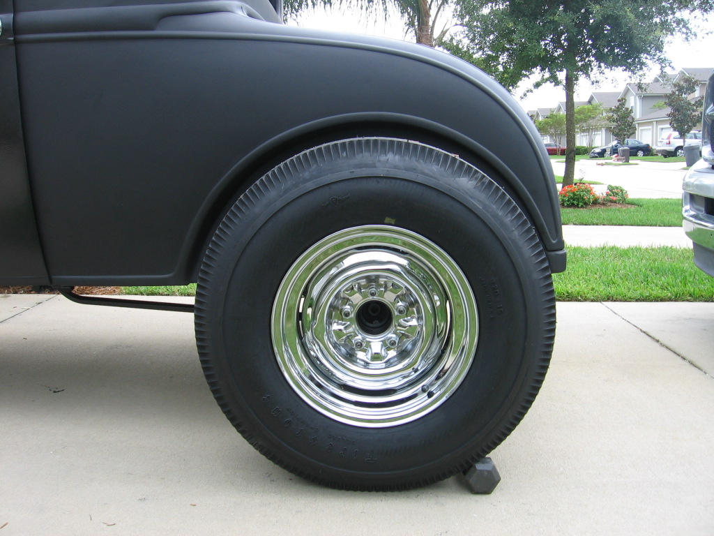

    Just got in from the garage today. Man was it hot....Got my rear suspension all finished now its totally adjustable so I can actually make use of the 8 inch Z that I have. Got the new lower coilover "adjustable" mounts welded on. Shocks are on the highest mount right now until I get my channel all fixed but the stance is ALOT better now!!! Still can go way lower. Whats the best way to cut the rear panel to give the rear end more clearance??? Got the body moved back another 1-2 inches to where it needs to be. Got all the measuring done for the steering. Long day in the garage was well worth it and my dad came over to lend a much needed hand...the littleman came out and helped alot too! Going to get metal for my floors and some "structural" reinforcement this week. When my pete and jakes front headlight/shock mount combo and chrome shocks come in I will get started on that. Got alot of work done today....

    Man, that stance is PERFECT...****, I wouldn't change a thing...
    Once you put a motor up front, and some weight on that spring...hell yeah!
    Hot Rod Rake...

    is it just me, or does the car look a lil long? maybe just cuz the engine bay is vacant?

    Looks long...Mine was stretched 6"...no recess on the firewall for clearance. I wonder if this is also?

    What is the stock frame length? I was told this frame was to stock specs length wise. I think ALOT of it has to do with the fact that there is no drivetrain at all......I love the new stance..I still have to bring the body up a couple inches to even out the channel and then drop the rear suspension to make up for it. It will look good when its done. Also the grill shell is just there for mock up its not mounted at all so dont gig me on how high its sitting

    stock length is 103 in wheel base

    Stock for a Model A is 104, you look like you got about 6 extra. No big deal. As long as you like it who cares.

    Engine bay looks long to me...
    What is the measurement from the firewall to the grill shell on a model A?
